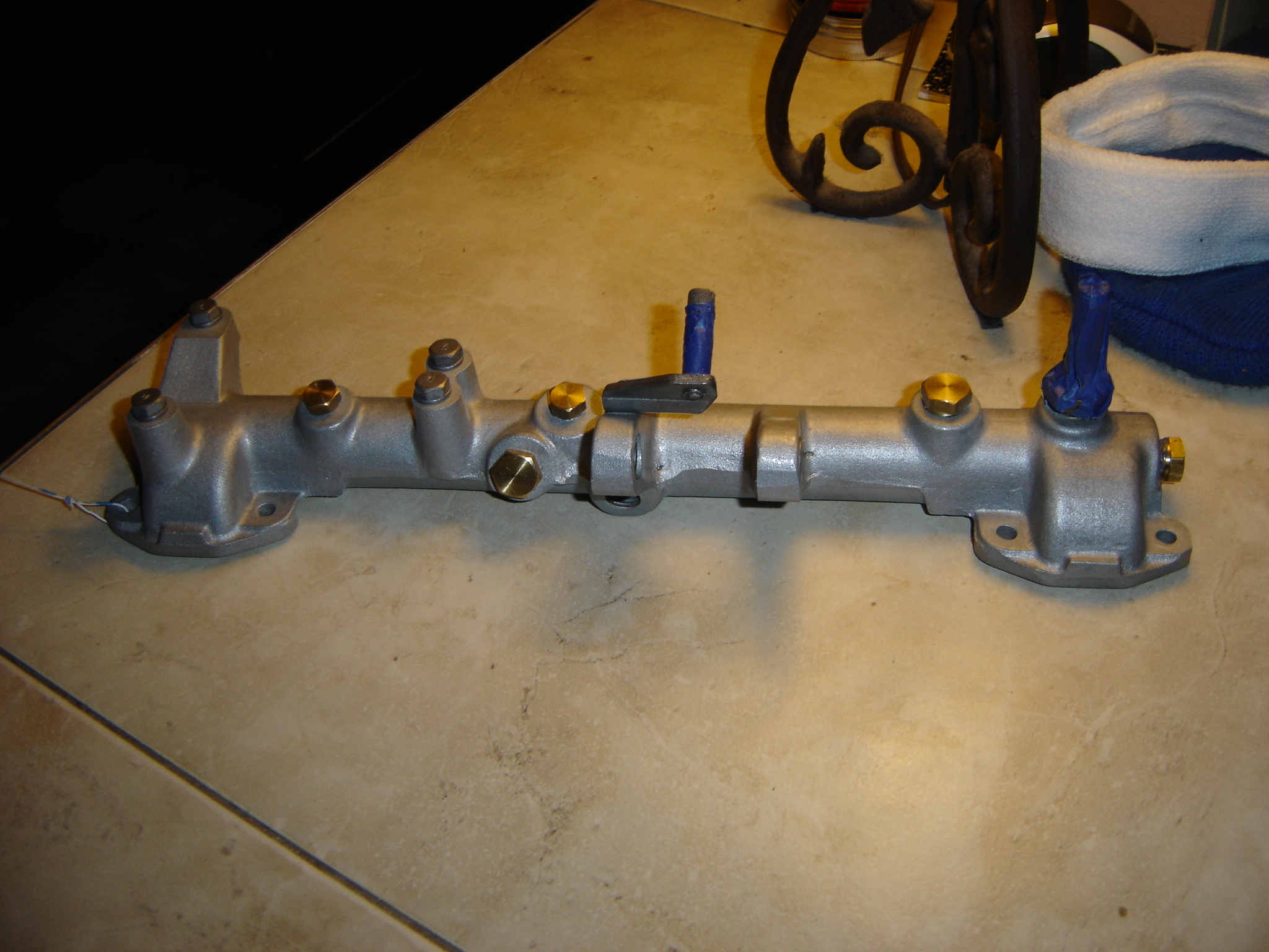

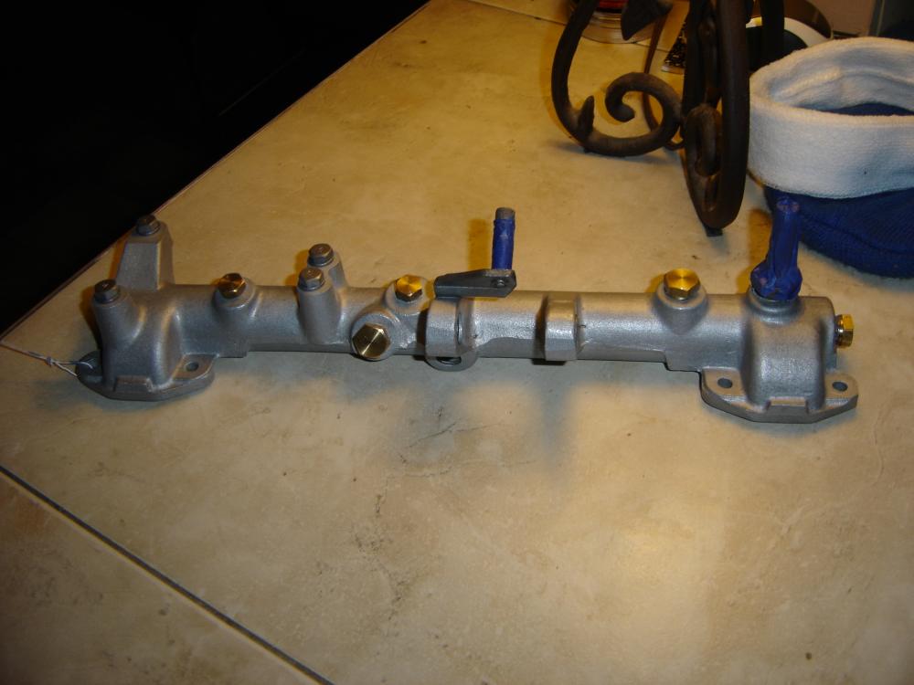

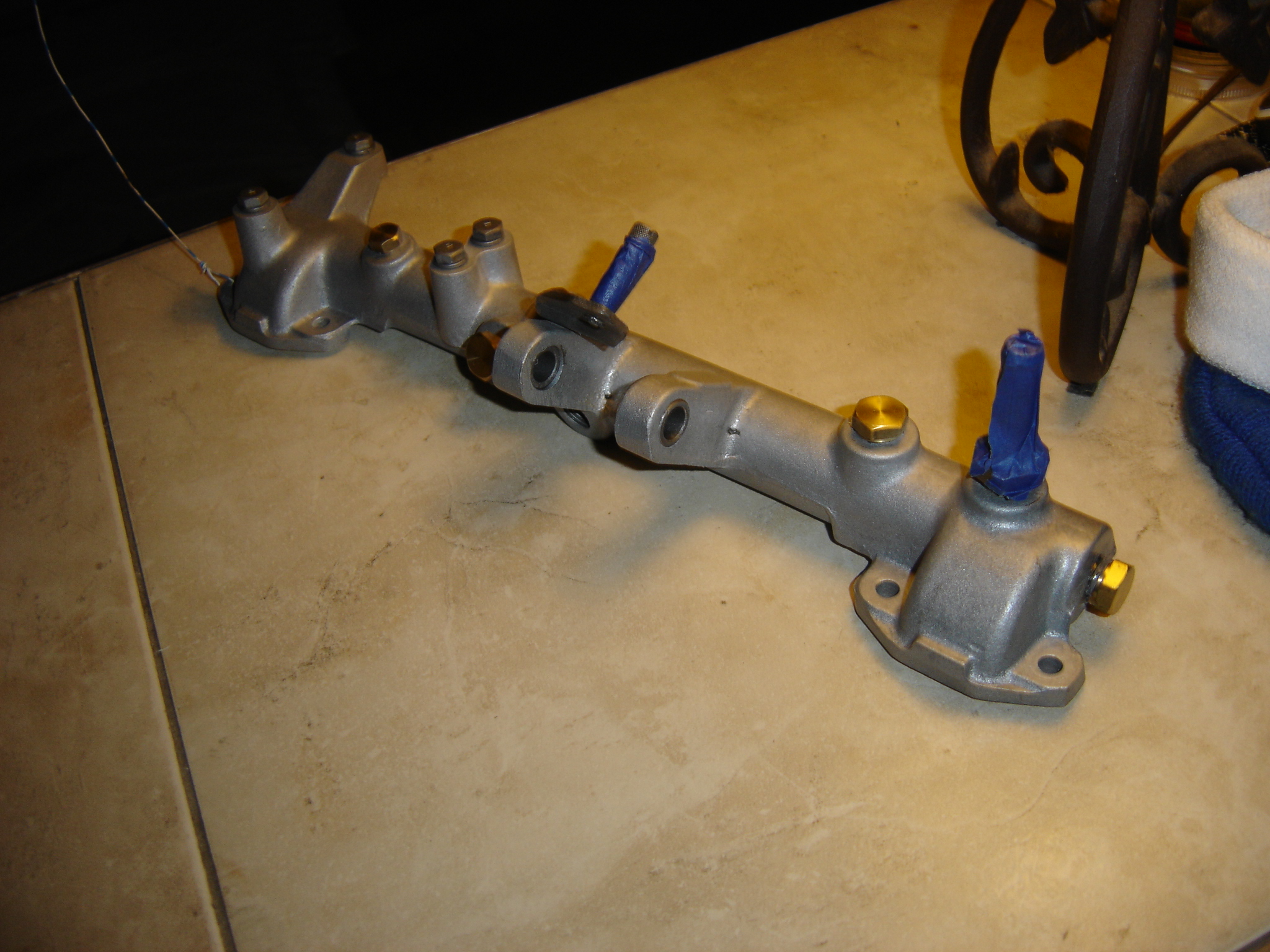

Can you quickly confirm the plug sizes and QTY's for your balance tube plugs for the smog delete? I want to pick a few up but i'm not 100% certain which ones I need.  Thx
I've got the invoice at home. I can let you know for sure tomorrow.
I went with what Bruce P from ztherepy said and used NPT plugs from fastenal, my local nuts and bolt store. One eighths inch I believe, 1 on the front side and two or three up top. They'll screw in with a little force, tefon tap helps.
I wished I'd tried those black flush mounting set screws. I used them plugging my a/c compressor holes and they look good against the blue of the block. Who knows against the aluminum?
Okay I was a little off earlier.  Mine has two 1/8 NPT plugs on the top left and three 1/4 NPT plugs, 1 on the top right, 1 in the front and another on the right side end.

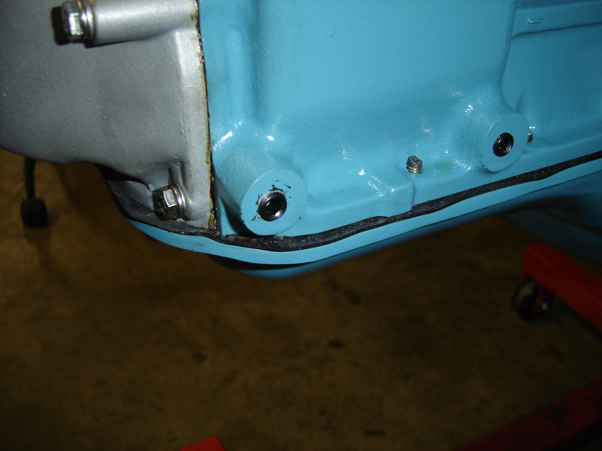

Then I decided this oil pan gasket doesn't look too good.  Does anybody elses stick out like this?  It's a Nissan gasket, bolts are nice and tight done gradually to allow for the squashing they do.

I don't like the looks of the oil pan gasket either.

I've got another oil pan gasket and am just looking for a reason to repaint the pan black, you've tipped the scale for me! They are supposed to be black, right?
Thanks Captain.
