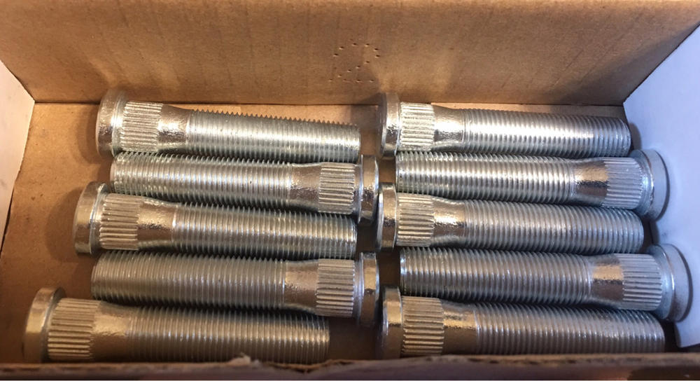

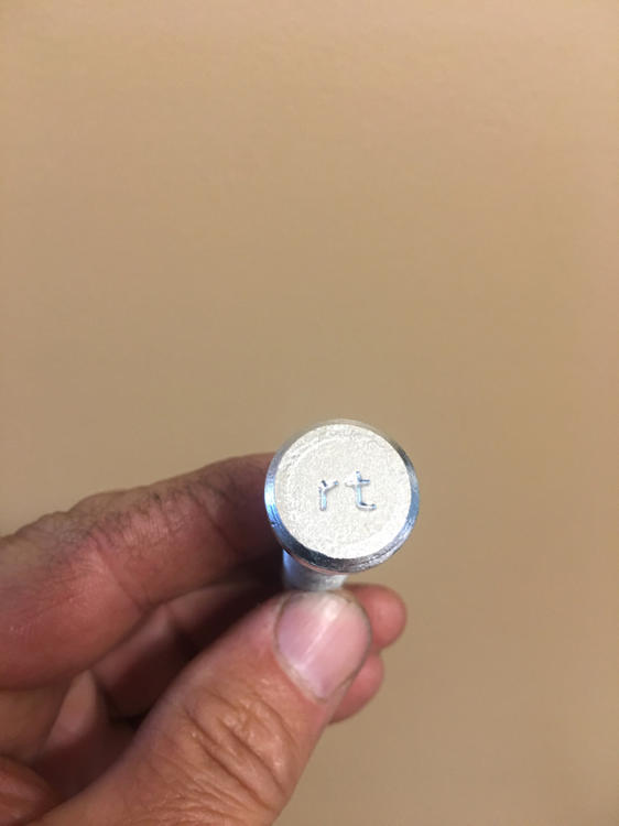

Well finally! The RT Trackpro 60mm M12x1.25 12.8mm knurled studs have arrived.
They must be manufacturing these as they have their stamp on the heads. No one else seems to have custom lengths and knurl sizes like these guys.

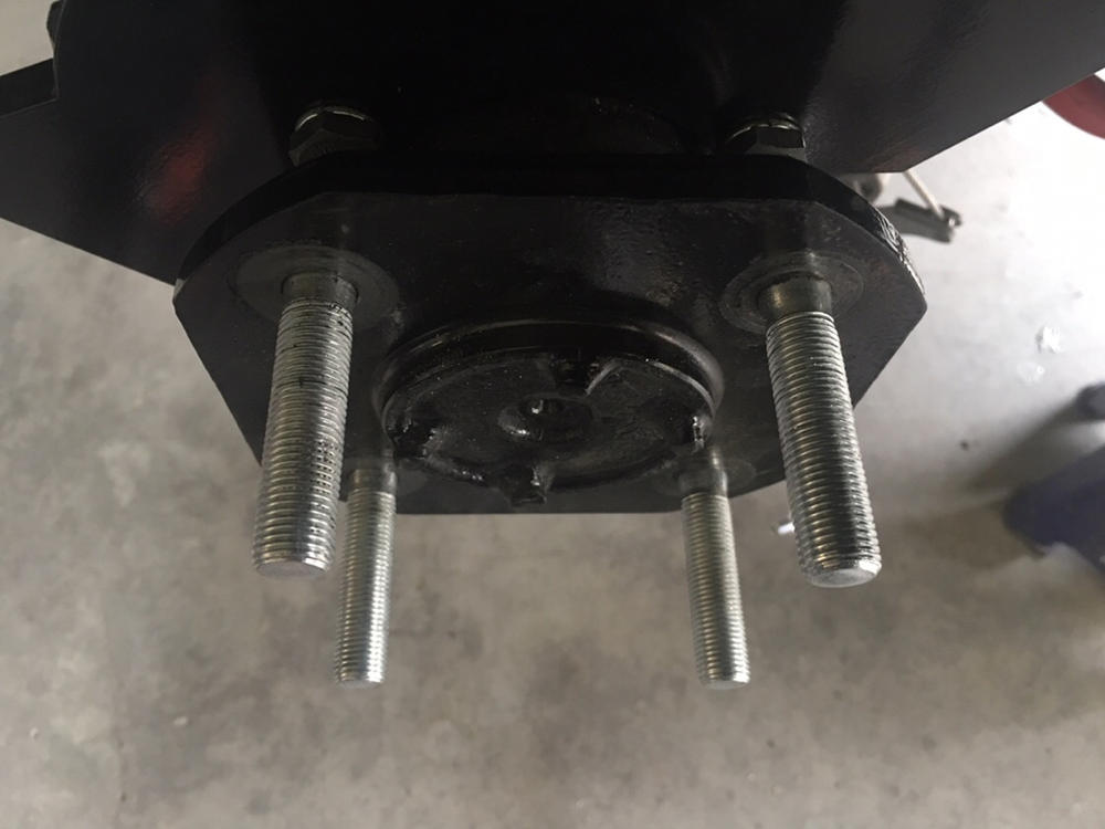

The key to this stud replacement was getting a slightly larger knurl to bite into the hubs better. 12.7mm stock and I ordered the 12.8~12.9mm knurl studs.

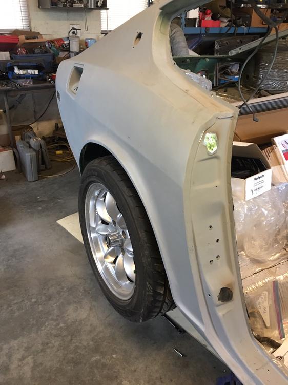

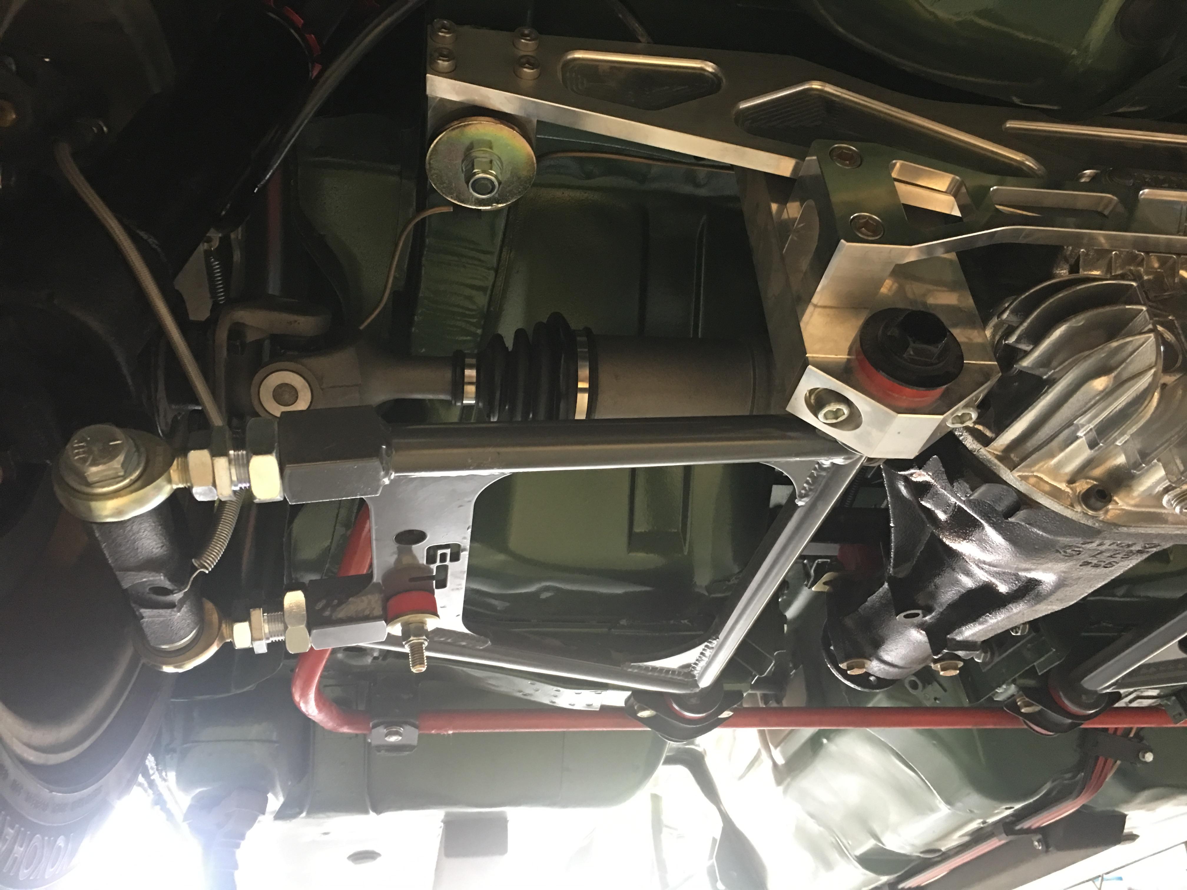

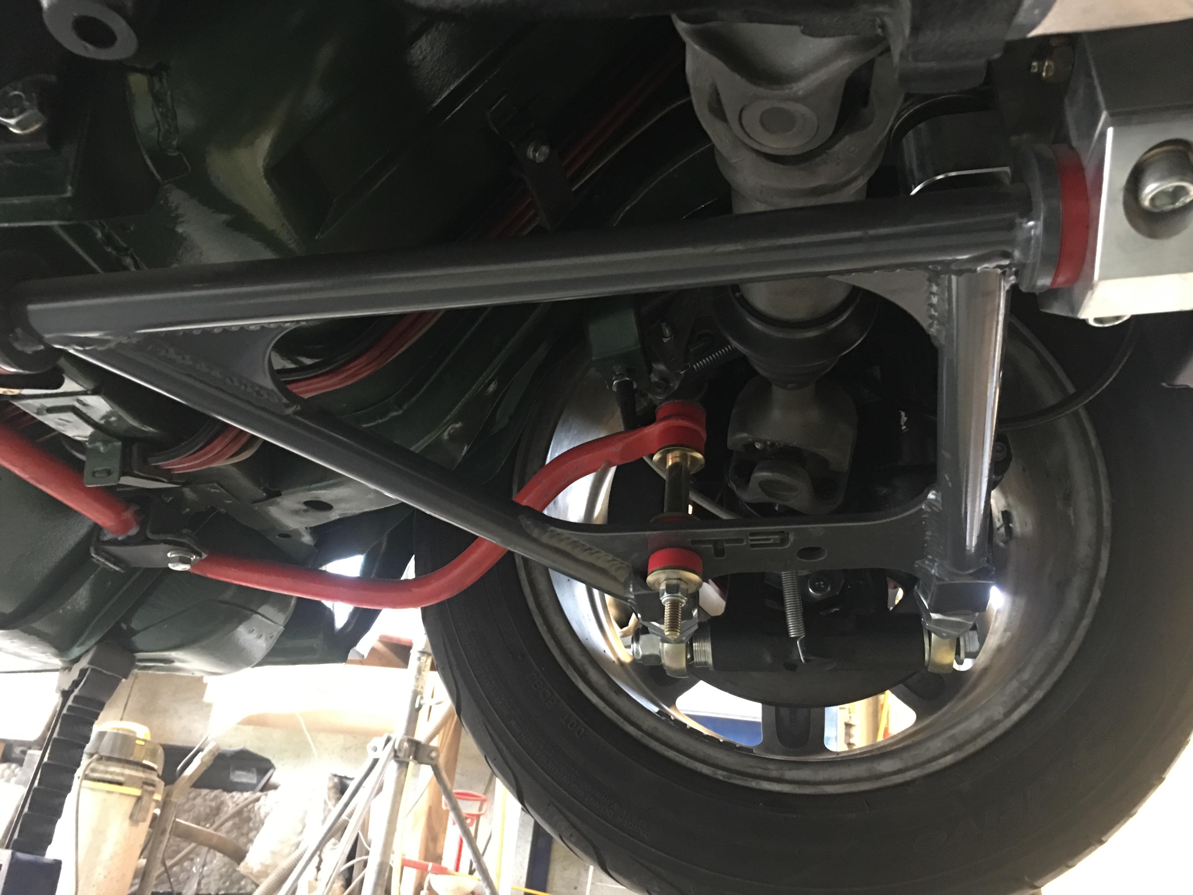

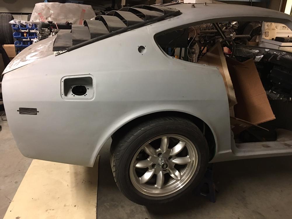

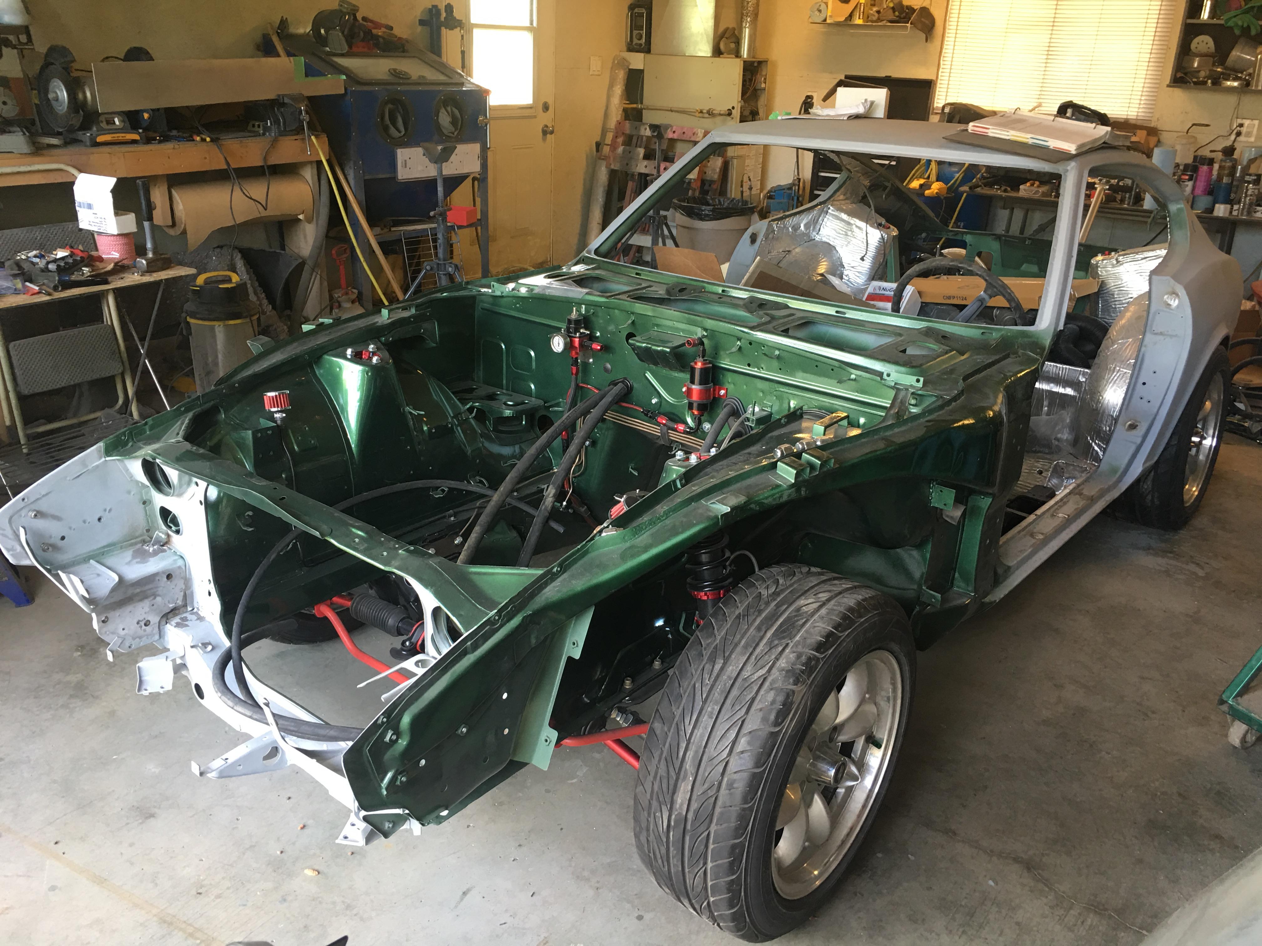

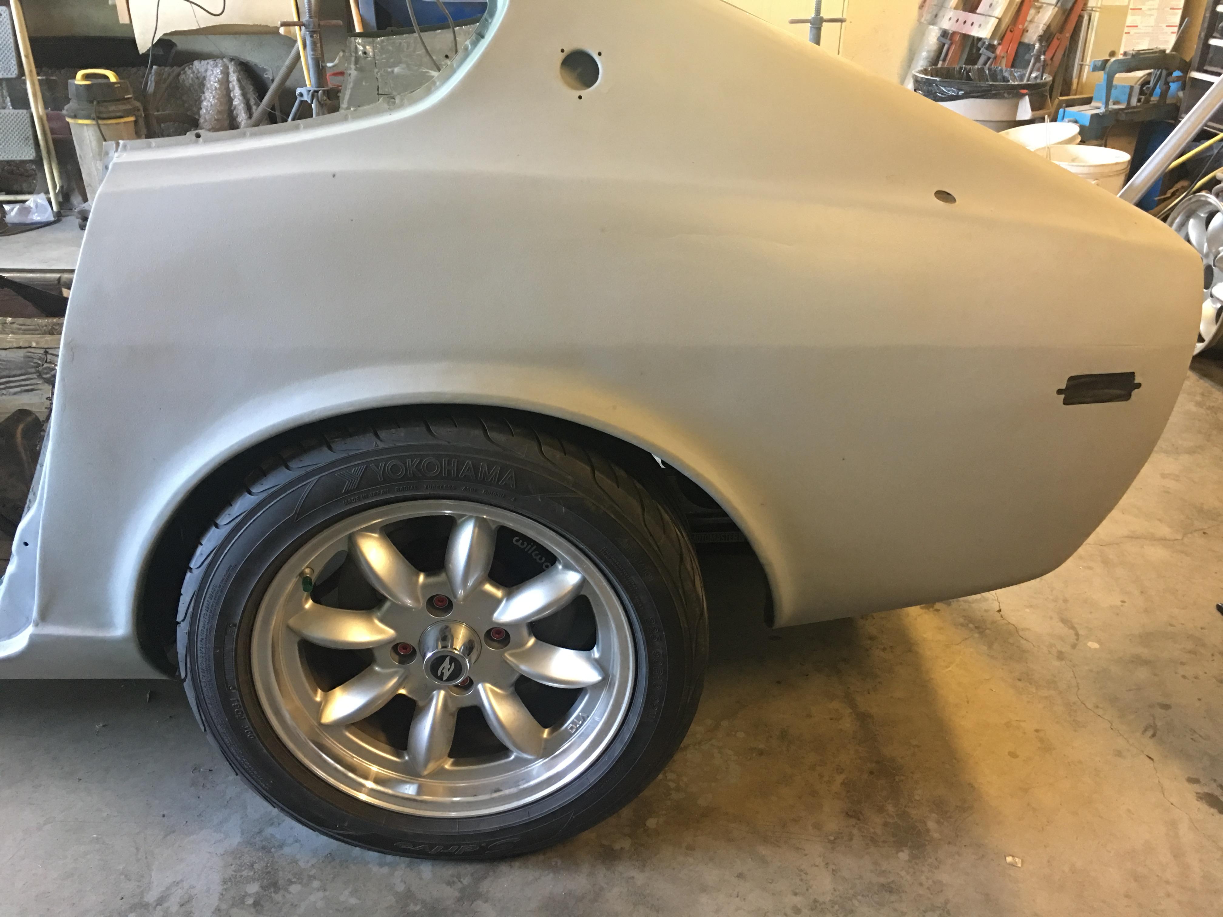

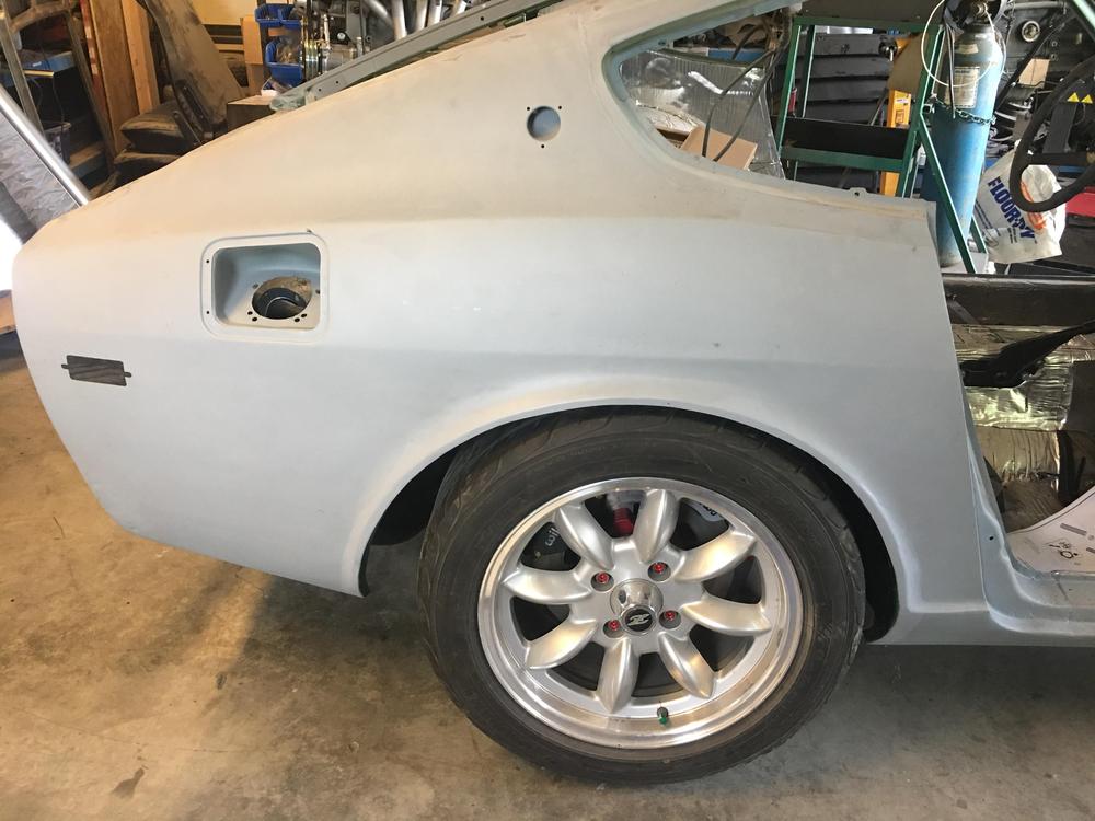

The TTT lower control arms are awesome. They allowed me to adjust the toe, camber and track width of the rear wheels. When I first mounted the wheels, they seemed to sit too far forward in the wells. I moved the spacers to the front of the arms, and the wheels moved back into the centre of the wells.
In order to tuck the wheels in under the fenders, I widened the track setting and pushed the wheels out at the bottom. This also created the right amount of camber I needed. Front and rear adjustments also provide all the toe adjustments you need. Very impressed.

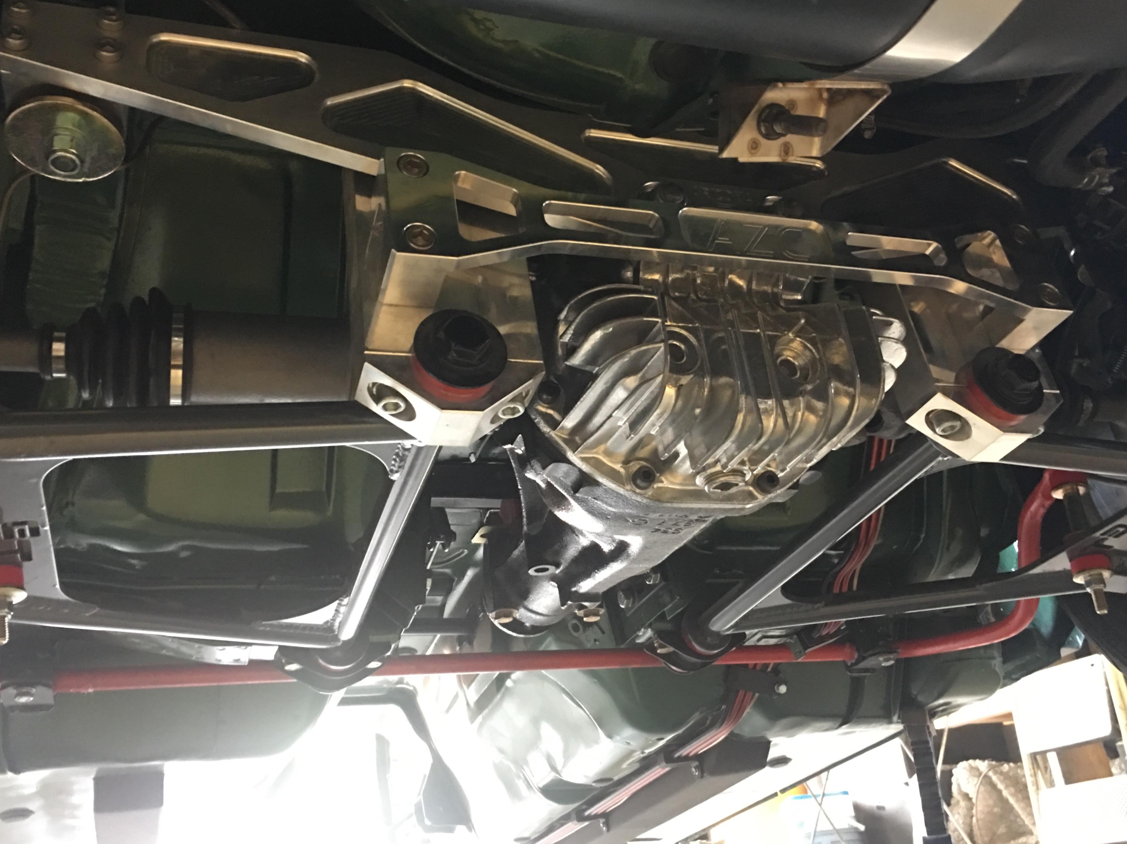

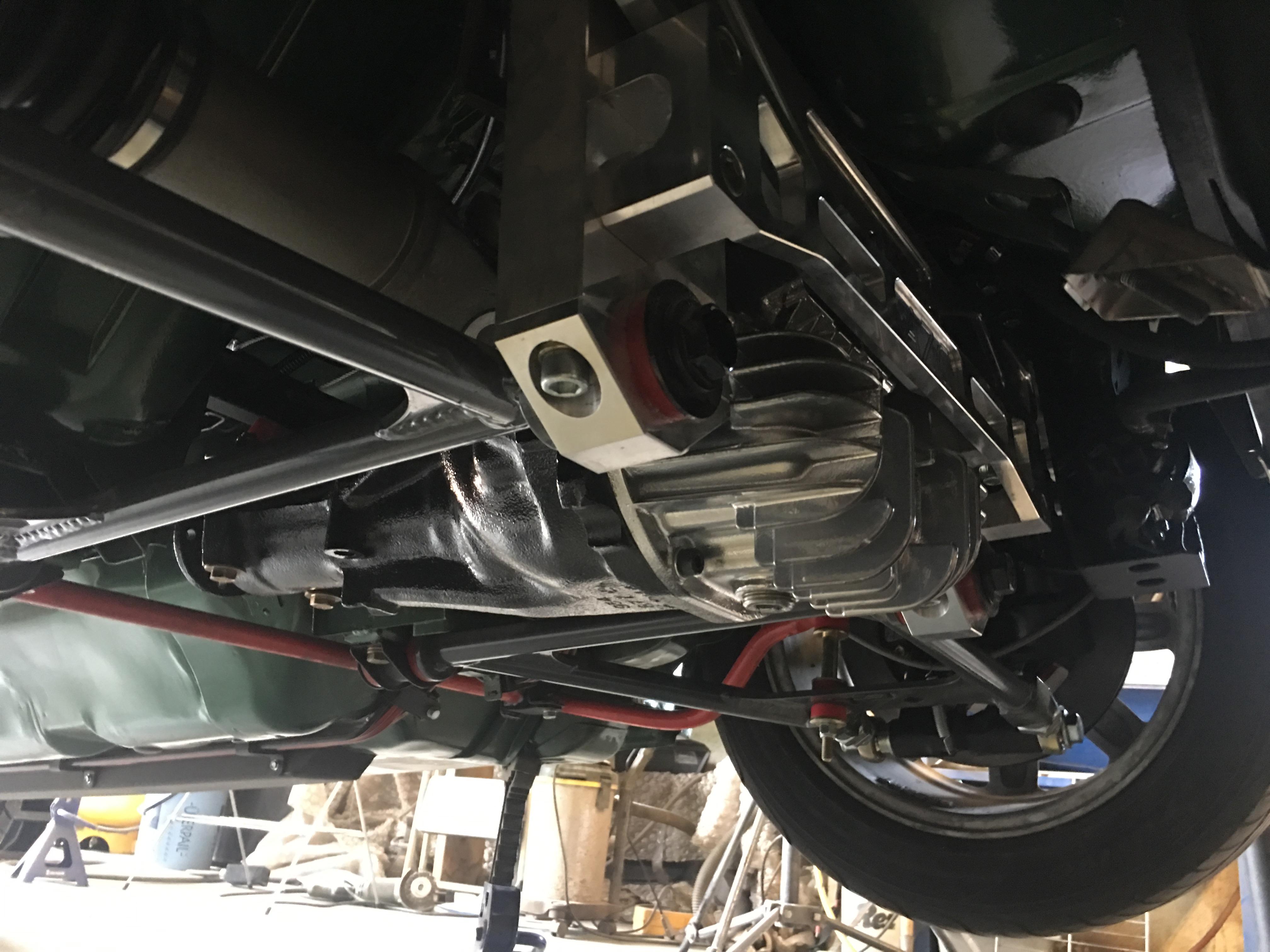

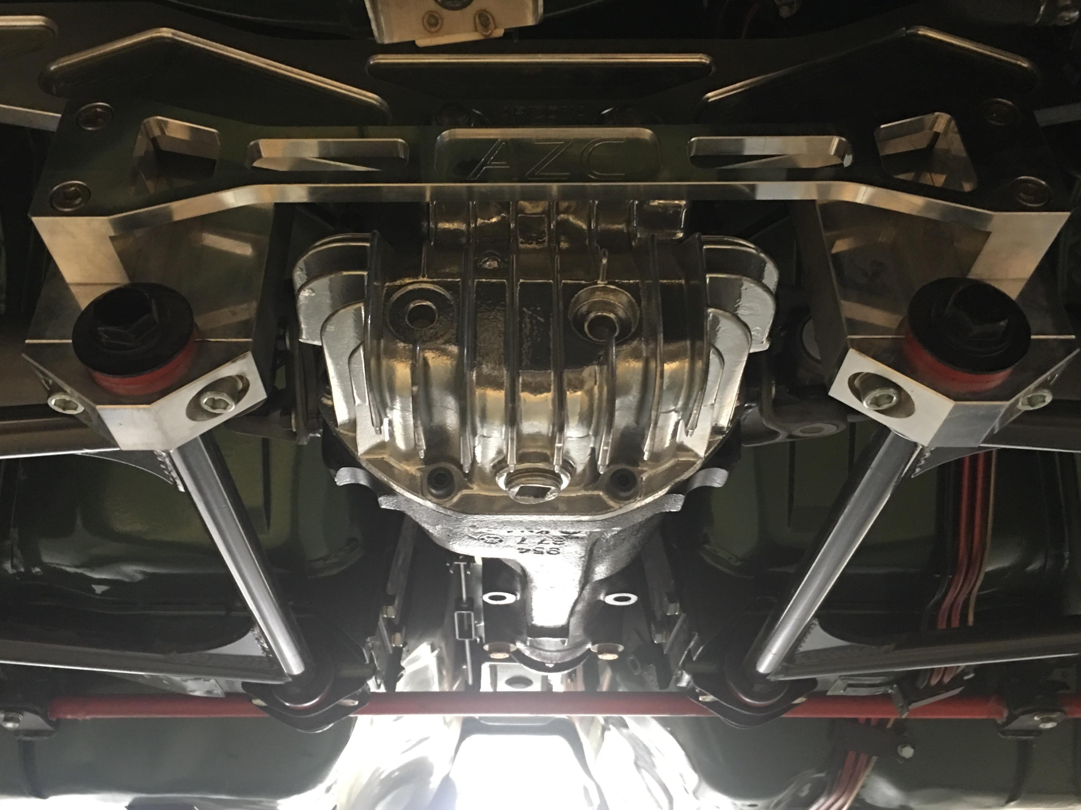

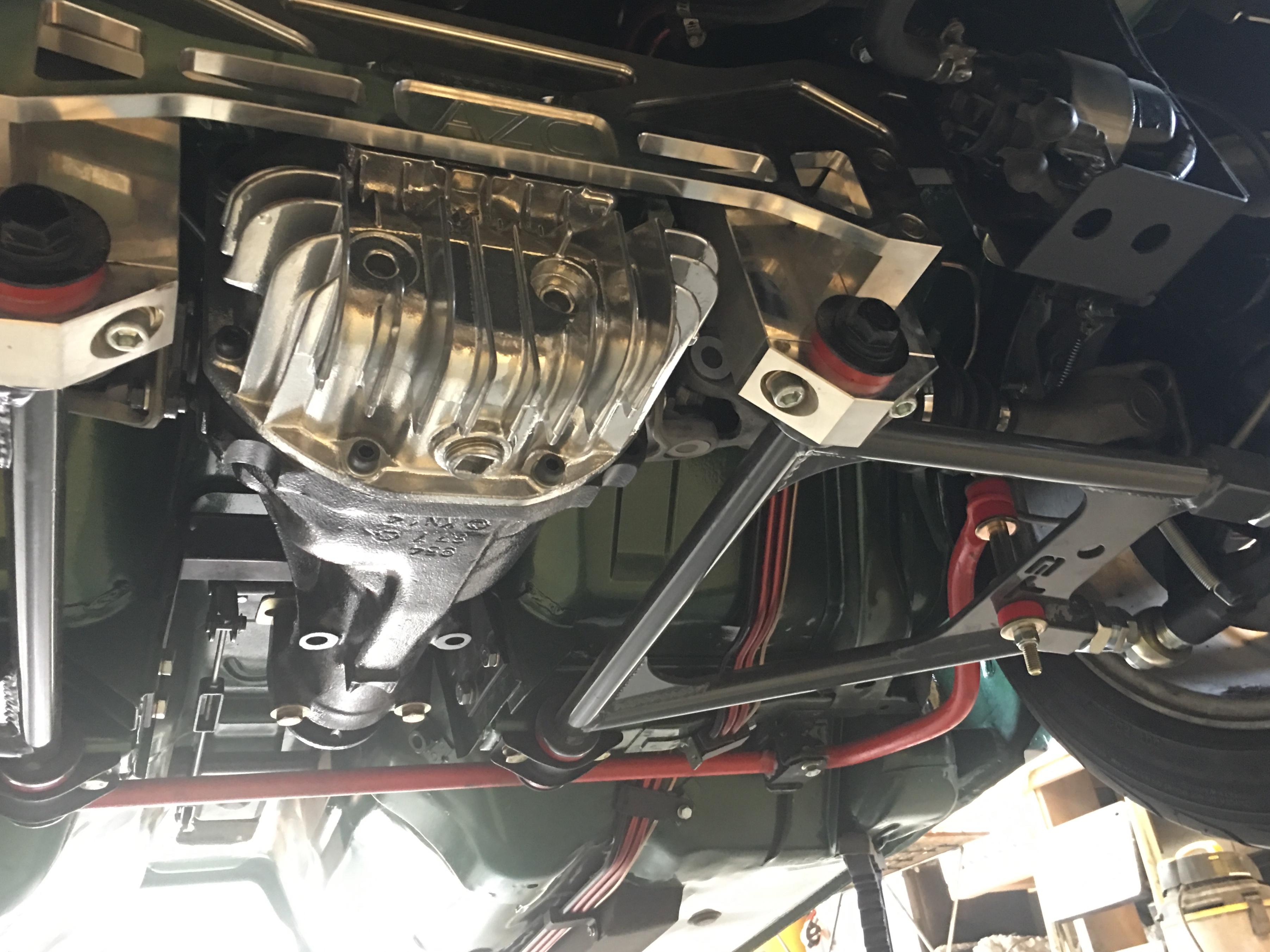

Well today is a milestone. The car is finally sitting on all four wheels with brakes attached and parking brake working!
Some final shots after I filled the diff and greased the U joints.
