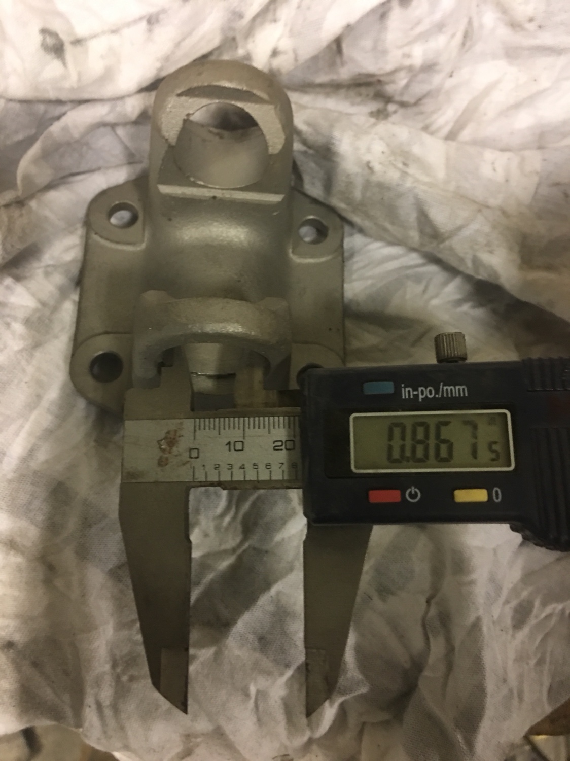

Cup diameter: 22mm
Distance between circlip outer edges: 35.7mm (standard circlips)
@wheee! Mark, If your uni's are stuffed, can you dismantle one and take some accurate measurements?
I have some other part numbers with slightly wider/narrower dimensions.

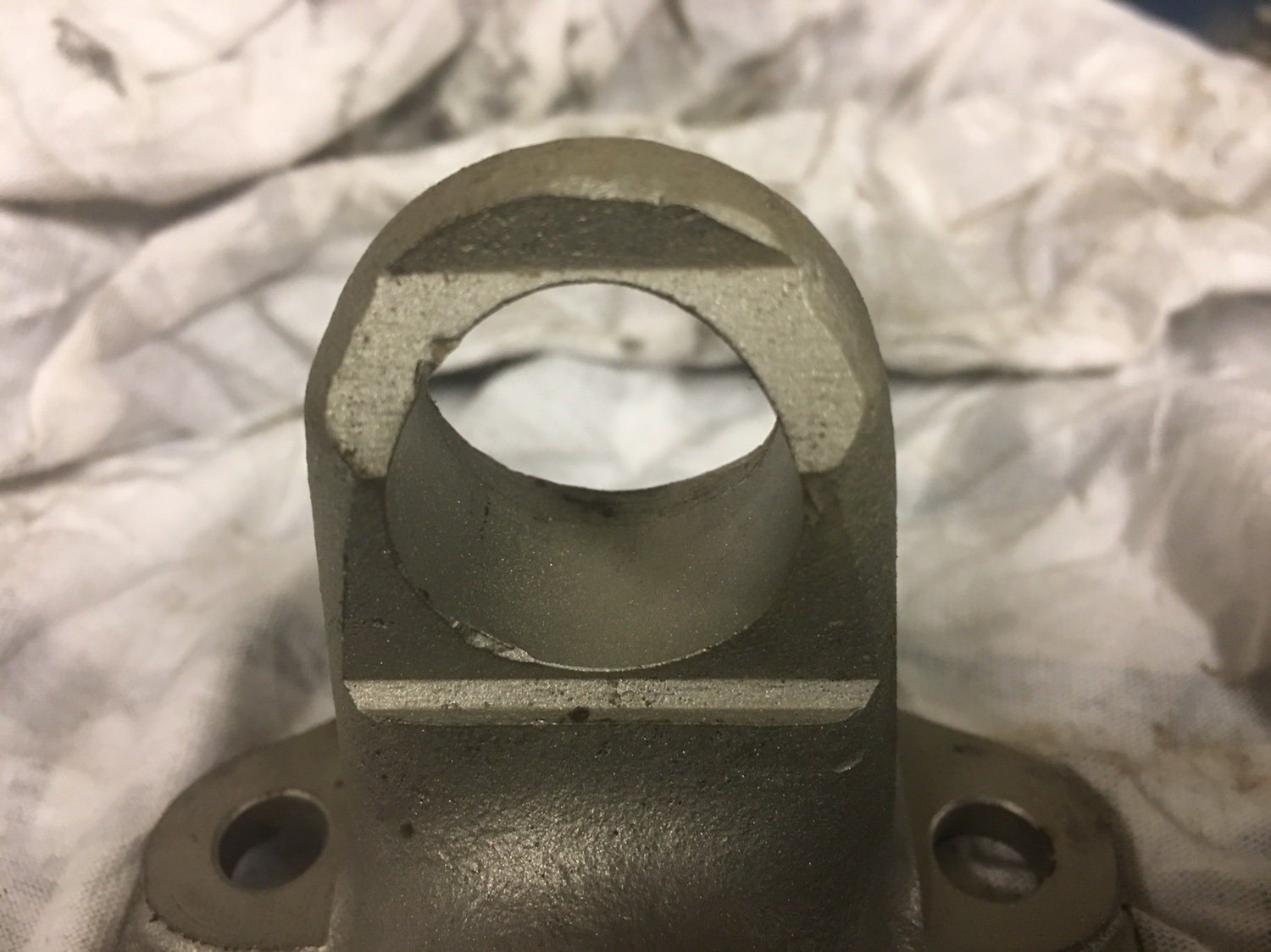

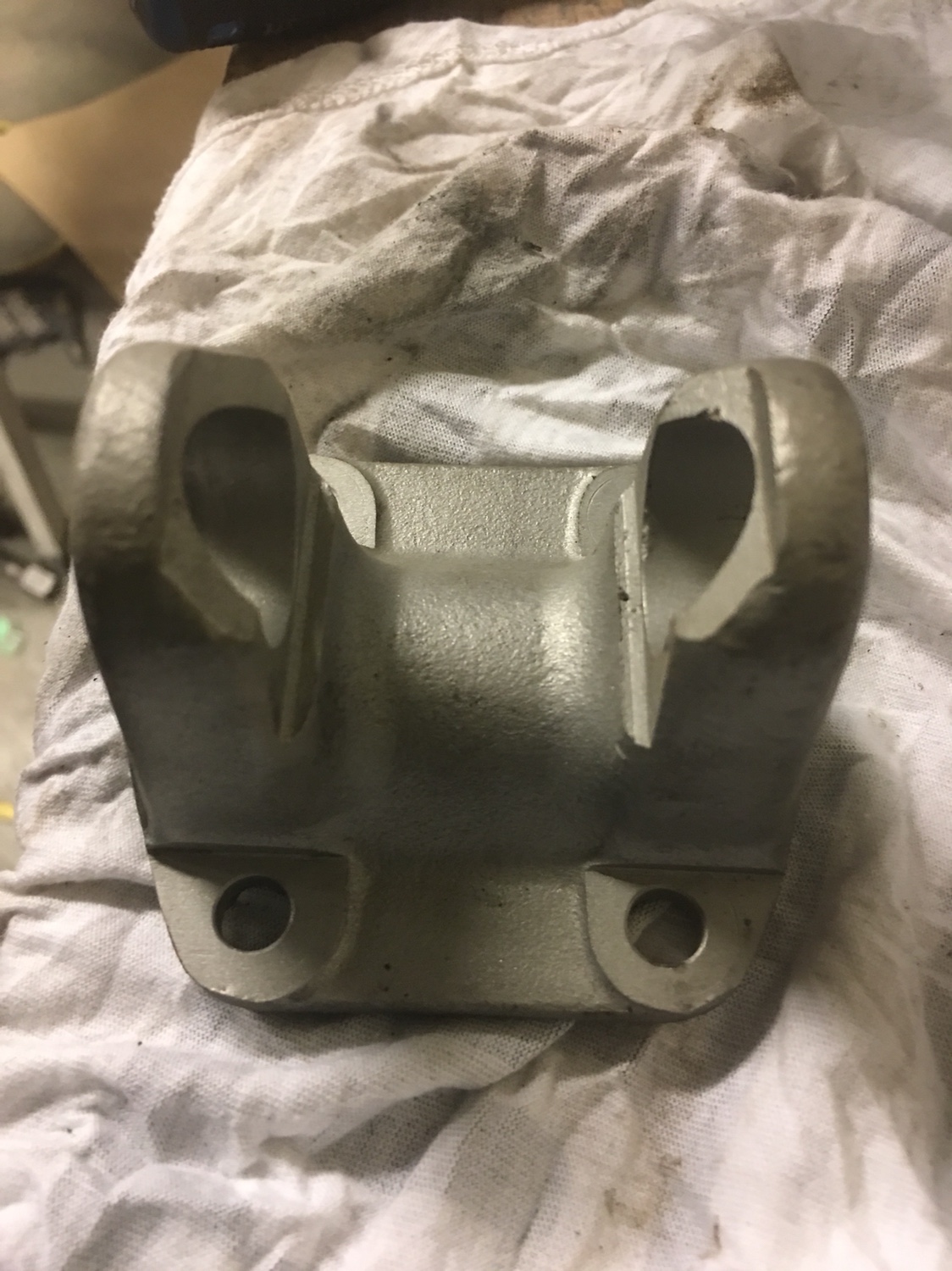

I will press out the old u joints and take some measurements. It looks like the 430-10 Rockwell's are the ones I see listed as fitting. (according to Rockwell)

They write like replacing a staked-in joint is a common thing.  I have seen kits for other brands of cars, that come with a little grinding/cutting tool that cuts out the stake.  But if I recall correctly the yokes for those kits had a groove already in place, that was used for a circlip afterward.  Kind of like the manufacturer staked in a clipped u-joint for some reason.  Cut out the stakes and use the old clips.

Who knows, maybe Nissan ground the flats on the inside of the yoke for an internal clip, but then staked it in. Can't tell what kind of clips the 43-010 uses.

I won't have the bearings for awhile yet anyways. I will press out the old one regardless and get pics etc.

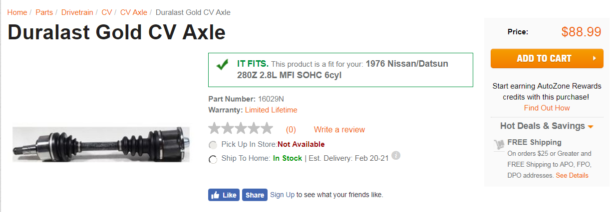

Just remembered some funny fit business with CV axles, from the past.  When I did a Google on it I found that it's actually gotten worse.  Used to be just a specialty axle house, now it's Autozone.
