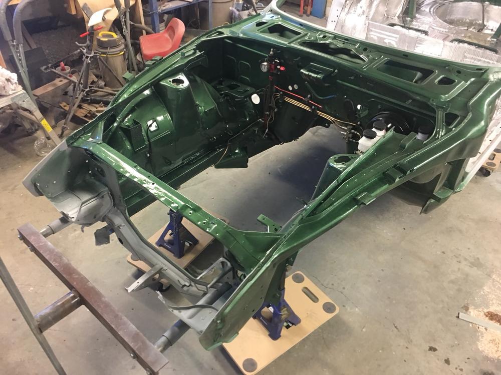

Well, after three years of spinning and stripping....

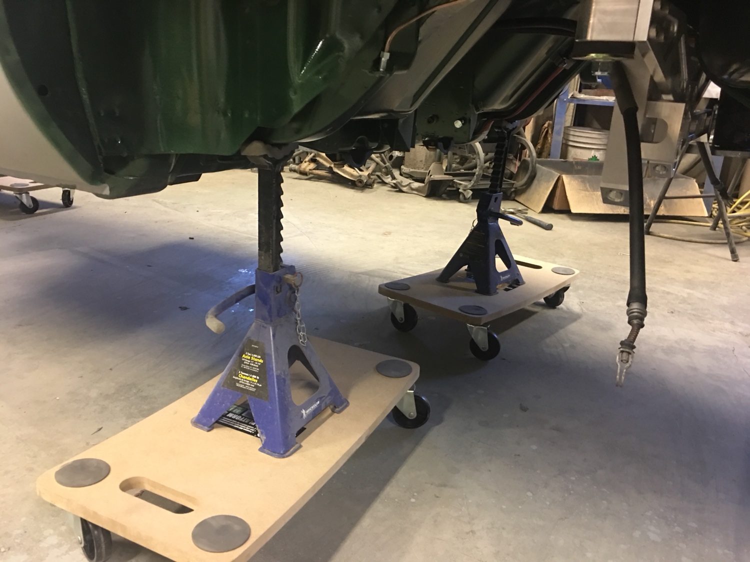

SASSZ is off the rotisserie!

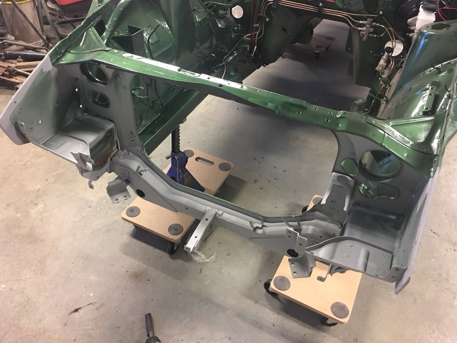

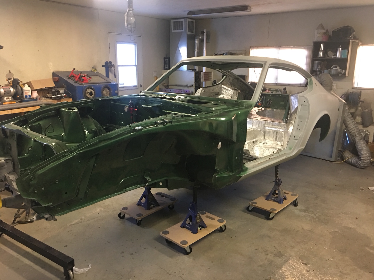

Now to figure out the best way to stabilize her and still be able to work on her/move her around...
VAPLEURER.png  You're not going to push it around like that are you? All that work.
I figure it will get great gas mileage like this and most of my car shows are close...
I will get it on solid suspension as soon as I can.

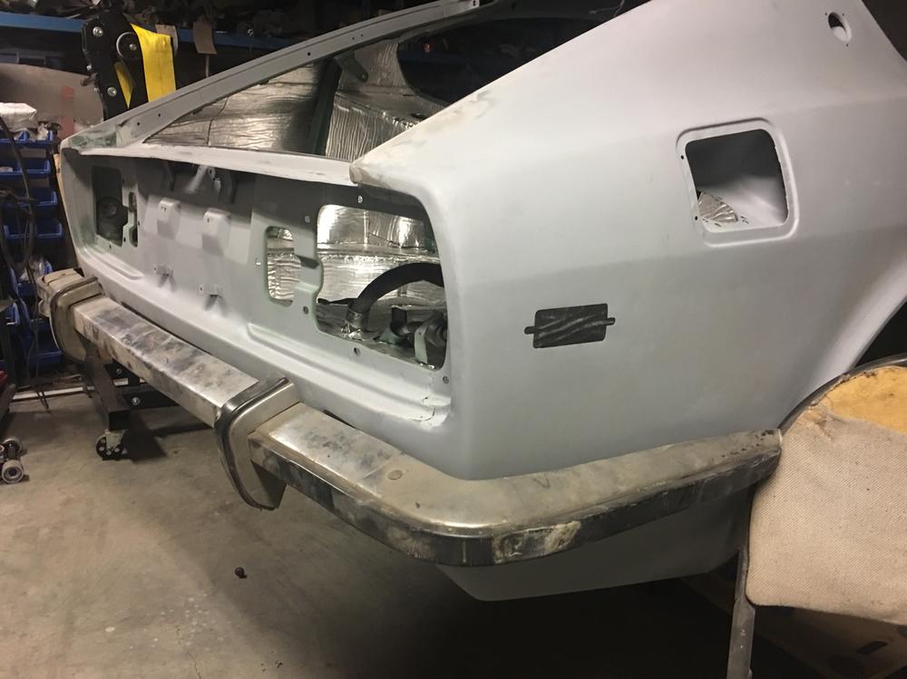

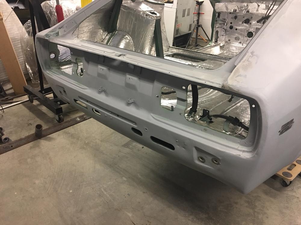

And now I can work around the rear bumper mounts too!

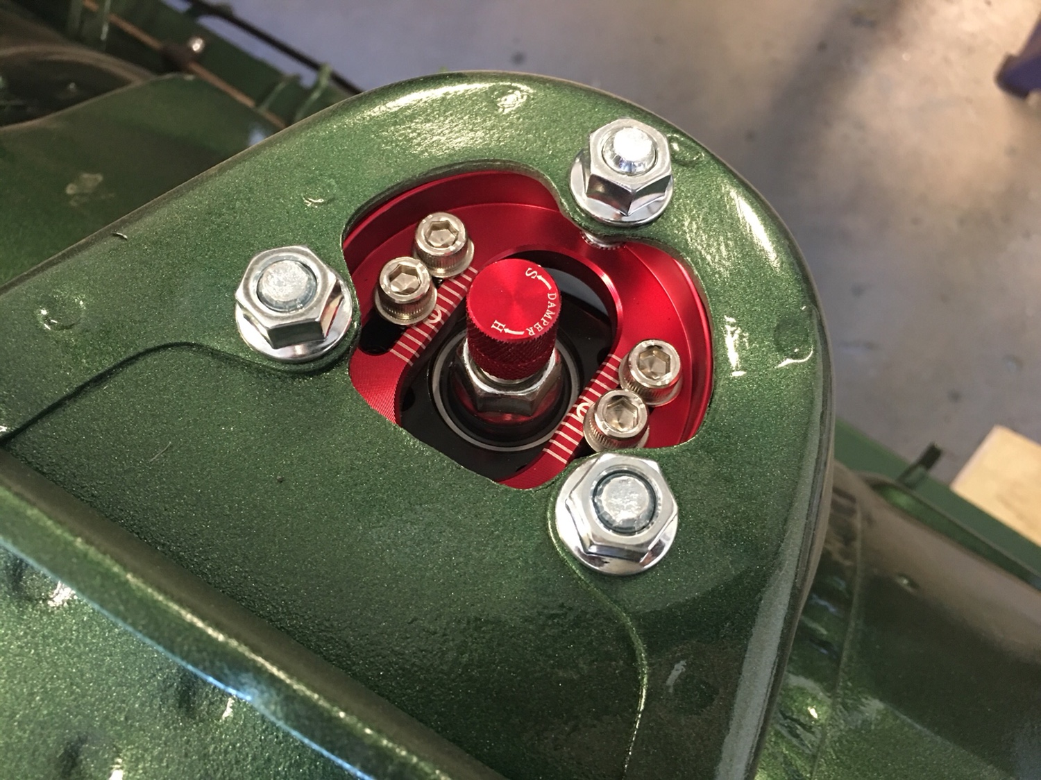

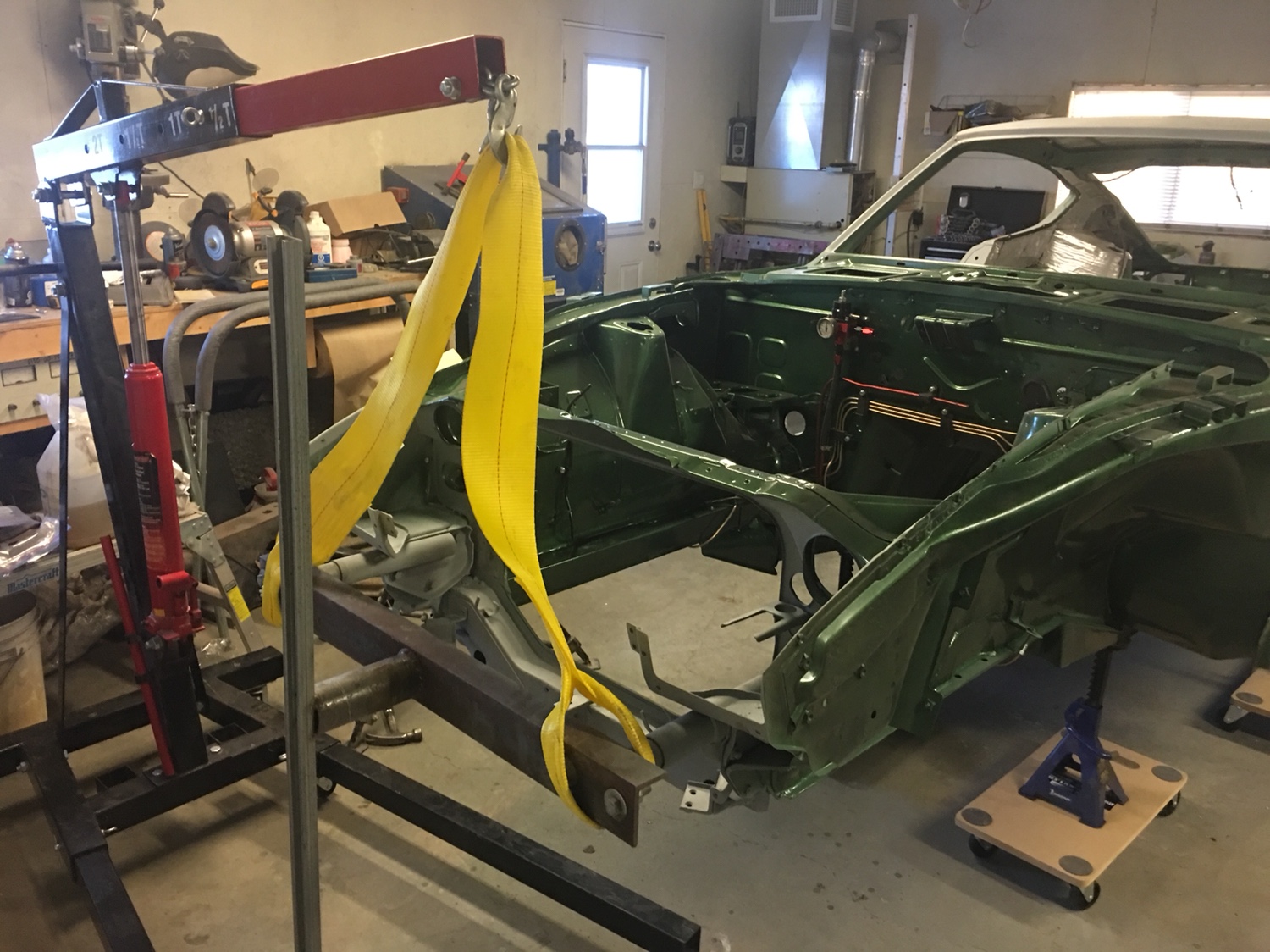

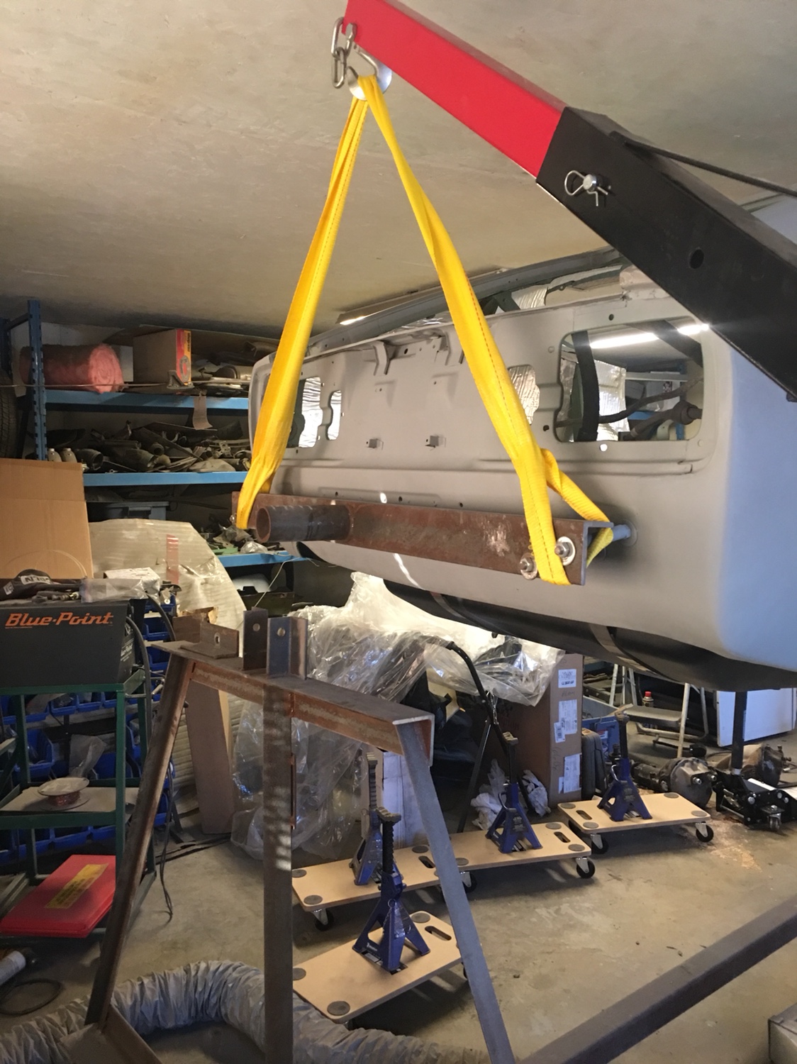

The reason for putting the car down now is because the car on the rotisserie would have been too heavy to remove after I installed all the suspension components. Now I can mount those and get the car on some work wheels.
