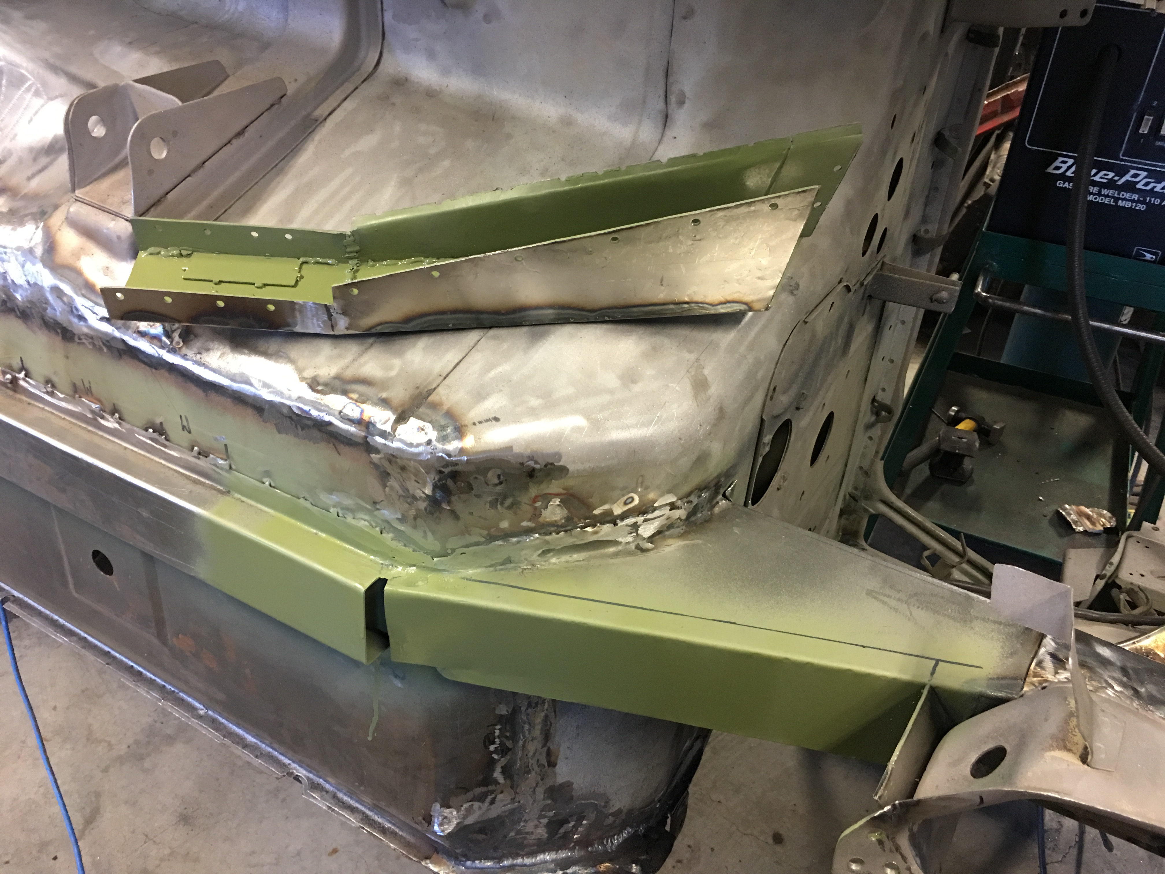

What is the process to coat the inside of all the cavities where you welded new metal?  I would think that is the most critical to get coated to prevent future rust.
Eastwood internal frame coat...
All the parts I built or welded up I coated with that stuff. Sprayed it into all the cavities I could. It's all in the thread if you have several hours to kill LOL

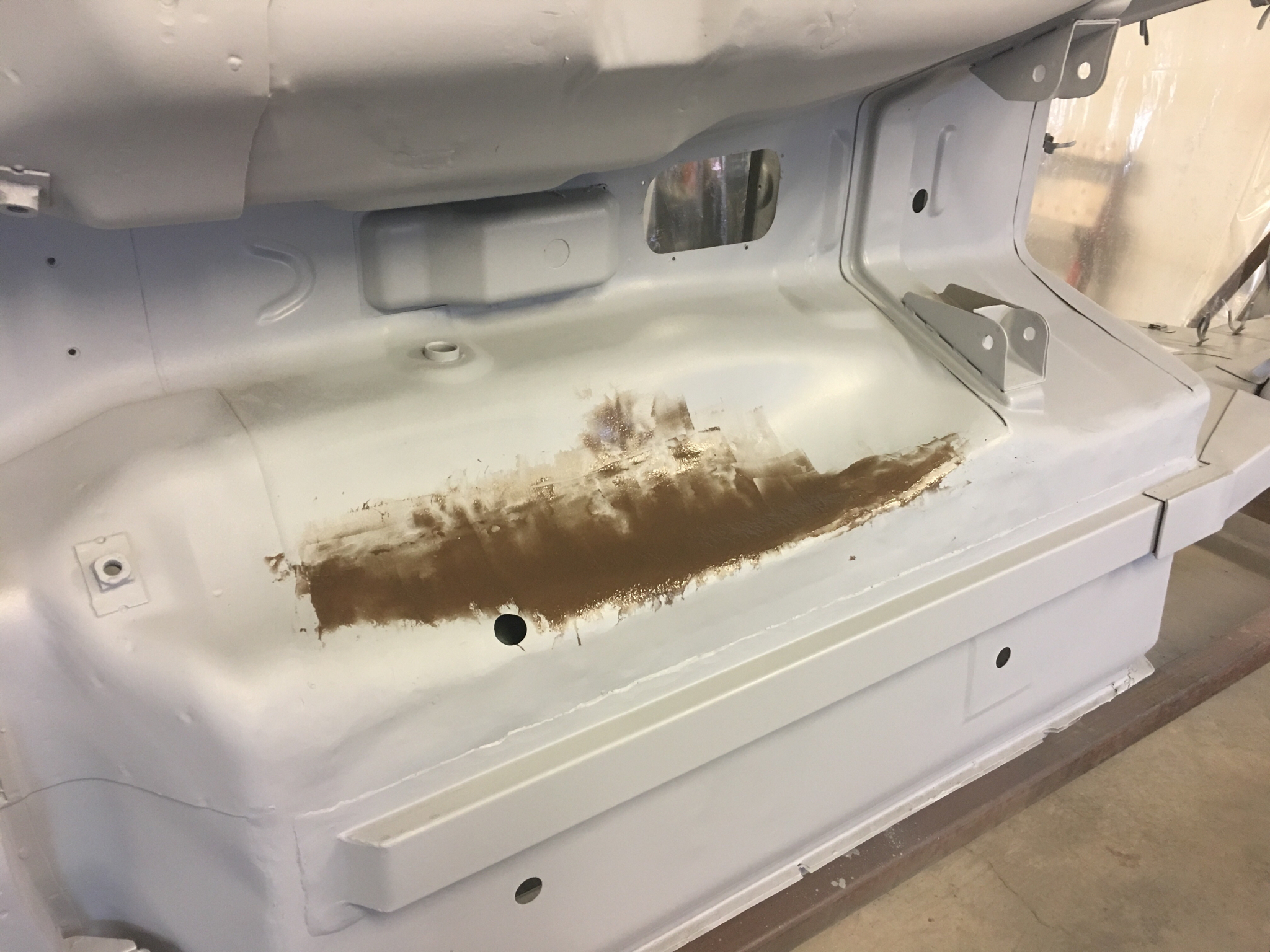

Thanks! If you look carefully, you can see the ceiling fan in a couple pictures that pumps low volume flow through a filter from the roof. It gets fresh air from the side soffit. The large pan on floor creates a draw down area under the chassis and vents through a filter out the back of the garage.
Are you using hook & look or adhesive blocks? I have been using the 3M hook & loop purple rolls for abrasives. They are a little expensive but cut really nice and don't foul too much
Durablock hook and loop. 320 and 400. I also have an random orbital air sander with a 120 grit for cutting the fibreglas down. Expense is relative. If you buy three times as much to do the same thing, are you saving any money? The fibreglas is working well. I have sanded and refilled for the last three hours and I am liking the results. I will clean it up further with glazing putty after I respray the primer.
I agree, I tend to splurge on good materials because the labor is free and I don't have a lot of spare time. I am glad the fiberglass is working out...
