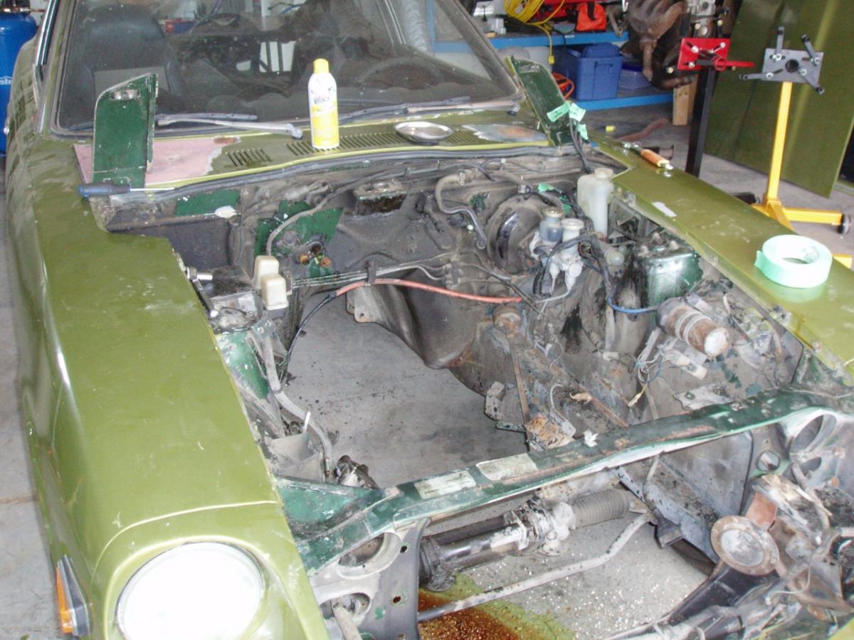

Some progress pics finally:....

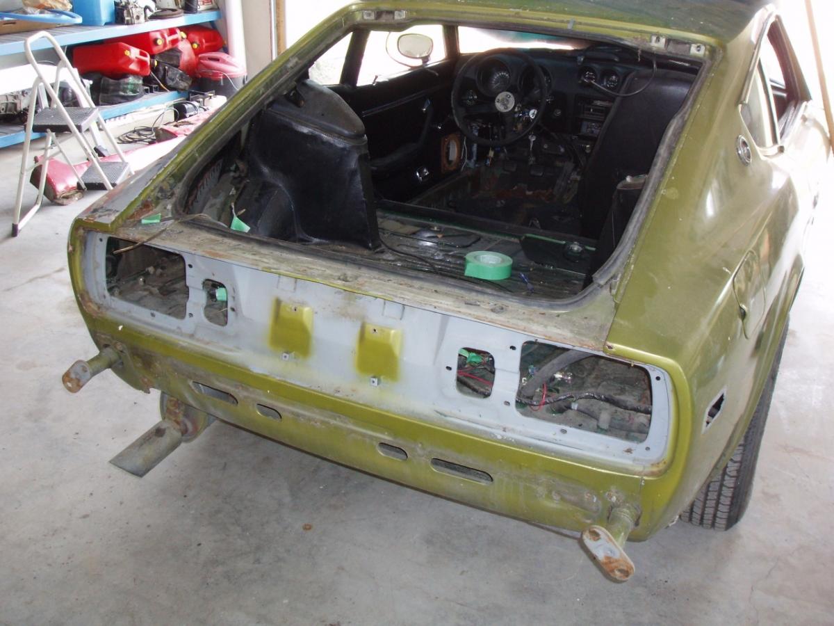

Bumper and lights removed
post-29917-0-99514100-1438037665_thumb.j
post-29917-0-17442400-1438037696_thumb.j

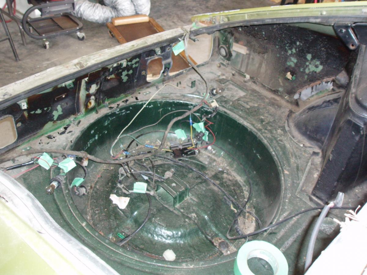

Nice rust free spare area!
post-29917-0-32417000-1438037718_thumb.j
Front grill out!
post-29917-0-85039700-1438037737_thumb.j

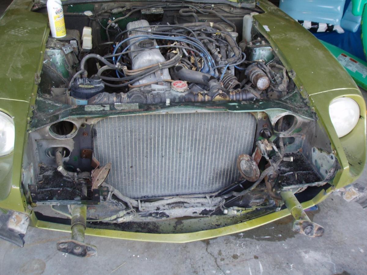

Rad out (yes I drained it first....)
post-29917-0-26439100-1438037814_thumb.j

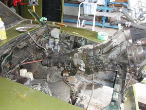

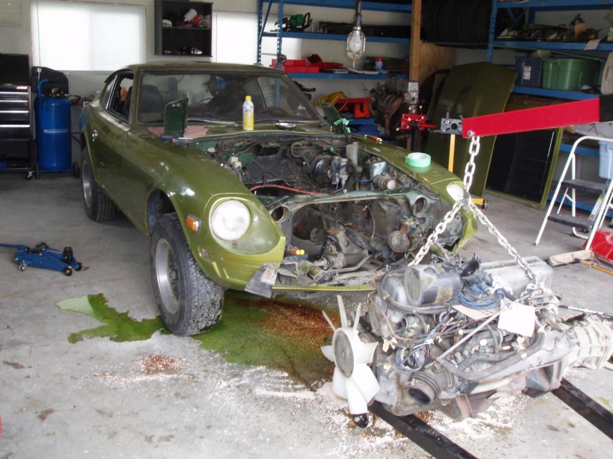

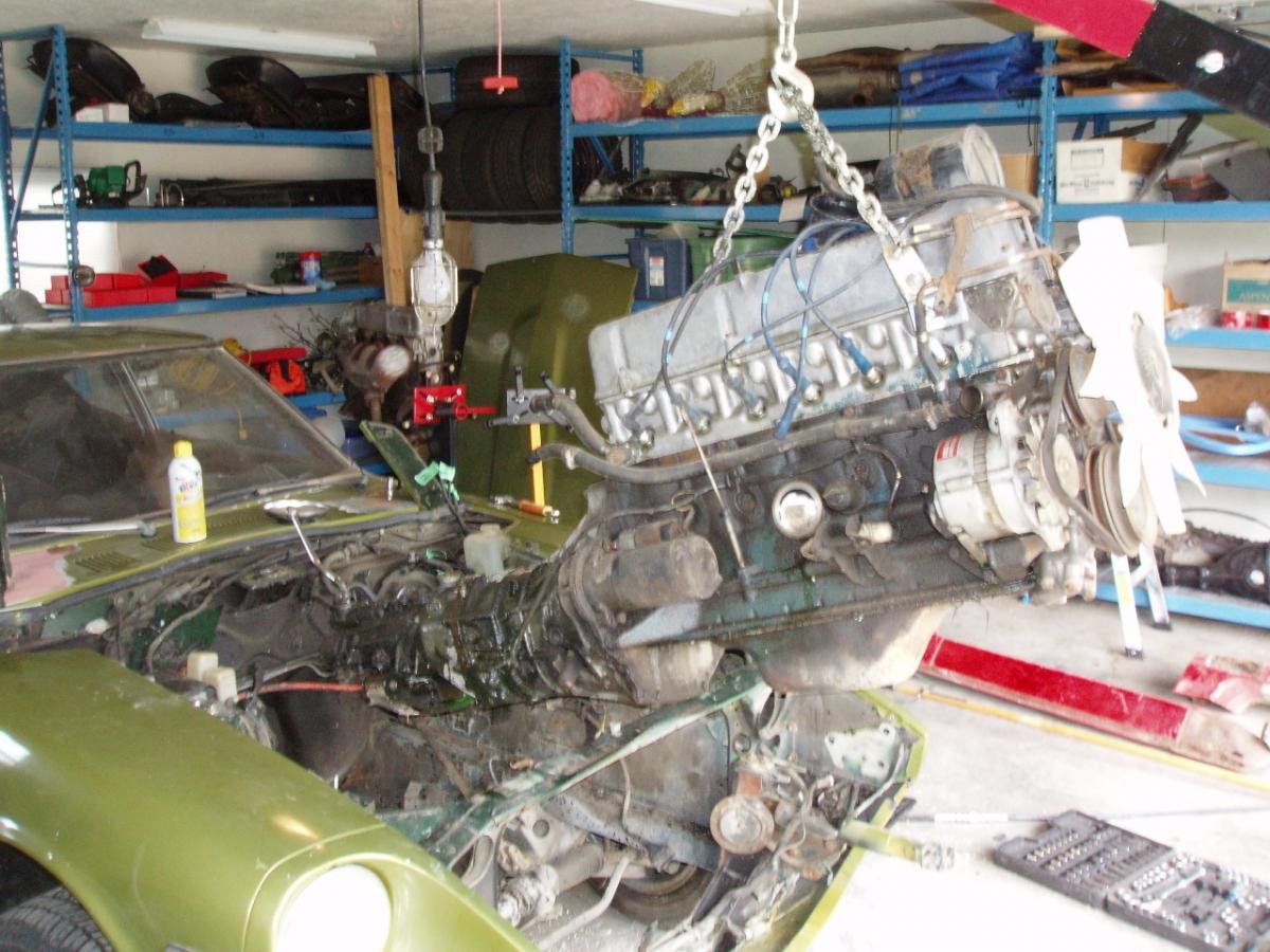

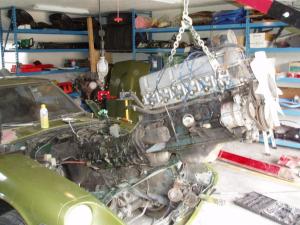

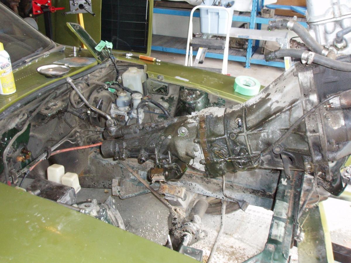

Engine and tranny coming out!
post-29917-0-83246500-1438037837_thumb.j
post-29917-0-09590500-1438037854_thumb.j

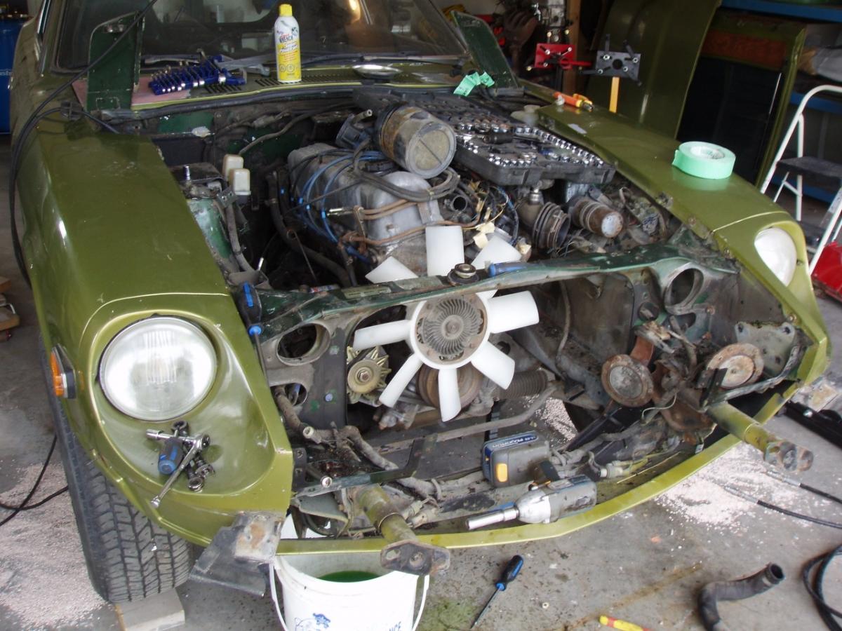

Empty bay!
post-29917-0-26371500-1438037866_thumb.j
The coolant is what drained out of the block when I lifted it.... yuck....
post-29917-0-45395400-1438037874_thumb.j

I am surprised you didn't pull the shifter before removing the engine. It makes it easier to get the chunk out without damaging anything.

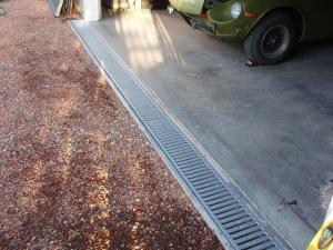

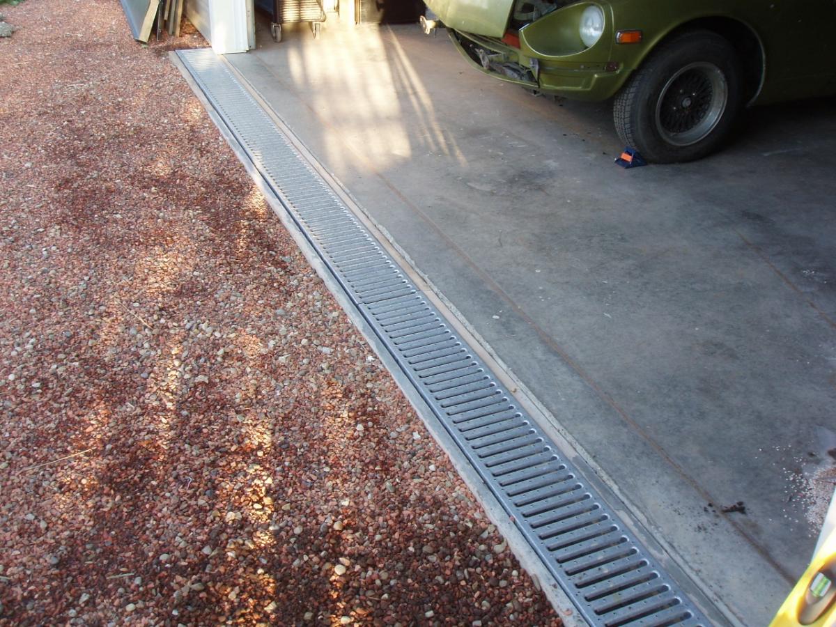

I love the 6" trench drain. The metal grate is nice too. Looks good
:facepalm:
I was hoping no one noticed the shifter...LOL
I was wondering why it was being stubborn! In the end a little push down on the tranny and it came out with no issues. Didn't catch anything other than the shifter opening in the tunnel.
The drain is awesome as my driveway slopes down about four feet to the garage. Now all the water stays out of the garage.

The car is booked in for a frame alignment check and repair (if needed). No desire to weld in new floors to a crooked frame!
Now to just find the time to finish stripping the body down!
I did the same thing with the car I am doing. It was surprising how far the body was off when they got it on the frame rack. A few hours later and it was all good. Do you have the factory dimensions for the frame shop? Many frame shops don't have them. I believe I have them for the 240 but I don't know how different they are from your car. I have done the same thing with the shifter before which is probably why I noticed. When I tipped it down to clear a lot of the gear oil ended on the floor. I think I said something ugly about then... <_<
LOL! It was mostly engine coolant that graced my garage floor... All clean now though.
I have the FSM specs for the frame and the frame shop assured me they had the specs in their frame computer too. Hope it isn't too bad. I can't see any frame impact damage other than a small dent/bent in the front cross member under the rad. Looks like the PO hit a large rock...
Sad part is the frame service will be about $300 and the towing cost around $500.... :shakes head:

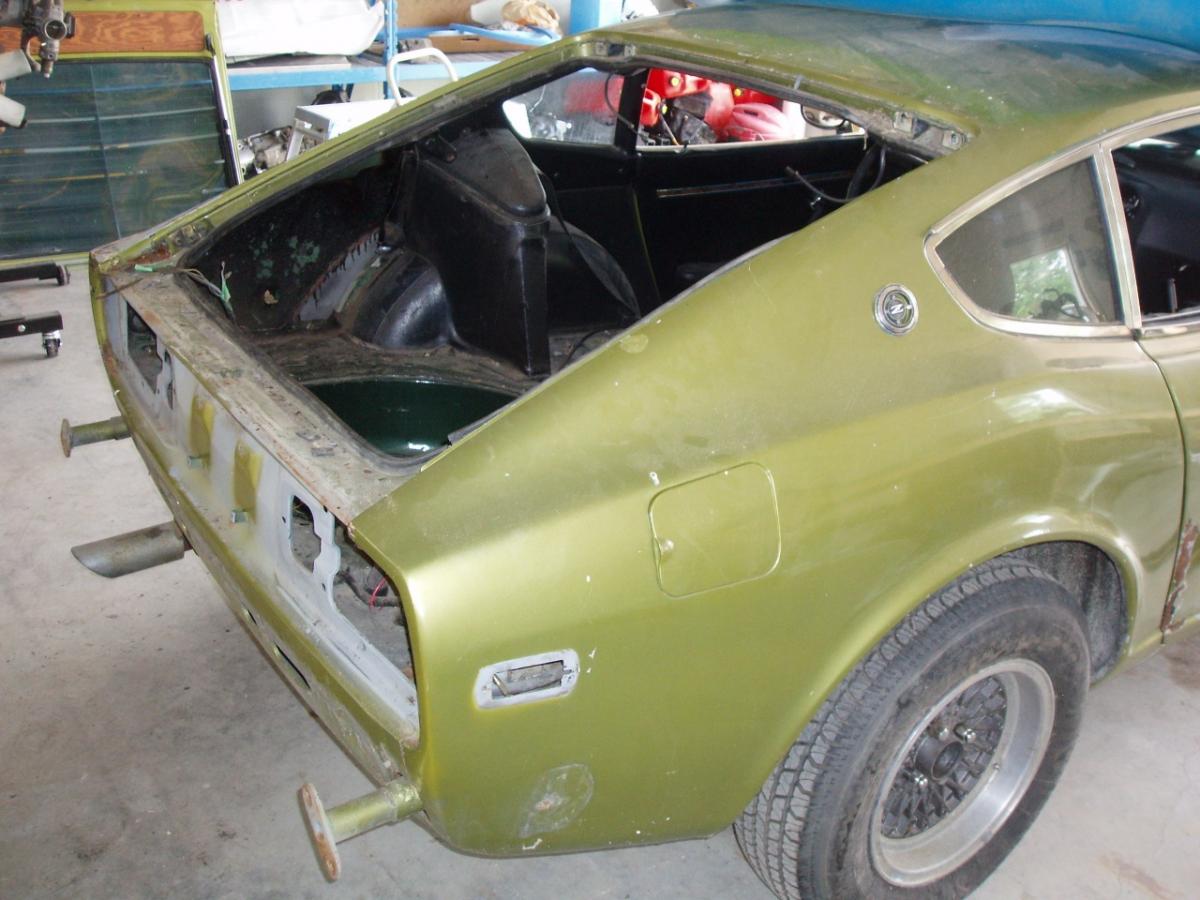

More disassembly last night.... Got the doors and quarter glass out, removed the wipers and cowl, started removing the fenders. Removed a lot of the interior rear trim as well as the remaining scraps of carpet and vinyl.
I had no idea our doors were that heavy!! Seems disproportional somehow...
