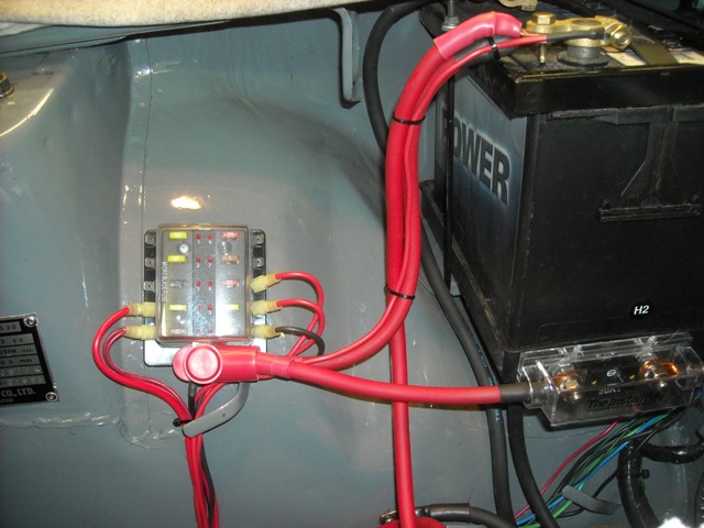

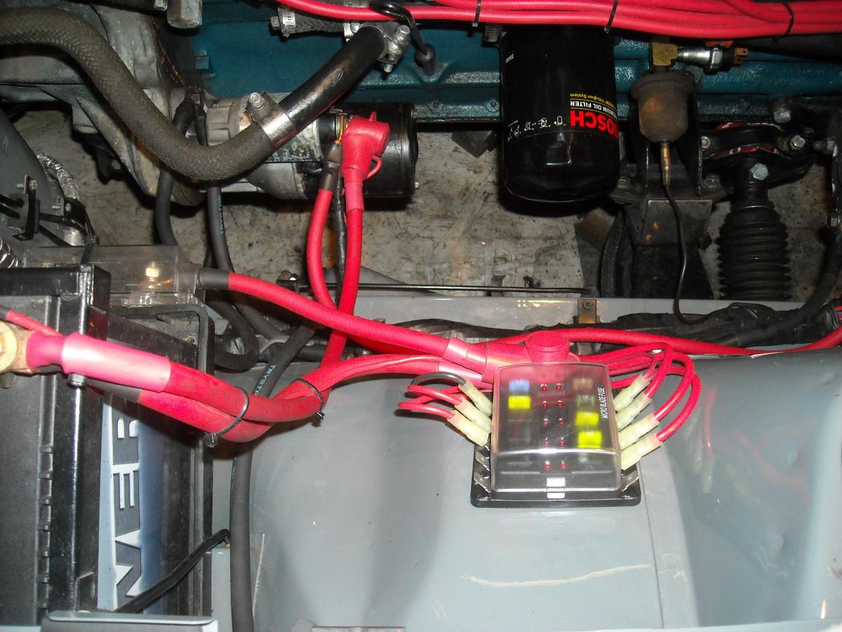

This is what I put together last winter, the mini fuse block was added to accommodate the added load of rad fan, fan controller, fuel pump, high and low beam. It is all working well but now I'm thinking maybe I should have a second look at this set up after reading Capt. Obvious' comment about the fusible link. The big cables for pos and neg are 4ga, the rest are 12ga.
Chris

Granny, That's beautiful work, but you're right... You've got the same unprotected connection between the alternator and the battery. Obviously (that's me), everything will work fine under normal circumstances, but it's those unforeseen and unexpected faults that fuses and links help with.
I've never looked in depth at any fuse or alternator upgrades until now, and because of that, I've not given the details very much scrutiny. But now, simply by chance, I've been planning some wiring changes on my own car so I have familiarized myself with that part of the system.
Do I really really think it's necessary to put some protection in there? Only if something goes wrong.  :)
