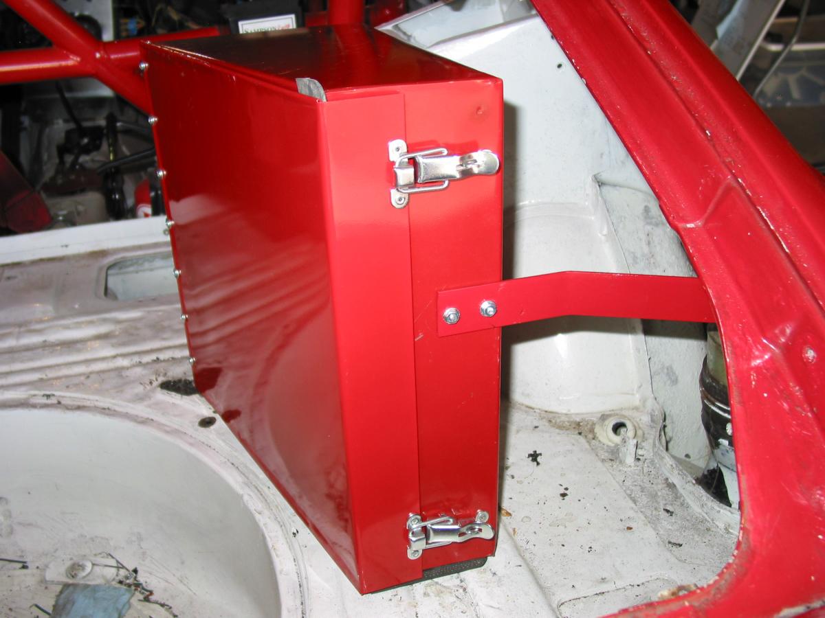

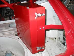

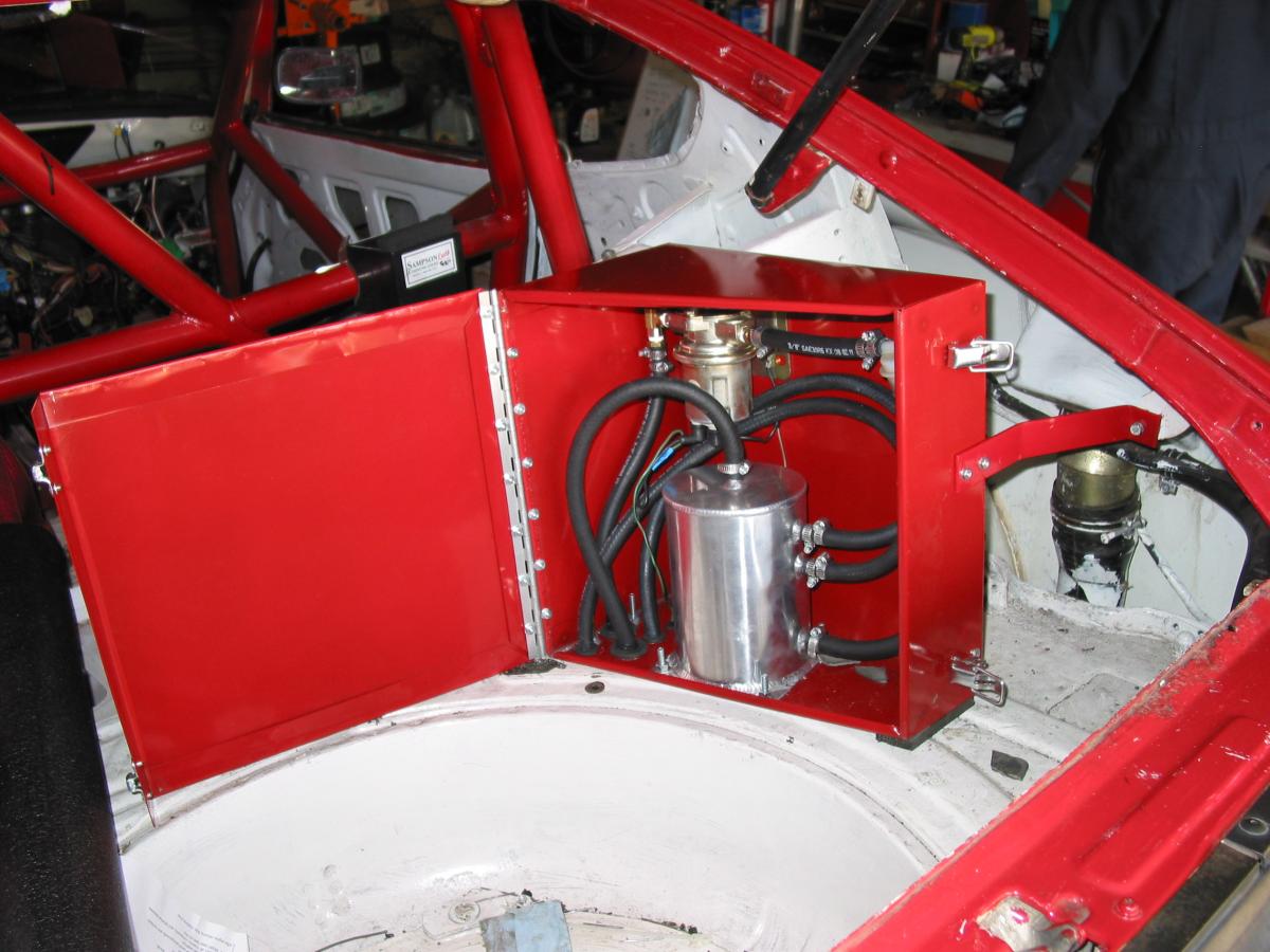

I run the 4070 on my 260Z endurance racer running 3 screw SU's.  It works great.  I use a Facet cube pump to fill the surge tank and the Carter 4070 to feed the engine.  The surge tank allows me to use all the fuel in the tank.  Prior to installing it, I couldn't get all the fuel out of the stock fuel tank, but with the surge tank installed, I can run two full hours on a tank.  The car runs for up to 26 straight hours on the track, so performance and durability are critical.  The 2.8L engine puts out about 175 RWHP.

Not to highjack, but Jeff how does the surge tank help pull all the fuel out of the tank?
Charles
Charles
Without the surge tank, the main tank pickup will suck air in the corners and create fuel starvation to the engine.  With the surge tank, the main tank pickup will pull fuel down the straightaways to fill the 1/2 gallon surge tank.  The surge tank has plenty of capacity to feed the engine through the corners.
The only downside is that once the main tank is empty and the 1/2 gallon surge tank runs dry, the engine quits with no warning.  The good thing is that on an average track, we can extend our runs from about 1 hour and 40 minutes to a full 2 hours which is the maximum driver stint time allowed.
