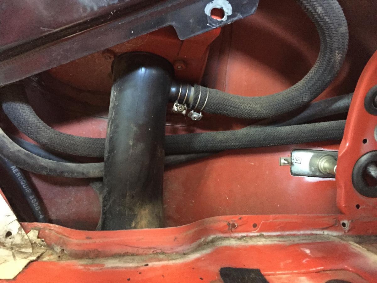

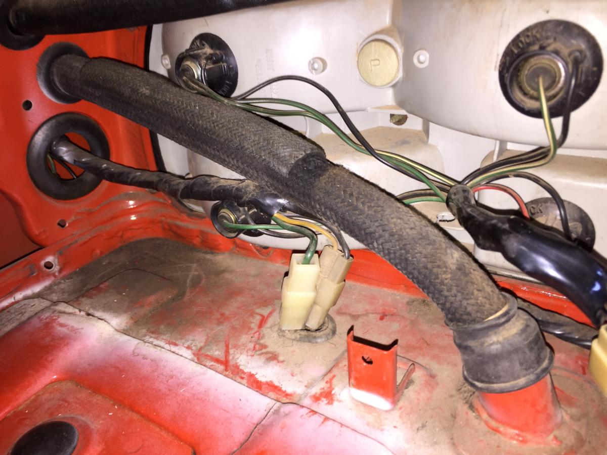

I do have a fuel smell in the cabin of my car: I expected to take off the panels at the back and find a bunch of rotten hoses. But they look pretty good as you can see from the attached pictures. The hoses are pretty hard, are the cloth hoses very pliable when new? There is one long line that runs along the back panel that goes through the floor that should have a grommet at the floor but doesn't, not pictured. I might try just changing this and renewing the grommet to see how it does.

Check your fuel/air/vapor separator for any cracks or defects in the braze joints.  Mine had a crack where one of the nipples was brazed on.
Even though you say your hoses look good, they shouldn't be hard.  If those are the original hoses, one of them could be cracked or split.  I'd replace all of them with new.
I can't seem to find any old threads, "404 Not Found", keeps showing up this morning but there's alot of info on that.  I cleaned my tank and replaced all those hoses a few months ago.  Mine were original and hard as a rock, all cracked on both ends.  There's only 1 you can get to easily, 1/2" that comes out the top driver's side of the tank.  The others are a PITA but doable with the tank out.  here's the only one I can find, http://www.classiczcars.com/topic/24181-rating-the-factory-240z-fuel-vent-hoses/

Today the best thing to do with an old gas tank - is buy or rent a good inspection camera and look inside - then decide what you need to do. There are lots of different processes to be considered  - depending on what you can see.
I think the hose that is the more difficult to deal with - is the one that come off the top of the tank - and required a tight 180 degree bend. Various ways of accomplishing that.. several documented here on the forum.
Personally - on the 240Z's I drive fairly often - I just eliminated the vapor recovery lines all together. But even so you still have to deal with proper venting of the tank, so it can be filled. Which means you still have that long line with the 180 degree bend to deal with.

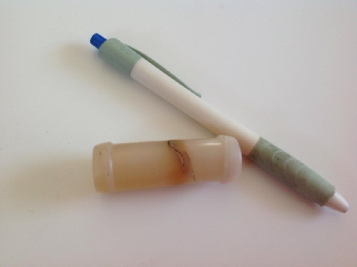

What is this fitting called? It's about 3/4" and joins the main fuel filler hose to the thick line that goes to the vapour tank. It's got a nice big crack in it.
I don't see it listed at the z store. Is it a standard item I could pick up at an auto parts store

I don't know where you'd find that coupling but when I did mine I used brass "PEX" fittings.  Any plumbing supply or hardware store should have them.  https://www.google.com/webhp?sourceid=chrome-instant&rlz=1C1BOFA_enUS494US494&ion=1&espv=2&ie=UTF-8#q=3%2F4%22%20pex%20coupling
That looks to be the JOINT-TUBE BREATHER  17227-E4100 or 17227-E4600 per the online catalog up to 7103.  For 7104 and after it is 17227-E4101 or 17227-E4601.  The catalog shows this as a "T" fitting, mine is also a straight fitting.  Unfortunately I can't do a paste from IE to get the catalog link to you.  The "T" fitting might be the 4100/4101 and a straight fitting might be 4600/4601 or vice-versa.  This is probably a Nissan-only part, see if your dealer can help.
Thanks, It looks like I'll need to come up with an alternative. The brass fitting looks like it would work.
