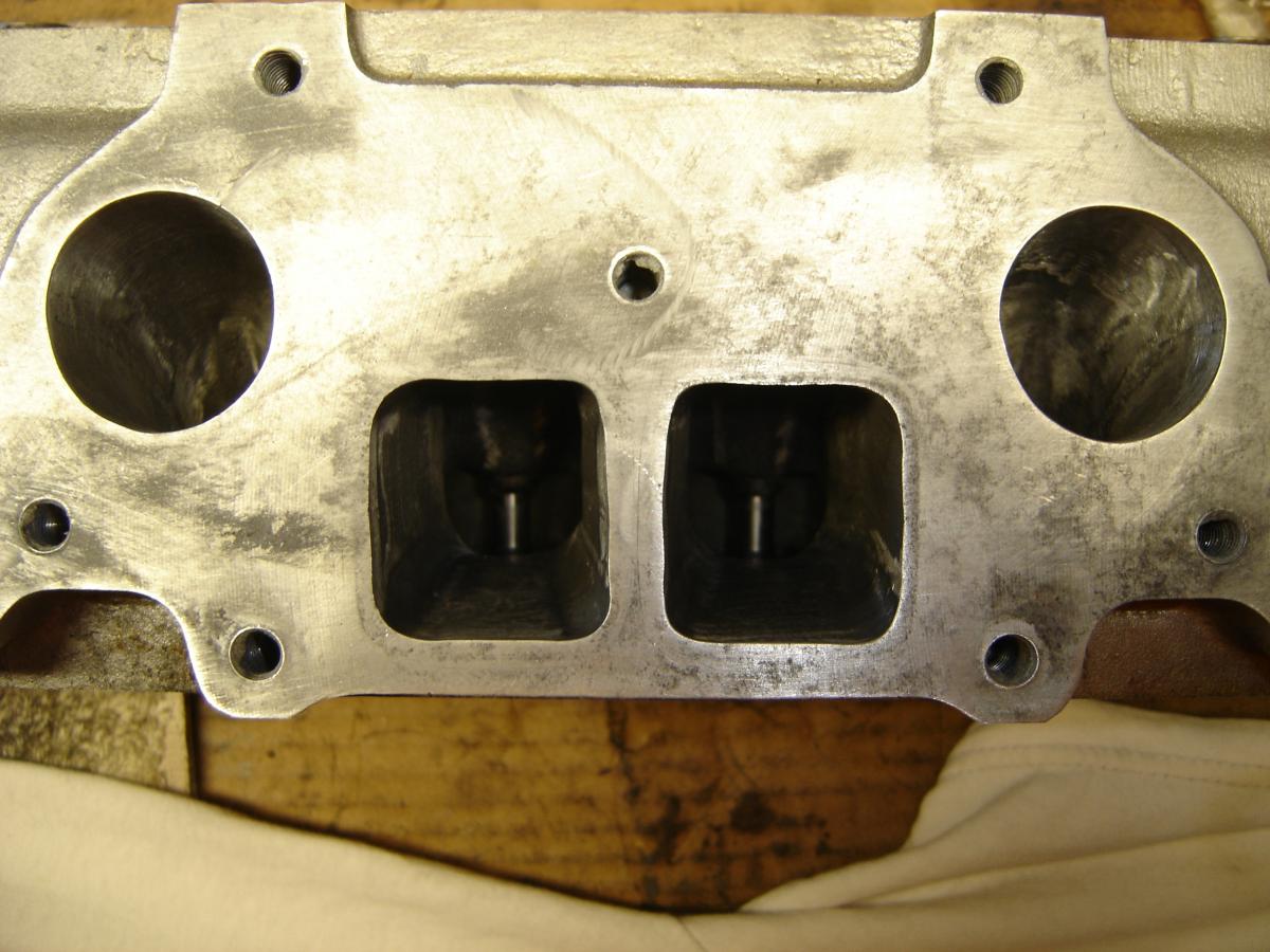

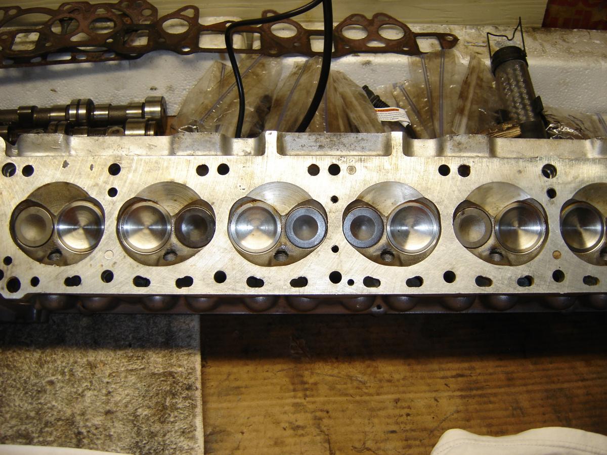

I've been smoothing the intake and exhaust ports and will be matching port sizes as soon as my gasket comes in.
Does it look like the valves were unshrouded before the bigger valves were installed?  I don't know myself, all I've done is read and looked at pictures so I'm guessing they were?
EDIT: the E-31 was with a project car I bought so I know nothing about what was done before I got it.
Thanks for looking,
Cliff

Easy way to tell is just lay a HG against the chamber. I'd say NO to unshrouding has been done. You can still do it now if careful and would highly recommend it. Make sure you get rid of all the sharp edges and any spark plug threads showing! I'll try and find a pic of mine.
I was going to do an E88 head but decided to go ahead and use the E31 that already had the 1.73 & 1.38 valves installed.  For some reason I thought I'd save it??  Madkaw I'd love to see your's.  I can get the valves out pretty easy now if I need to for the unshrouding.  Might go ahead and put some shorter valve seals on there anyway, just in case the reground cam needs the room.

Putting this on a L28 or l24? If it's going to be l28 you definetly want to open up the chamber. I would also measure out the chamber size for reference.
There's no polish necessary, just some sand paper and patience.
Well there's my dilemma, 2.8 or 2.4?  I've got both.  A 2.8 bored .030" over with dished pistons or a 2.4 with flat pistons.  I'm thinking of putting the E31 on a 2.4, then working that early E88 head I bought a few months ago to put on the 2.8.  Decisions, decisions.
Yep-you have some decisions to make.
a .30 over L28-even with dished pistons will be high CR. IMHO, with no quench in dished pistons, it might not be the best option. Might need to much timing pulled. I think flat top L28 .030 over would put you around 11 to 1 , not sure what dished pistons would be.
L24 will be fun and I run full timing with that set-up. Maybe not as torquey as the l28, but I got 155RWHP with SU's. Like said-you will need to modify the block for bigger valves, but you can do that yourself.
