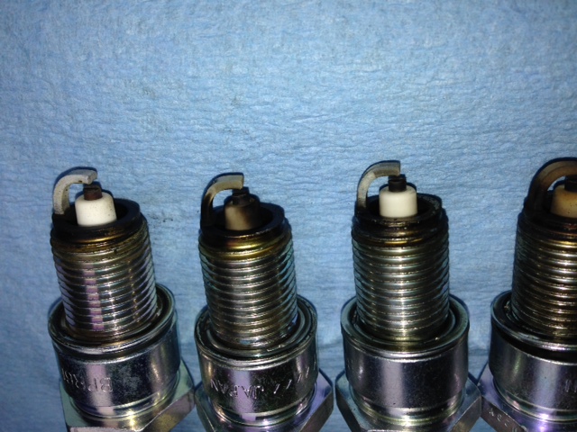

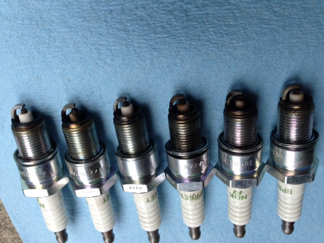

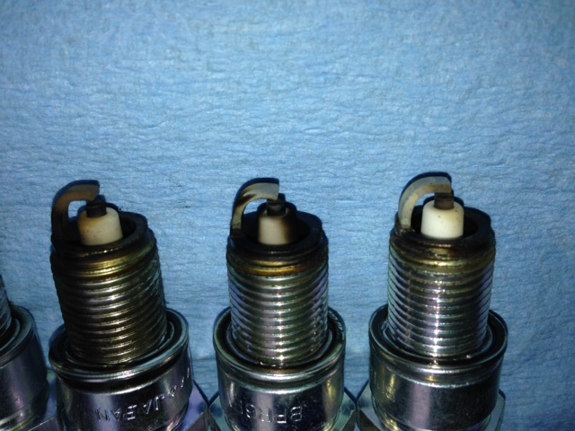

The brake felt lousy, so I suspect a vacuum leak is part of the problem. Perhaps even the booster itself (A bit of an erratic idle today). I also enriched the front carb half a turn and the rear a 1/4. I' pulled the plugs and took pictures. You guys figure that was enough richening to get me back in the ballpark? Is it strange that they all seem to be different colours?

Numbered 1 through 6 from left to right. This was after running the car for 5-10 minutes with the choke on. They look the same as when I pulled them 2 days ago, but the black sewt is new.

from the plugs, the front carb could use an additional 1/2 turn of fuel jet, the back carb could be backed off a 1/4 turn.
