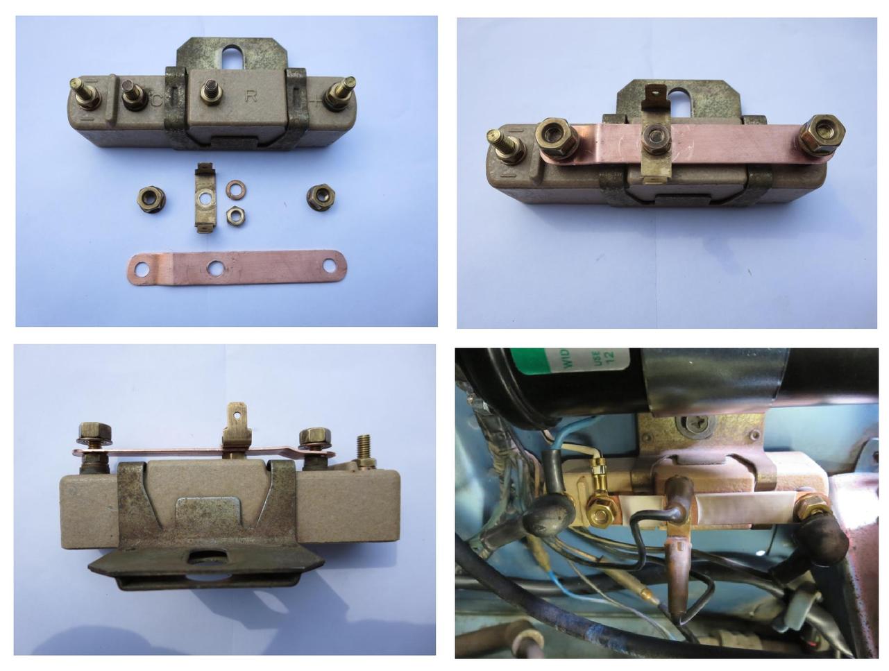

I played around with the resistor today. If you look at the photo's in post #1 you can see I fitted all the positives to one terminal bypassing the resistor altogether so I could use the 12V coil.
This was ok for testing, but I wanted to keep the stock look as much as possible. Toyed with the idea of pulling the resistor apart and bridging it internally, but then it would not be reversable and maybe in the future I would want to go back.
The easiest way seemed to be fitting a plate over all three terminals. I used a copper strip to fit under the termials. The strip is covered with a double layer of heat shrink to prevent arcing if it gets pushed down onto the resistor bracket. Now its not quite original, but looks a lot better than with all cables on one terminal.
Now if it would only stop bucketing down I can take if out for another spin.
Chas

In my last post I showed a plated mounted on the resistor. That was done as a temporary measure until I ordered a new 6 volt coil. The coil I was using in the testing required 12volts.
The system is now fitted with a Pertronix Flame Thrower II HEI Module D2000 in the TIU and a Flame Thrower 45000 volt 0.6 ohm coil P/N: 45011.
