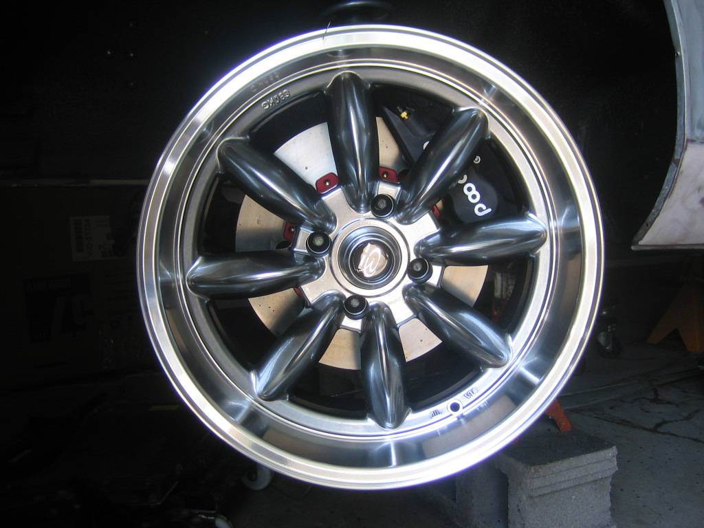

May 27, 201410 yr Author comment_448634 So everything is here and ready to be bolted in except I'm still waiting on spindle pins, bearings, etc from an order that STILL hasn't shipped.... The Wilwood calipers are very light but wow are those rotors the opposite. The factory aluminum drums must weigh less than 1/4 what a rotor does! I don't think the calipers will even be visible behind the Hayashi knock-offs I ordered, but the holes and slots might give an interesting aesthetic. The ground control stuff looks prettier than the brakes and the powder coating is fantastic for the rusted stuff they started with. Will post pics of the install and the hacking of the towers.ou For those running the Wilwood 4 piston calipers, did you gut the rear hard lines, bypass the boxes (checkvalves/prop valves?/no idea) at the drums or tie in the same as the drums were? Will be installing a 15/16" MC and Wilwood prop valve in the bay. Link to comment https://www.classiczcars.com/forums/topic/49093-last-chance-to-stop-me-going-coilovers/?&page=3#findComment-448634 Share on other sites More sharing options...
May 27, 201410 yr comment_448646 I guess I missed this thread earlier. My insight will just be fill for the thread now but, I run 17X8.5 +4 offset rotas. I never saw your offset on your wheels.I rub ever so slightly on the rears with 245/45 tires all the way around. I went too big with the rubber, I believe anything smaller will fit in stock fenders WITH fender lip rolling and slotted towers for additional camber. I tested for clearance by removing the spring and running suspension through it's travel with 235's on the rim and it cleared-then i ordered 245 tires-dumb. So now it rubs with a passenger over big bumps. I didn't go with coil overs because of cost and I wanted to keep the rubber top hats for road noise avoidance. I spent my money on Wildwoods-no regrets:cool: I will shortly be trying smaller tires-like 225's - on the to do list. I think 9" wheel will be super tight and you would need at least + 10 offset if not more to tuck into stock fenders. Then they would fit on the front with stock perches. I believe tokico's have become availabe again Link to comment https://www.classiczcars.com/forums/topic/49093-last-chance-to-stop-me-going-coilovers/?&page=3#findComment-448646 Share on other sites More sharing options...
