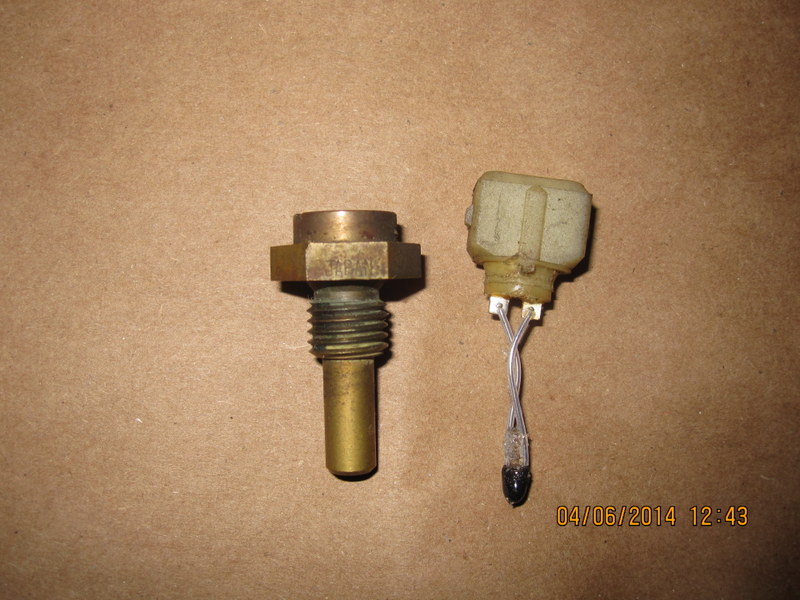

I accidentally ripped apart a coolant temperature sensor trying to get the plug off. It came right out of the top with the EV1 connector attached, just minus the threaded metal portion. The actual sensor is just a blob of semiconductor on two pieces of wire, surrounded by a gel, probably silicone, inserted in to the brass housing. If you have an old coolant sensor it might be worth an experiment. I'm sure it would have a fast response time out of its housing.
No editing allowed, so here's another post. A picture of the guts.

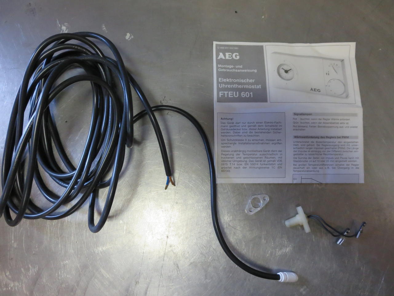

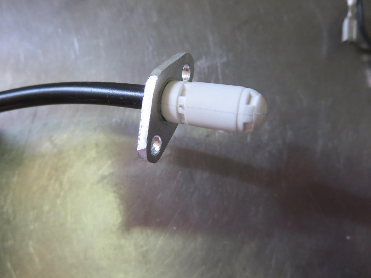

I found a thermal couple for a floor heating system I had left over from our central heating. It has a quicker response time than the water temp sensor and the same resistance span over the temerature range. Thats comparing the water temperature sensor (out of the engine) with the thermal couple using a hair dryer.
Its a little different in shape and I had to make a plate to get it to fit in the AFM. Its now glued in the plate and drying. Only thing left is to trim the cable to length, fit the crimp termanals and install it in the AFM. That will be tomorrow.

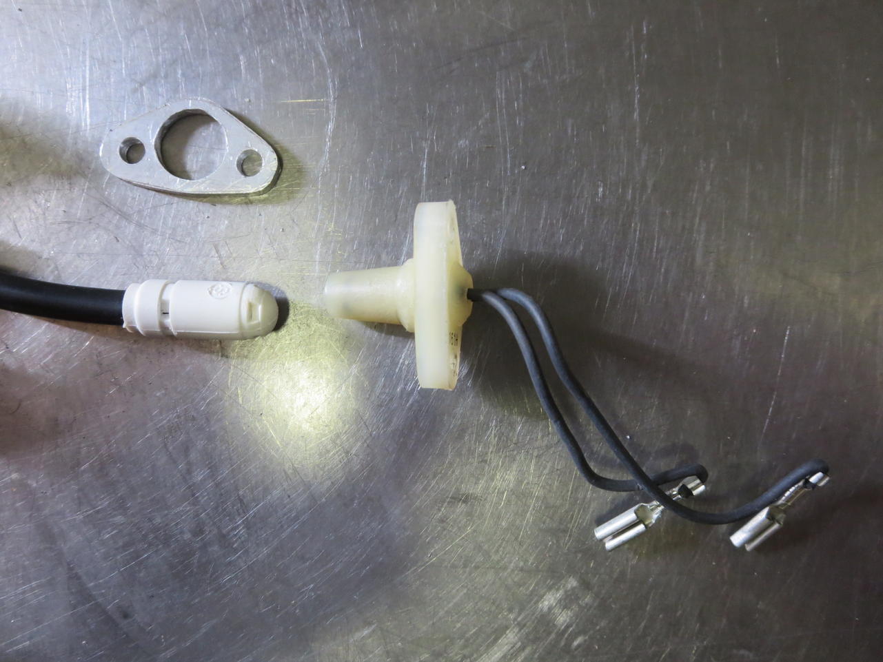

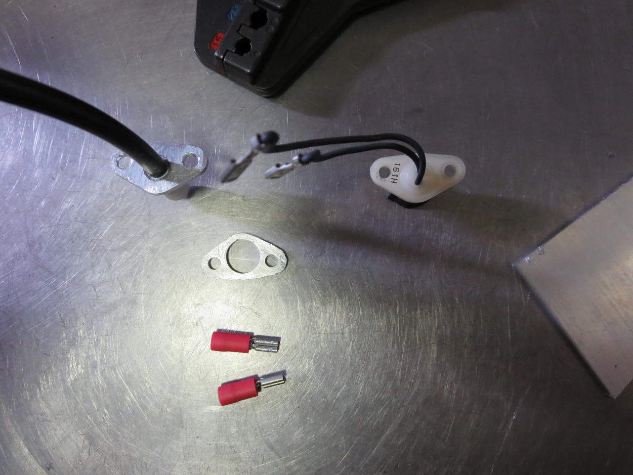

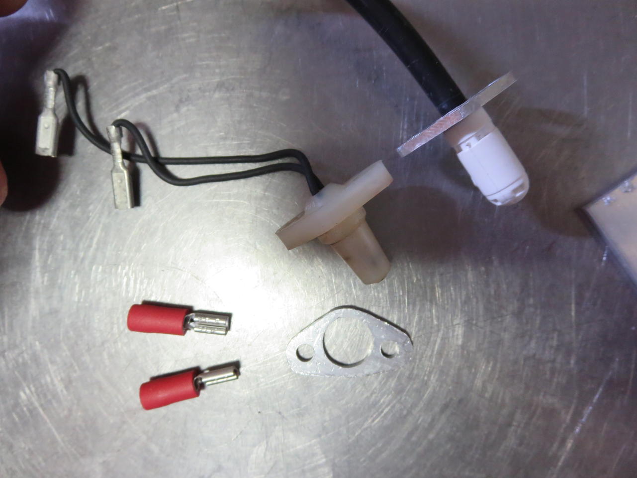

Here are some photo's to give you an idea what I mean.
ZED: I checked the wiring and couldn't see any damaged, so it looks like its in the sensor itself. Thanks for the tip on removing the sensor. I managed to get mine out undamaged so I could compare it to the AEG sensor. Mine looks pretty scruffy, but it works and came out in one piece.
