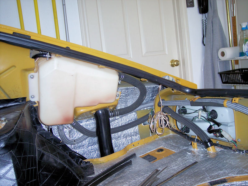

Underhood fuel lines are not your only concern. Rubber vent lines are also at the back (see the pic) coming off the tank and will likely need attention. Don't rush into this area, I just want to alert you to another set of lines. You will have a rubber line that connects the tank to the steel fuel line and another that connects the steel return line to the tank.
