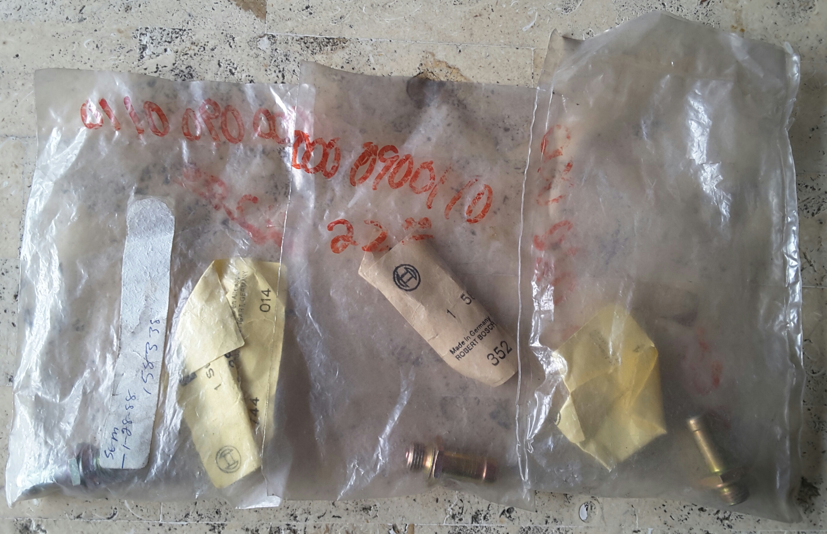

i followed the steps of captain obvious's first option, volvo check valve and audi hose.  i lied to the ebay seller and told him i had a volvo so he'd send me the part.  i don't have a lathe so i just shortened the threads on the check valve with my bench grinder, worked fine.  i trimmed less than 4" off the total length of the hose, everything fit together perfect and leak free, fuel pressure holds overnight and the car now starts almost at the thought of turning the key!  such an improvement.  thanks!
