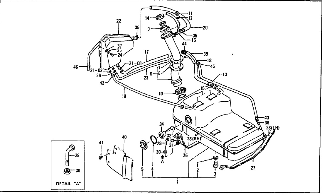

A common culprit is the rats nest of vapor recovery lines that live in the back of the car, but that doesn't have a lot to do with whether the engine is running or not.
I primarily notice it when I turn it off. However, It's pretty much whenever the car isn't in motion. So maybe just moving helps circulate the air so it isn't as noticeable.
And yes, it's quite noticeable after the car has sat in the sun. So from those vapor lines seem like a good place to look. Thanks! I'll get back tomorrow to see if I find something back there
Replacing the vent lines solved the fuel vapour problem in my '73. The worst hose was the driver side rear one in vicinity of item 36 in Capt 0's image above. The hose was so bad, that with a full tank, the fuel would pour out under accel.
