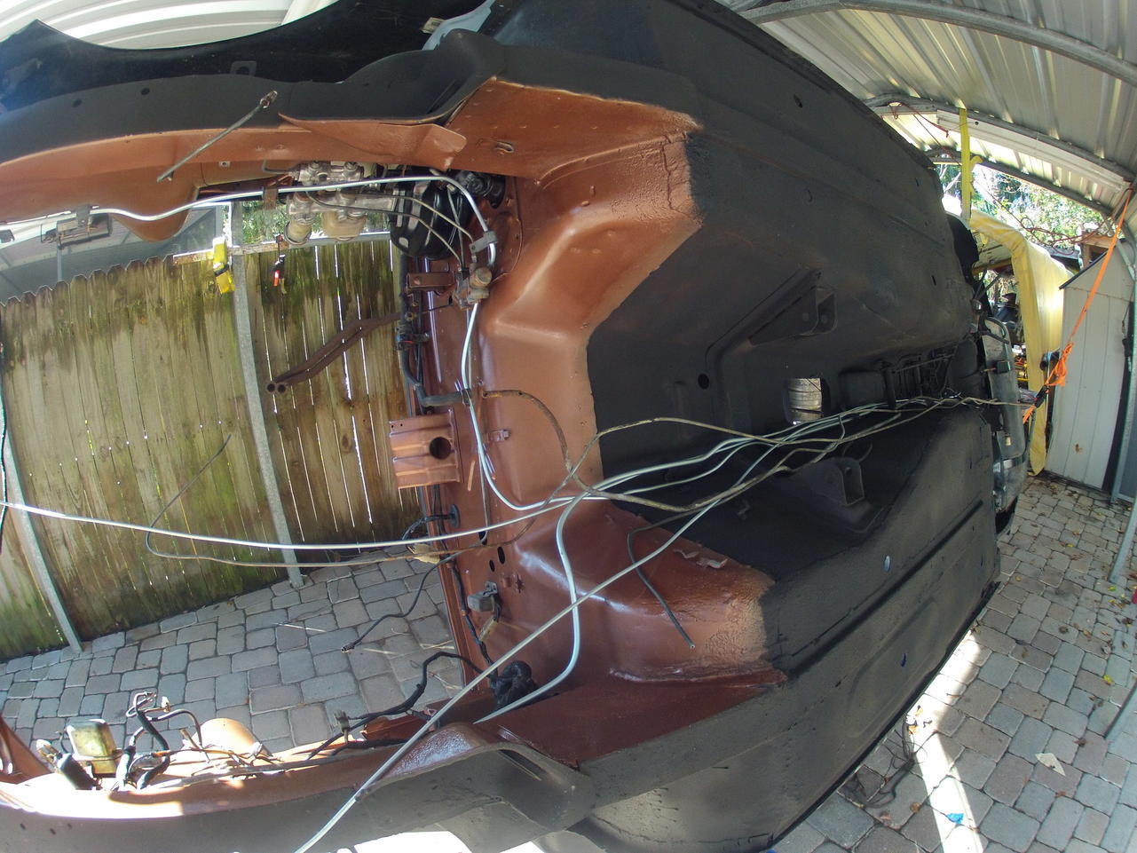

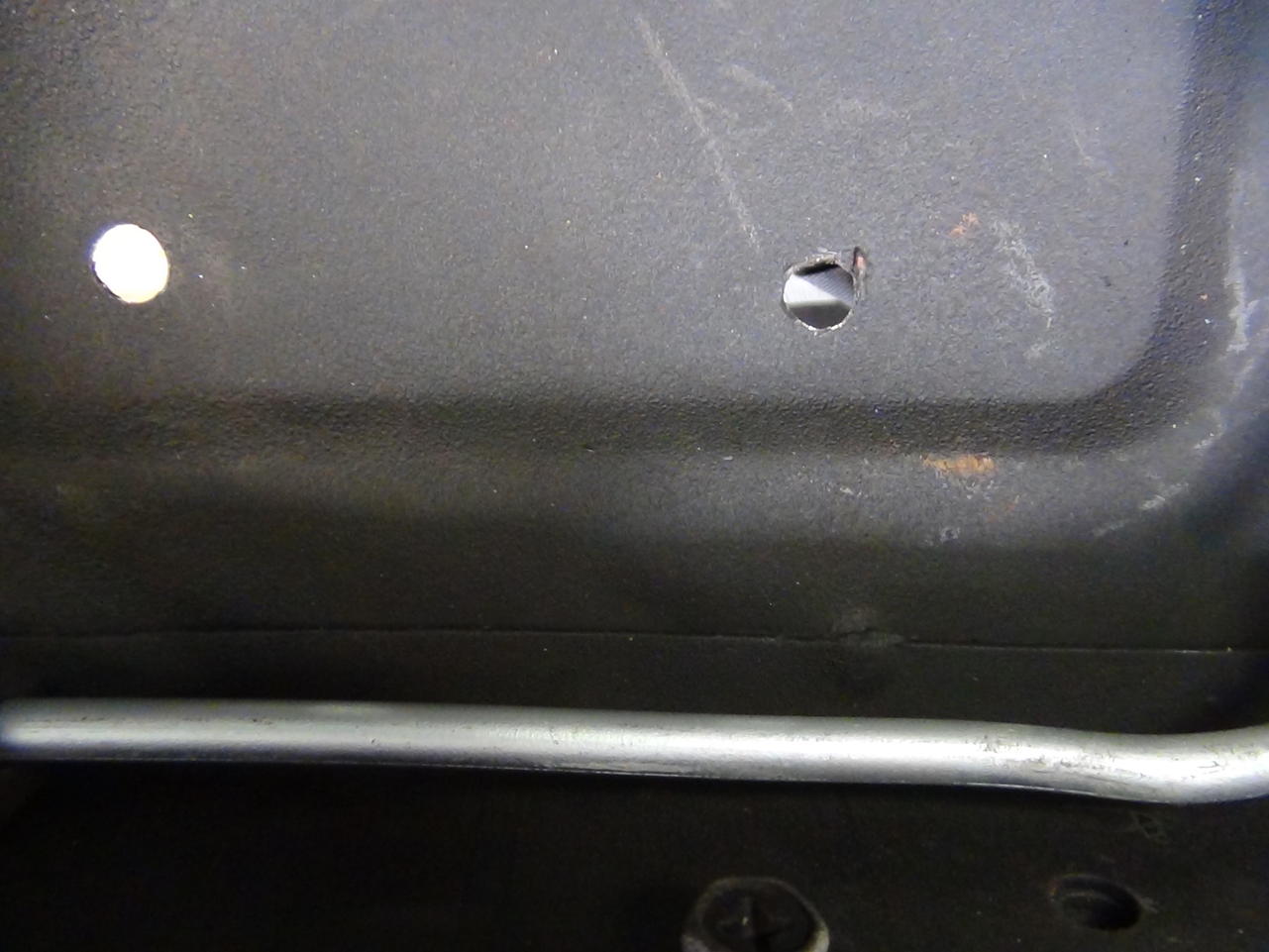

Hello, it has been about a year since my last post. This car I bought was completely disassembled when I bought it. I am slowly getting it back together and I am not able to figure out where the fuel pump mounts to. There are two sets of holes going through the trunk area and it does not fit there and there are two holes going through the frame and it does not fit there. I have looked for photos of an original and have not been able to find any. I hope someone can show me a picture and help me out. Thank you for your time.

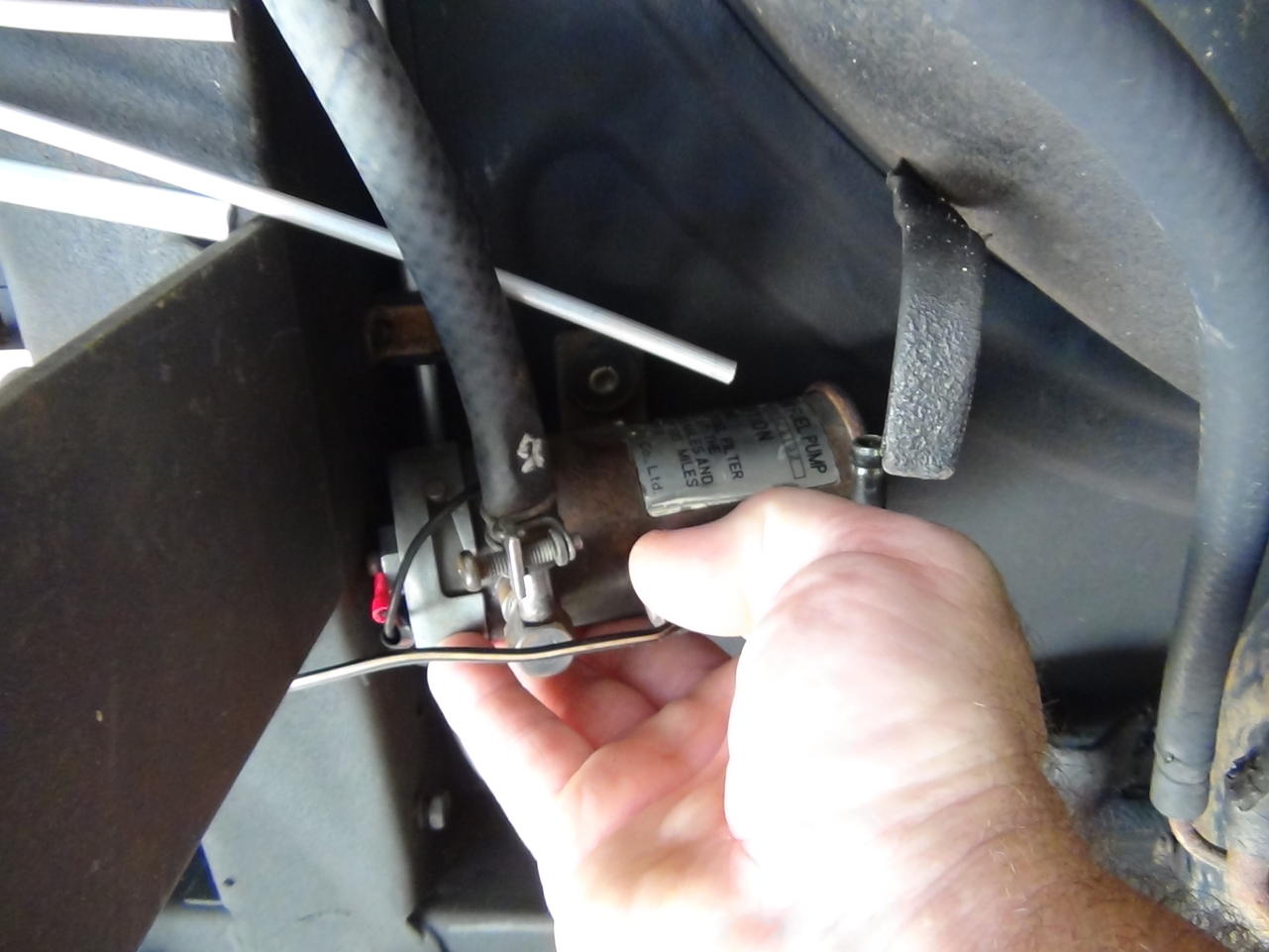

post-24191-1415082758423_thumb.jpgNot very photogenic, guess I take pictures of everything.
I took it off to paint it, put new hoses, clean the contacts, etc., but after installing a fuel pressure gauge decided it didn't need it. The mechanical FP is OK. Just have an extra fuel filter there now.
Removing the electrical connection on the side of the pump to clean it was a mistake, it was well sealed and the contacts were clean, it's hard to remove the cap that covers it without damaging it.
I might reinstall it with an inline on/off switch, and without hooking up the hoses in case the mechanical FP goes out on the road, or maybe just keep a spare mech. FP in the car.

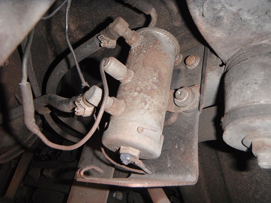

The bracket connects to the frame behind the right rear wheel.

Thank you so much. The photo is zoomed in so much it is hard for me to know exactly how it mounts. It does look like it mounts to a bracket and then to the frame. I think the bolt above the Phillips screw is the one I see in the photo I have. Thanks again, I am going to look for a bracket like I see in your photo, I might have it.
