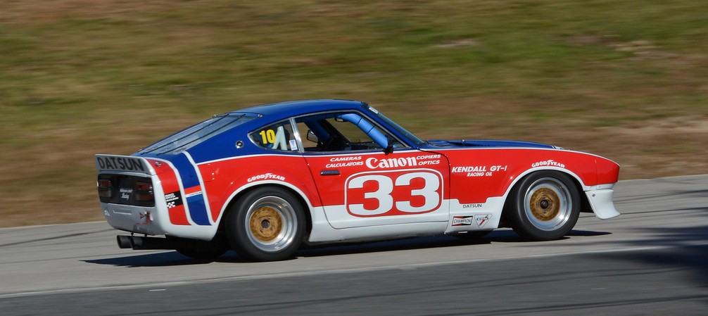

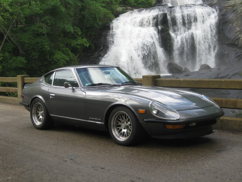

As someone with a lowered 240Z I have gone from tired stock suspension height to new stock suspension (higher than tired old) to so called lowering springs (help, I may have installed the fronts in the rear!) and then to coil-overs (GC using my old struts and sectioning them). Like the 240Z race car the engine crossmember in the street 240Z sits at 4 inches off the ground. That results in a few things worth considering. First you need to very careful to tuck the exhaust up as high as you can. Next pay attention to your tire and wheel size, the front brake rotors (too big and the LCA front lips have be be trimmed) and your outer tie rods (a lowered Z puts added stress on the inner tie rods so a custom hiem joint set are a good idea).

gnosez make some interesting points about exhaust height & ride quality. I have an MSA 2.5" s/s item & it's ok, but could have been better regarding clearance (was originally bumbing against the Diff). If I did this again I would go custom - price would be about the same. I think the spring comment may be referring to a batch of Eibach's that I think were labeled f/r incorrectly.Ride Quality ? I have Poly bushings & in my experience these have contributed more to the harsh ride than the springs & shocks. Based on the pic's of his very nice ride I think I'm at about the same height of the road (measured from the jack points) ~ 4". Will go measure.

I'm riding at 5.75 at the flat bottom of the front fender near the jacking point and 6 at the flat bottom just before the rear wheel well.
Street 250/275 and mid-point on the Tokico HTS fronts and a turn less (softer) in the rear 245/45/16 tires (picture shows 225 in the front- those are no longer available in the style)
Race 375 all 4 corners and just a notch or two from harsh in the front and two turns down in the rear 275s on 10inch wide 15 inch rears and 225 7inch wide 15 inch wheels front
