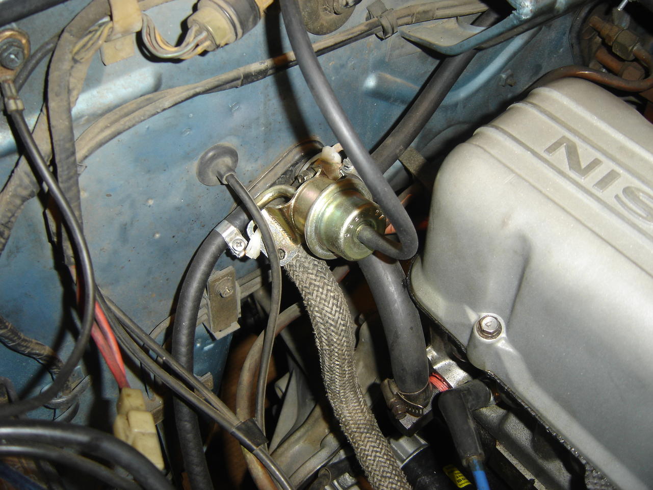

I'll have to check on the FPR. It's just a cheap EBAY model. (I think it was around $50) I bought it and a piece of the AL fuel rail you spoke of to play with a few months back. I looked at the stock rail a little this morning. The way it is designed if the fuel diverts equally along the front & rear loop, the entire rail should get flushed with new cool fuel as desired. However, I wonder if possibly one of those loops doesn't get flushed very well. If the stock FPR was moved to the end of the rail then that possibility could be eliminated. I forget the link, but someone on here did relocate the stock unit to the end and cleaned up the rail looks tremendously. I need to find that again.
Lenny
That's the universal FPR I bought only to find out it wouldn't keep the pressure. I almost bought a rising rate Bosch or MSD? like in the picture but tried the coolant temp tweak and it cured my problem. So I just bought a '78 model FPR and put it at the end close to the firewall.

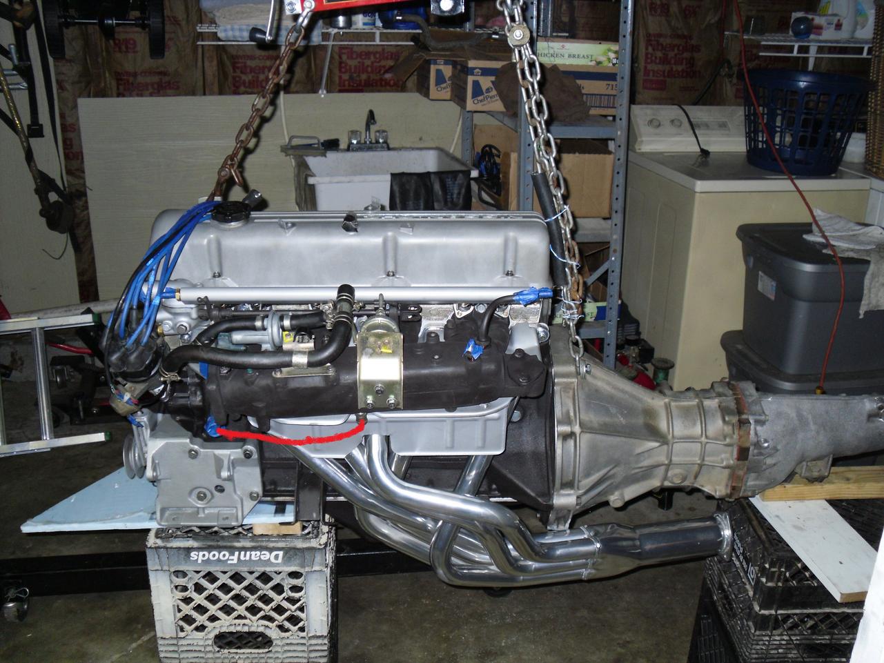

I have seen that set-up used before as well. The ZX FPR has 1 inlet and 1 outlet and works well at the end of a single rail system.
I was thinking of going this route as well by making one out of 3/4" and TIG welding the tie-ins for the injectors. Polished or water blasted it would look nice, simple and clean up that side of the engine.
It on my "to do list". So many thing, so little time;)
Chas

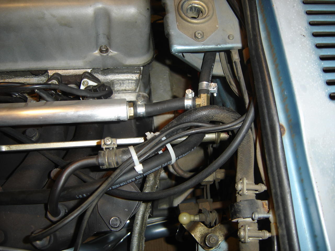

When all is the way it is supposed to be it will run very well without adding extra cooling fans or higher fuel pressure. If it is running rough at restart something is wrong. Make sure the fuel pressure is correct and the fpr is letting the excess fuel return back to the fuel tank( and there should be fuel returning). If the fuel is vaporizing then it is running too hot because when everything is normal this will not happen. You can try pulling out the fuel rail with the injectors and placing the rail into a large pan and crank the engine untill full pressure is reached. While doing this make absolutely sure that there is no source of ignition or you will start a fire. Check the spray pattern while you are at it and then make sure the injectors are holding pressure and not leaking down. Just because they were replaced does not mean that they may still have an issue. I also noted that you put grease or oil on the orings be careful what you use because some greases will attack the rubber.
So you have a straight-shot fuel rail. Do you have the hot start/heat soak problem?
I've never had that problem before. Actually the fuel rail feels cool to the touch when it's idling, cost $50 to make.
Well, there's one data point for purging the fuel rail, maybe. What brand of injector are you using?
And, do you have the stock exhaust manifold or headers? I have another theory about where the heat comes from.
A good poll would probably shed some light on the heat soak problem.
New Standard FJ707T injectors, $30 at amazon.com, ceramic coated 6 into 1 header with OE heat shields. Horizontal shield and the vertical one too, had to trim it for the header runners. Also have a vented hood. 1/2" in and out of the rail, 5/16" to the injectors.
