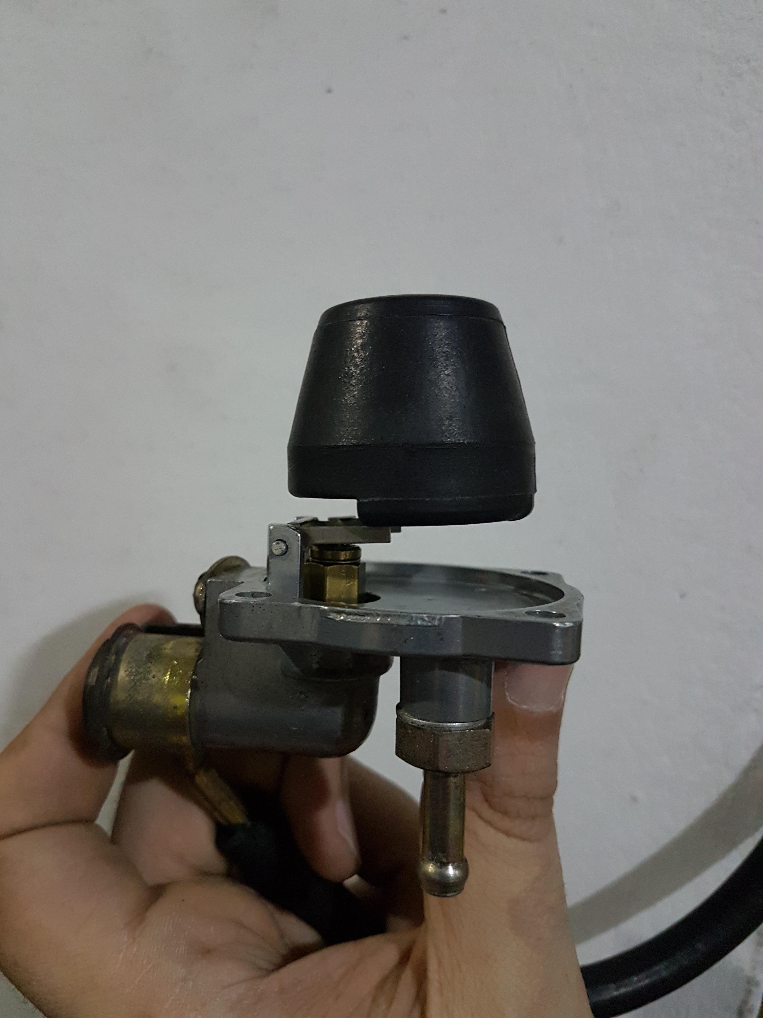

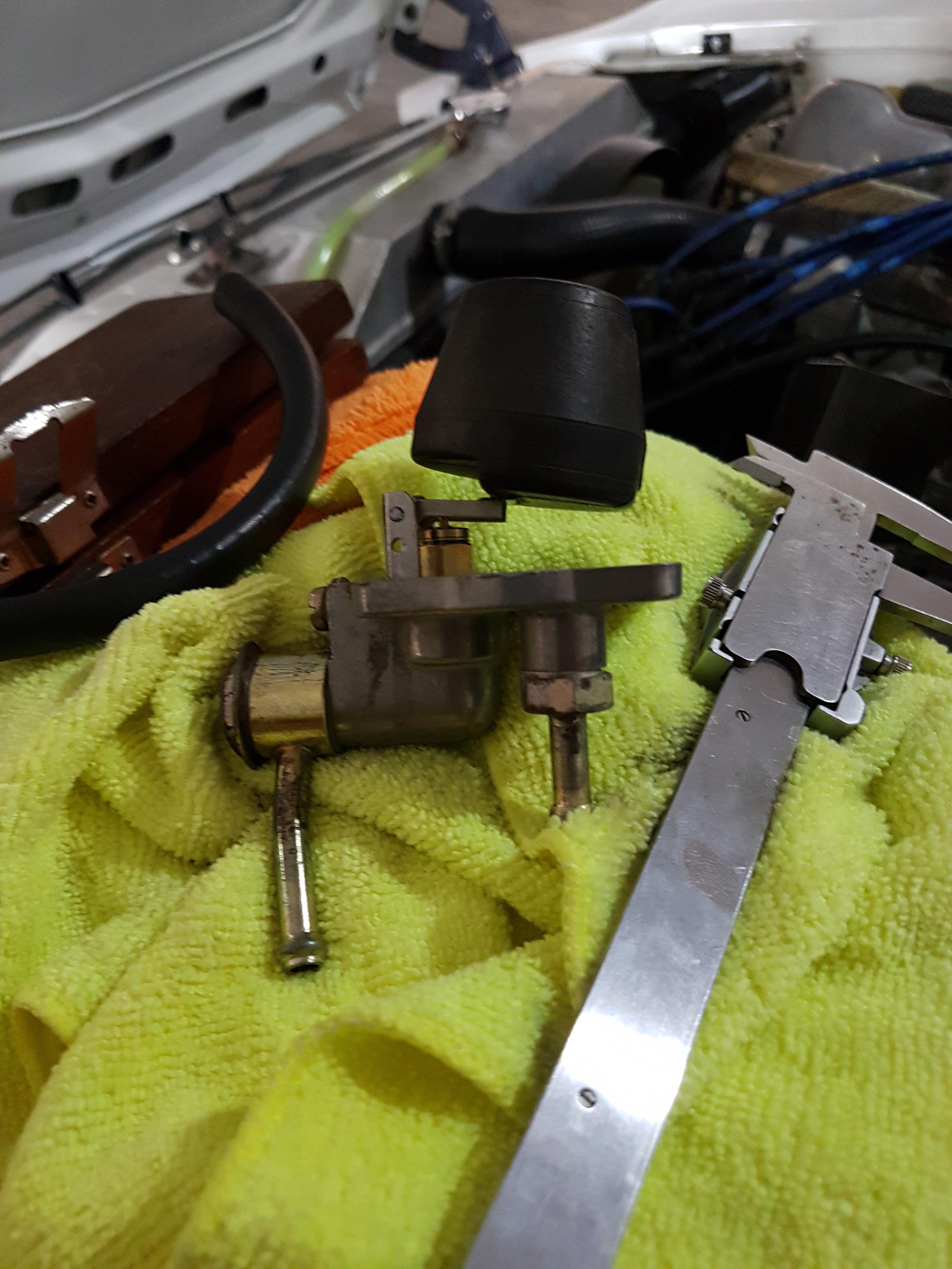

Well, what do you expect and please tell us why you are evening showing photos of the inverted float position.  Like we have been saying, it means nothing as the parts are NOT the same as when that method had any validity, if ever.  I can tell you that with the float that high off the lid, when inverted, you are not even close.  Really, you need to listen to everyone and simple adjust to 1/16" below top of nozzle at 2.5 turns down.  Start with the float just off the lid...maybe 1/8" and go from there.  As before, I suggest you remove the sealing washer between the needle valve body and lid.
 I agree with David. That float is set too lean. Bend the float tab so the float sits a bit closer to the lid. Install the lid, fire the engine up (no need to drive it), shut it down and pull the domes and pistons and look at the fuel level in the nozzles. Be sure to do the drop test on the pistons when it's reassembled to be sure nothing is binding. .
 I'd like to congratulate you. Good to see the parts in your hand rather than a mechanic's verbal description. Keep up the good work.
Finally set accordingly. Ready to drive the car and report back
 Good job. That looks closer to the proper angle. Drive it a bit and let us know how the engine feels, cold and hot. Are the mixture screws set to 2 1/2 turns? In the report be sure to tell us where the fuel levels are in the nozzles.
