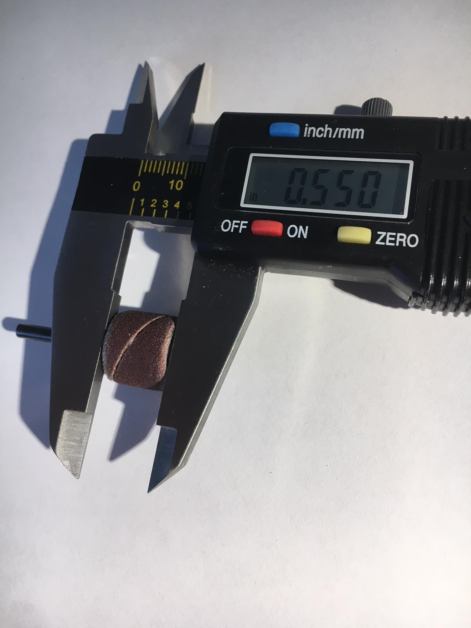

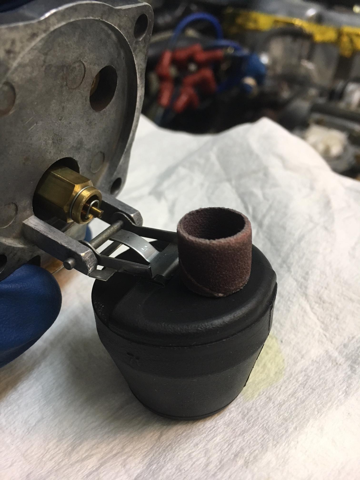

Hi JALEX:
Here is a simple way that I set the .55" on my float tabs. Make or find something that is .55" that will sit on top of the float. You can use a wooden dowel rod that you cut down and sand it to exactly .55". I happen to have a sanding drum attachment for my Dremel moto-tool that just happens to measure .55".
1. Place your .55" object on top of the float
2. Raise up the float until the .55" object contact the underside of the cover. You are now exactly at .55"
3. Blow on the fuel inlet pipe.
4. If your breath circulates then the float tang is not pushing the pin and you have to adjust it up to push the pin. (i.e. stop fuel flow at .55")
5. If your breath stops and you can't blow that is good. HOWEVER you must ensure float tang is not bent too far up (i.e. pushing the pin to far in at .55"). You want your breath (fuel) to stop at exactly .55".
6. All of this is performed with the float right side up-exactly like it would be when installed on your carb. Forget the upside down stuff.
7. You also need to fix your float tab angle first. I haven't adjusted my rear carb. float tab yet and it is like a ramp. It should be like a speed bump

12 minutes ago, 882993md said:
Hi JALEX:
7. You also need to fix your float tab angle first. I haven't adjusted my rear carb. float tab yet and they are like ramps. They should be like speed bumps @siteunseen
Your explanation is as clear as water. Best in all. Ill use a 9/16 drill bit.
