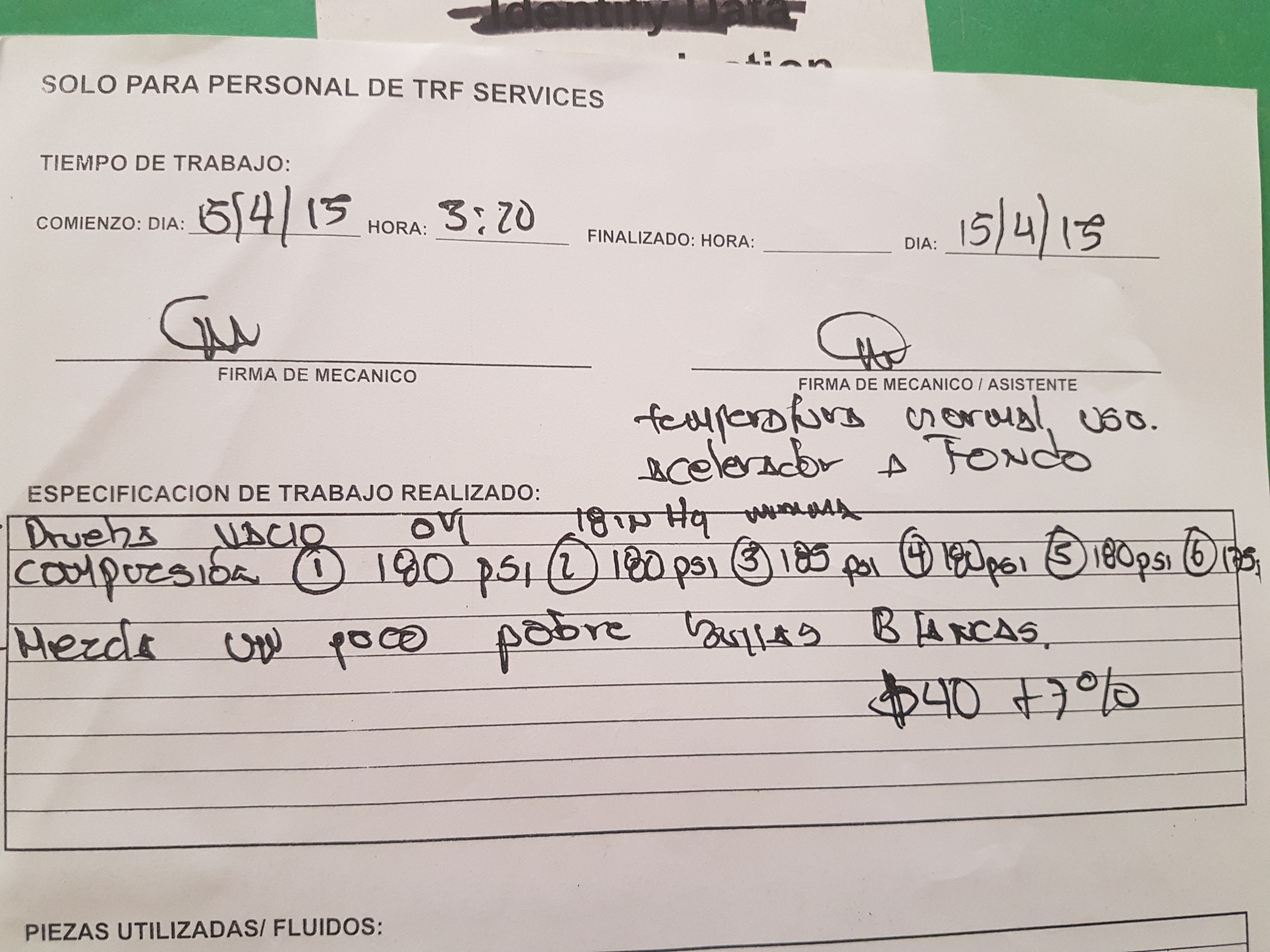

jalexquijano Posted April 3, 2018 Share #476 Posted April 3, 2018 28 minutes ago, Mark Maras said: @jalexquijano Sure give it a try. Be sure to report back. Inquiring minds, want to know. Found the compression test done in 2015 here in Panama. Link to comment Share on other sites More sharing options...
siteunseen Posted April 3, 2018 Share #477 Posted April 3, 2018 (edited) Is #6 135 or 185? Hard to tell from here. I'm sure it's 185, well pretty sure and those are great readings. I feel like you have the main problem resolved, getting the floats right. You owe Mark a big ole THANK YOU. Just know that you need to baby it until it reaches temp. No need for full choke until then though. It'll spit and sputter with full choke while driving. My suggestion is run full choke before getting on the road, you'll be able to look at the motor while it gets warm. Check for leaks and just a good overall inspection before running it up to 110mph. How are your brakes by the way? Can't remember you talking about them in the past. You don't want any supplies-es at 110! You know Ed Zachery what I mean. We want you to be around for the 2020 Erection. @psdenno Edited April 3, 2018 by siteunseen 2 Link to comment Share on other sites More sharing options...
jalexquijano Posted April 4, 2018 Share #478 Posted April 4, 2018 (edited) 22 hours ago, siteunseen said: Is #6 135 or 185? Hard to tell from here. I'm sure it's 185, well pretty sure and those are great readings. I feel like you have the main problem resolved, getting the floats right. You owe Mark a big ole THANK YOU. Just know that you need to baby it until it reaches temp. No need for full choke until then though. It'll spit and sputter with full choke while driving. My suggestion is run full choke before getting on the road, you'll be able to look at the motor while it gets warm. Check for leaks and just a good overall inspection before running it up to 110mph. How are your brakes by the way? Can't remember you talking about them in the past. You don't want any supplies-es at 110! You know Ed Zachery what I mean. We want you to be around for the 2020 Erection. @psdenno How much time with full choke until driving? Number 6 is 175 Edited April 4, 2018 by jalexquijano Link to comment Share on other sites More sharing options...

siteunseen Posted April 4, 2018 Share #480 Posted April 4, 2018 (edited) 4 hours ago, jalexquijano said: Number 6 is 175 Good numbers! Thanks for the reply. Another reason for not "nailing" one when it's not up to temp is the coolant doesn't circulate as well until the thermostat fully opens. Edited April 4, 2018 by siteunseen Link to comment Share on other sites More sharing options...
