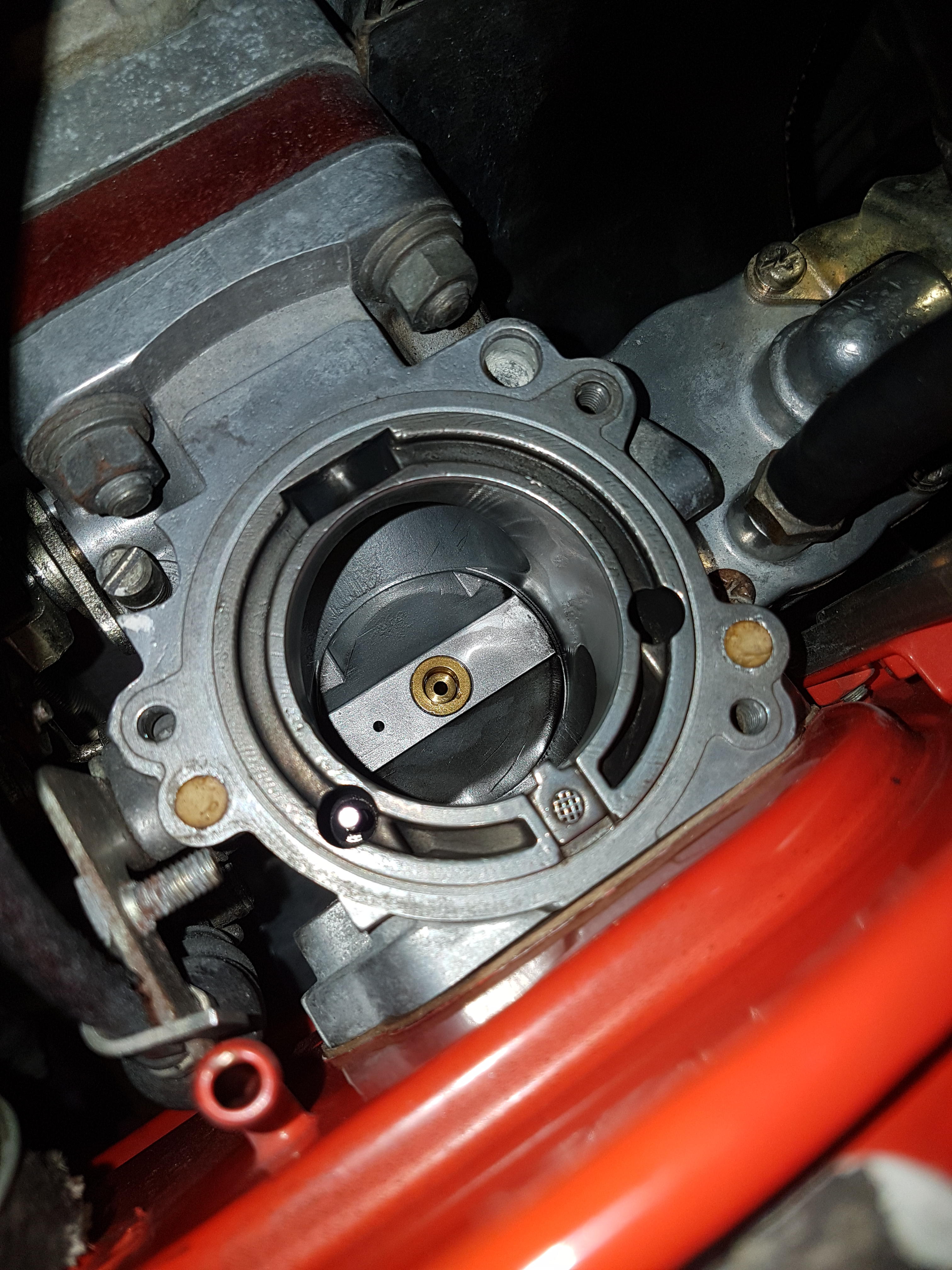

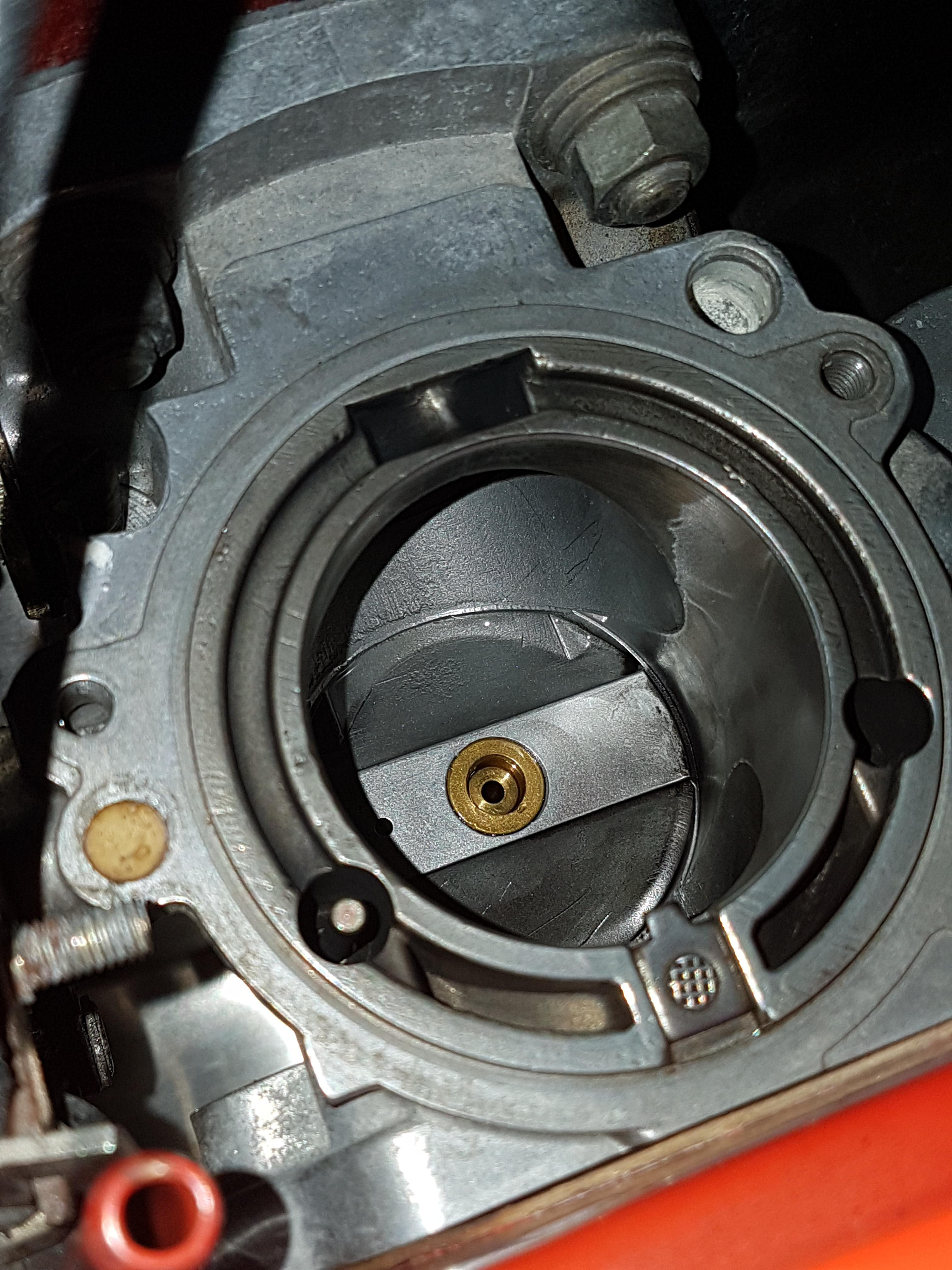

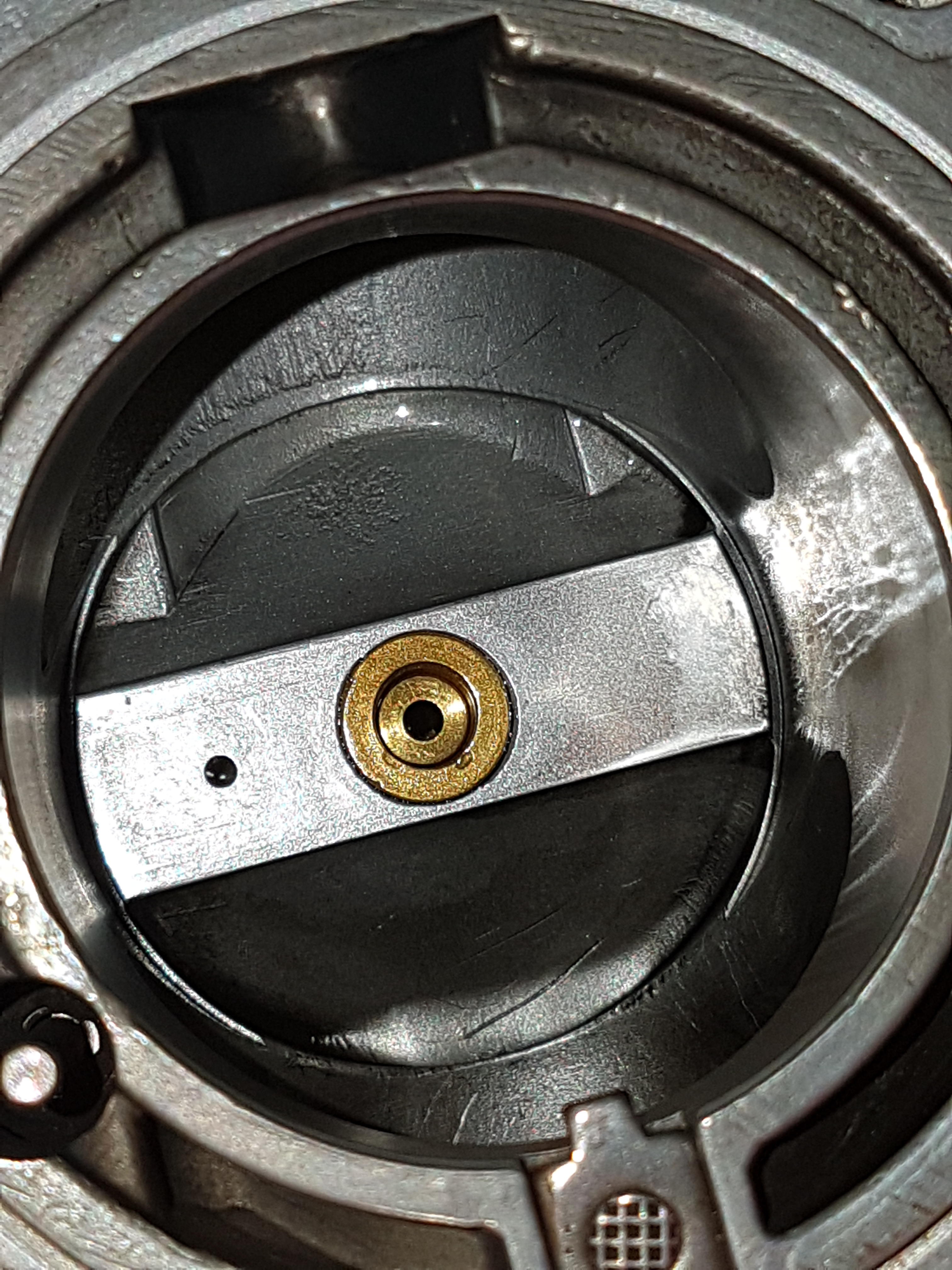

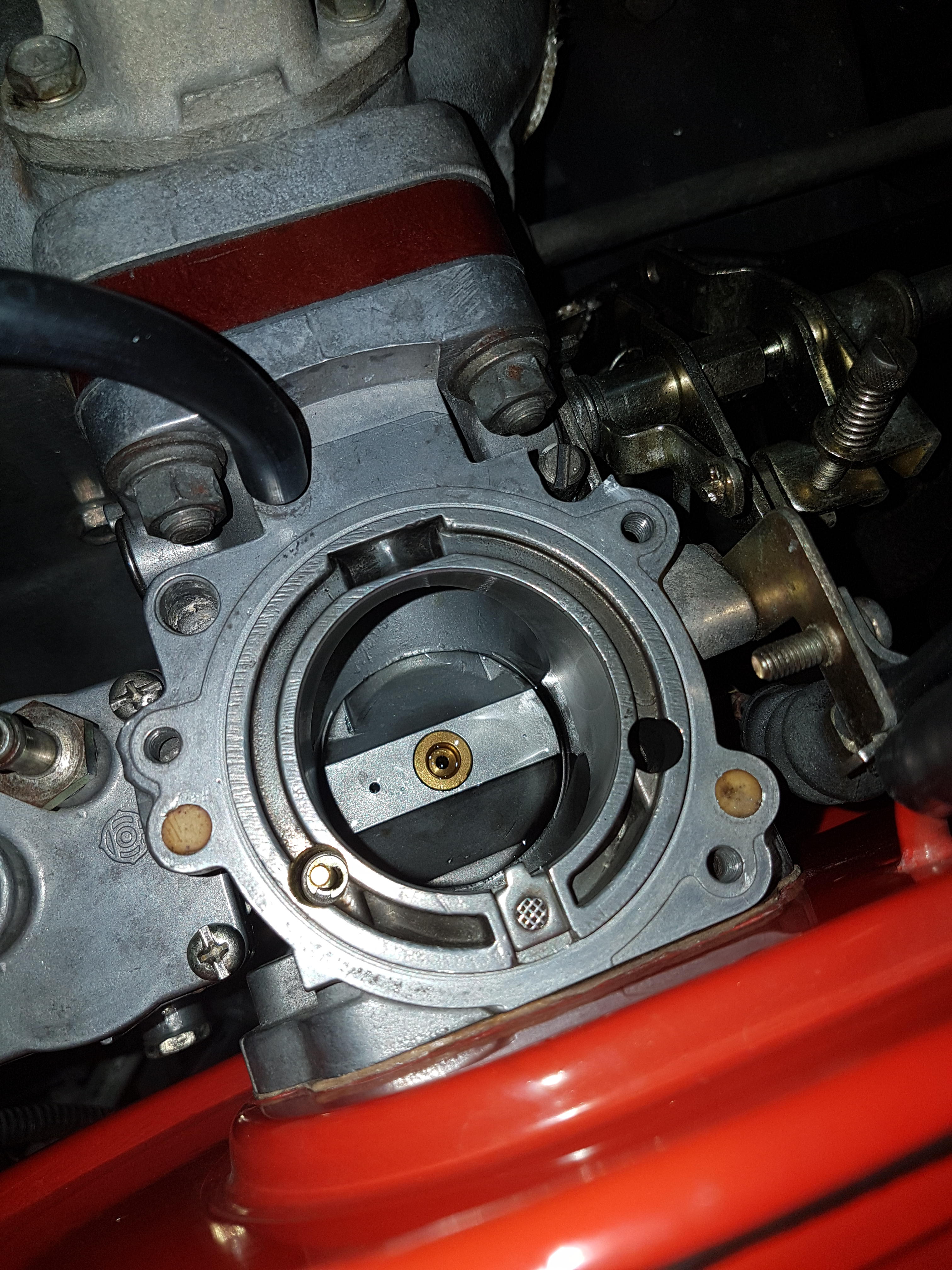

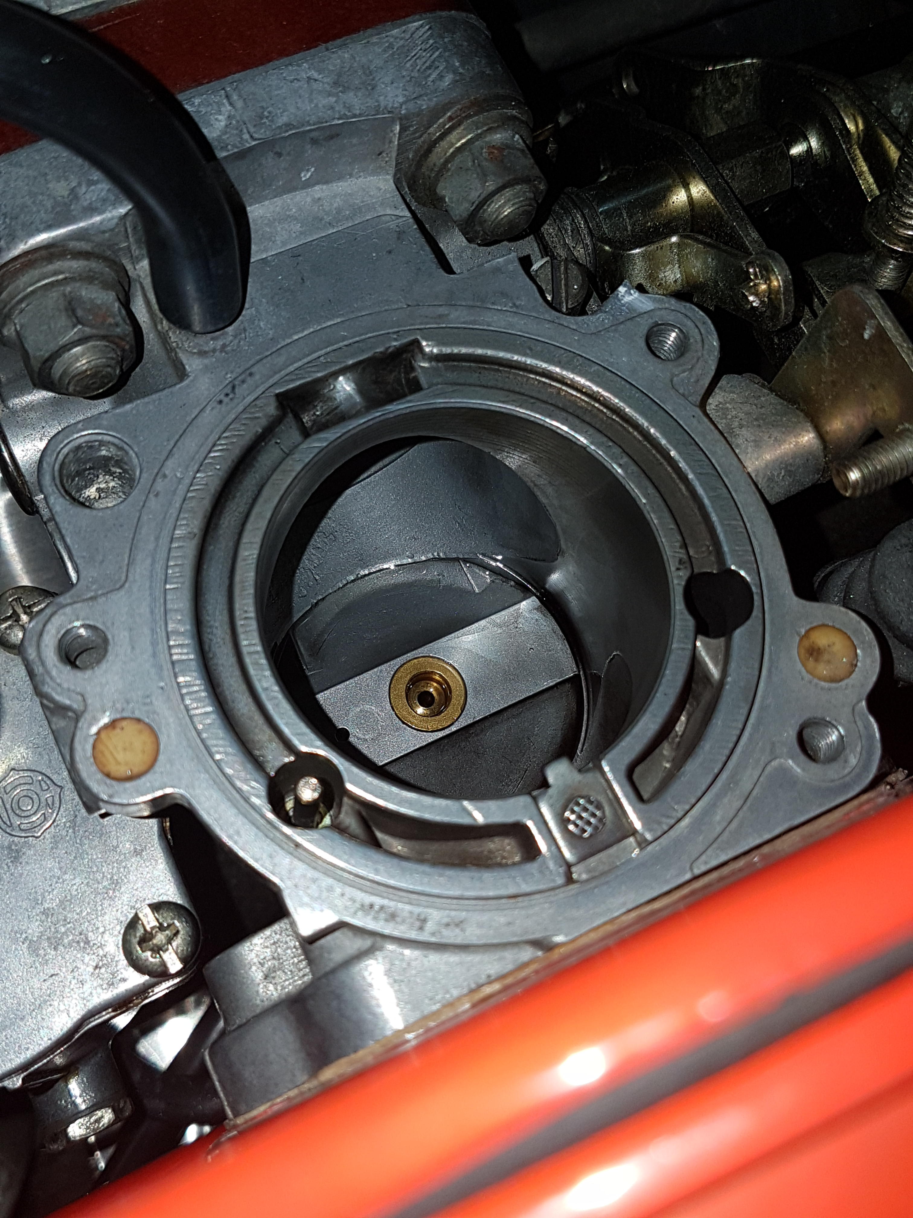

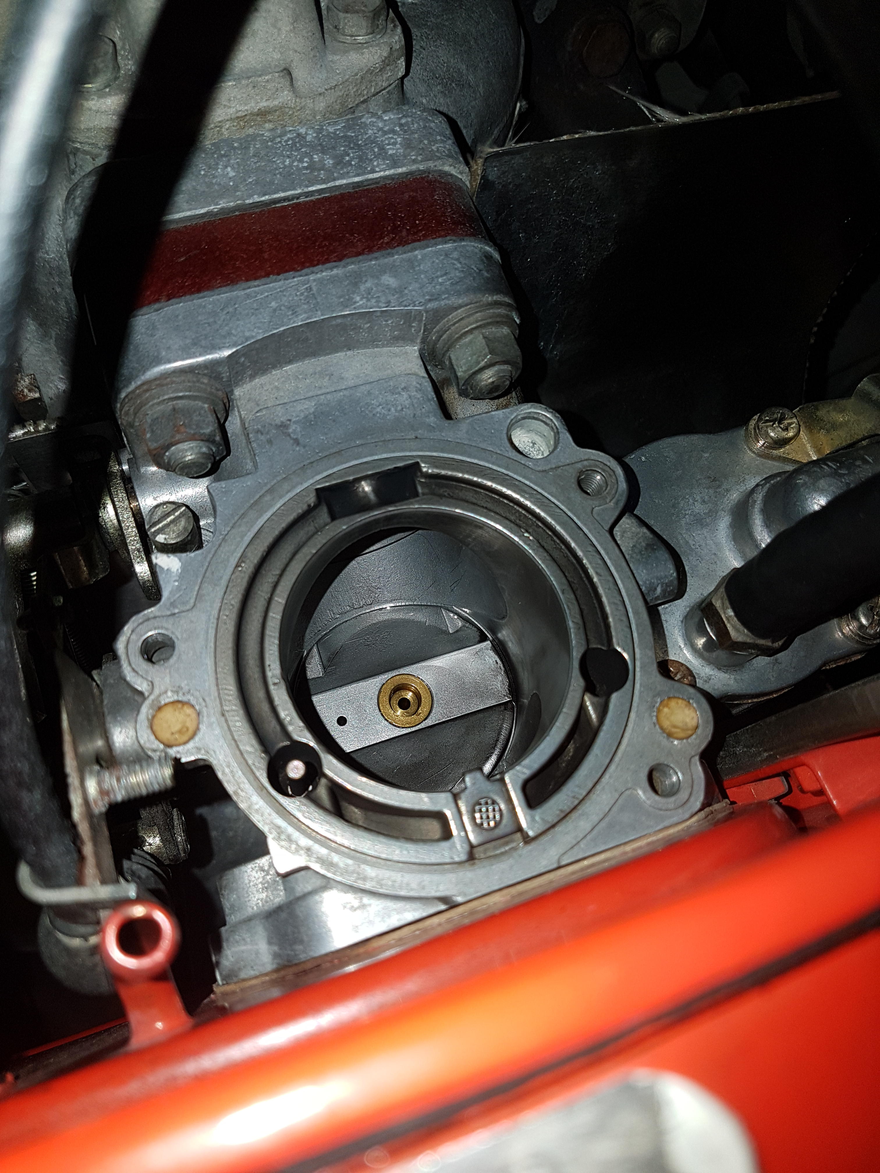

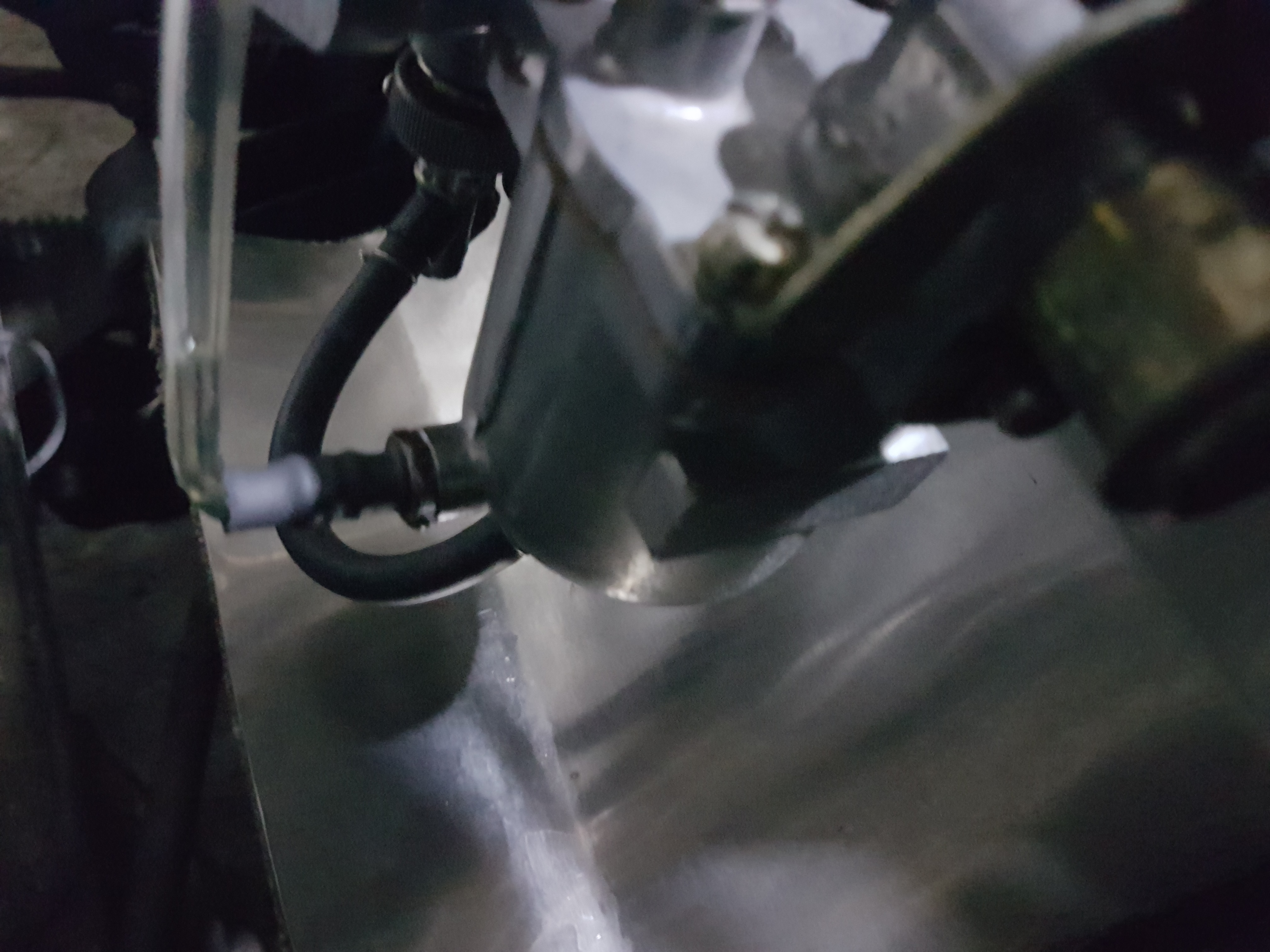

March 19, 20187 yr comment_544936 On 17/3/2018 at 1:17 PM, Mark Maras said: @jalexquijano Where are your mixture screws now and how is it running? rear and front carbs at 3.5 turns clockwise. Should i keep on closing the gap between the float and lid by bending the tang a little more? First 3 pictures are related to the rear carb, the last 2 to the front carb. Edited March 19, 20187 yr by jalexquijano Link to comment https://www.classiczcars.com/forums/topic/47304-1972-float-adjustment/?&page=30#findComment-544936 Share on other sites More sharing options...

March 19, 20187 yr comment_544973 The front carb looks right to me considering they're 3.5 turns down and he's telling you 2.5 turns down. I see a little overflow that would go away at 2.5. Link to comment https://www.classiczcars.com/forums/topic/47304-1972-float-adjustment/?&page=30#findComment-544973 Share on other sites More sharing options...

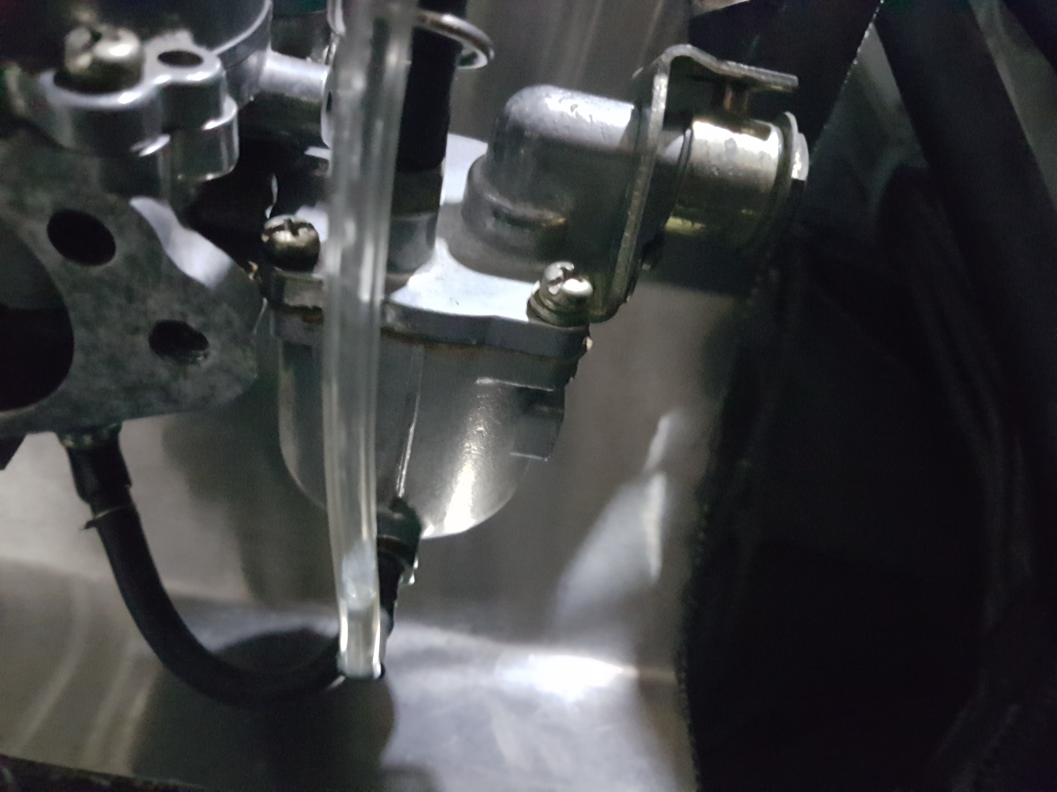

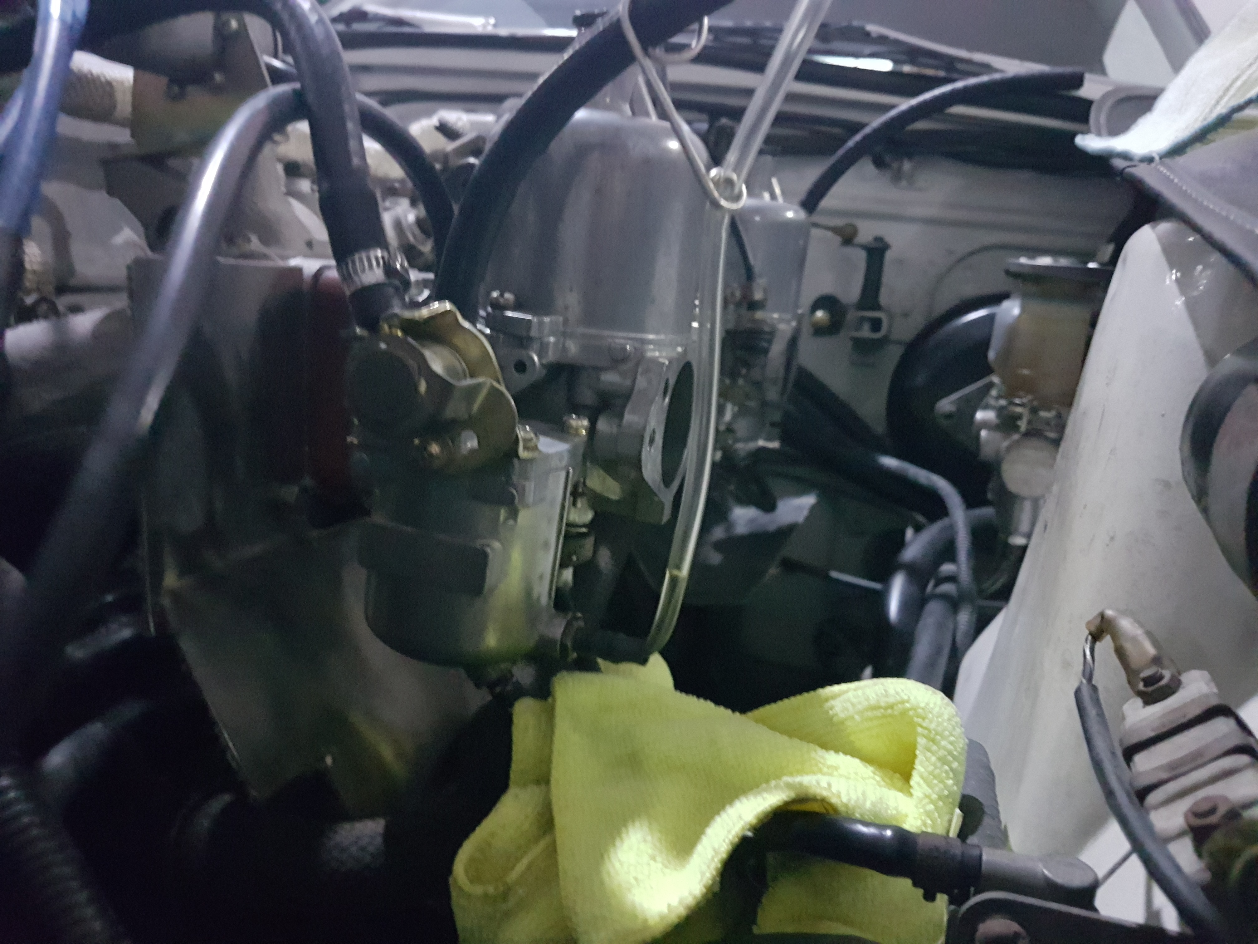

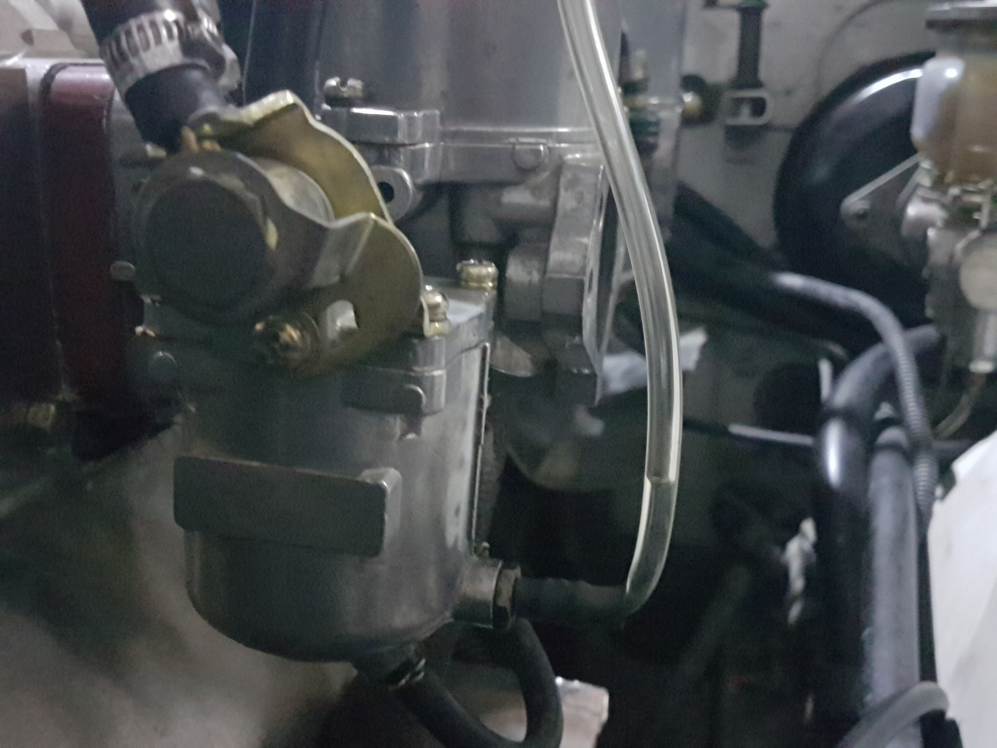

March 19, 20187 yr comment_544975 4 minutes ago, siteunseen said: The front carb looks right to me considering they're 3.5 turns down and he's telling you 2.5 turns down. I see a little overflow that would go away at 2.5. This is a picture of the level using clear sight tubes for the front carb. Link to comment https://www.classiczcars.com/forums/topic/47304-1972-float-adjustment/?&page=30#findComment-544975 Share on other sites More sharing options...
March 19, 20187 yr comment_544978 Me thinks you got that one, congratulations. I would put that one to bed, in the winner's box, knocked out, homerun, touchdown!  Link to comment https://www.classiczcars.com/forums/topic/47304-1972-float-adjustment/?&page=30#findComment-544978 Share on other sites More sharing options...

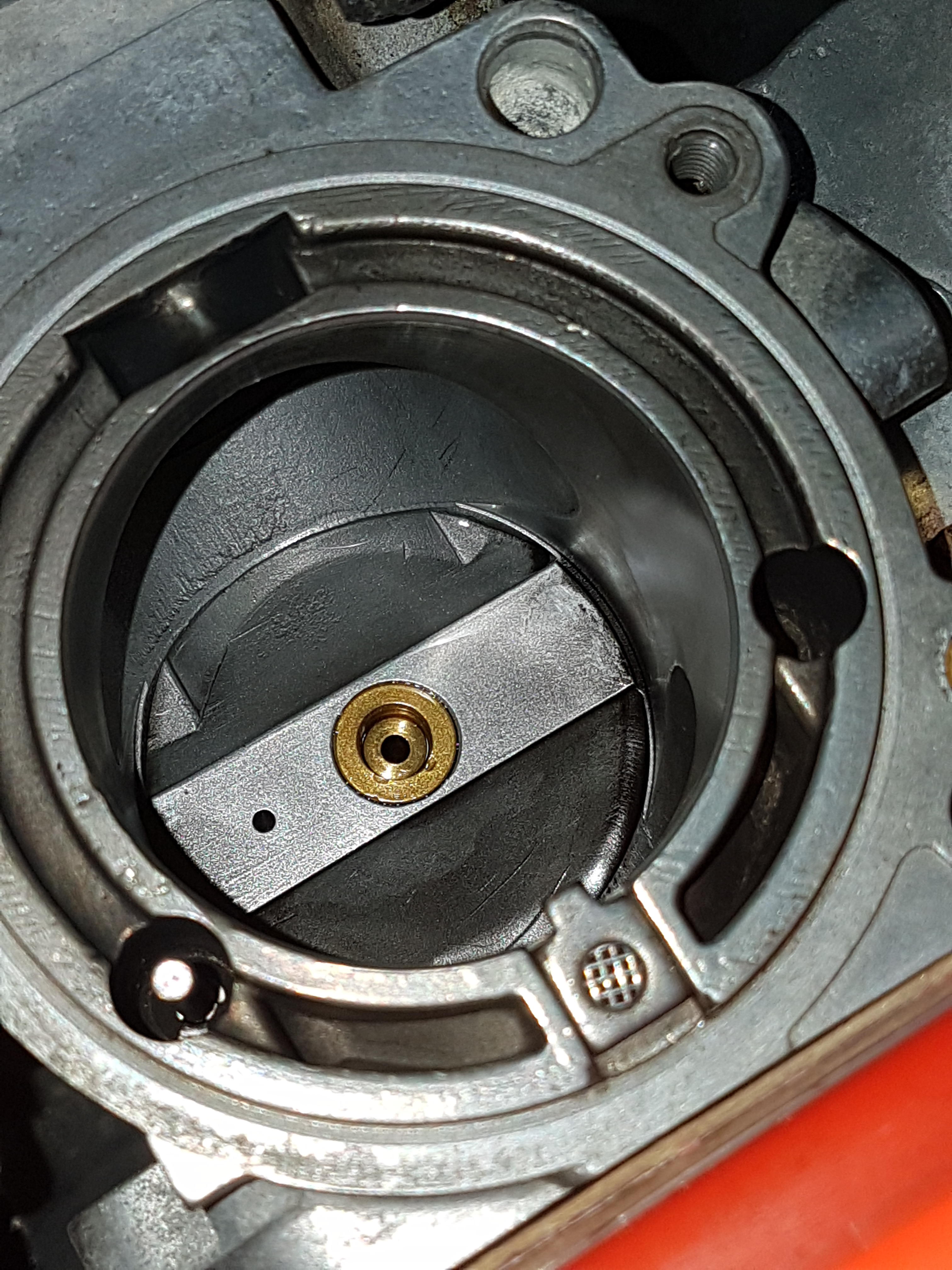

March 19, 20187 yr comment_544984 17 minutes ago, siteunseen said: Me thinks you got that one, congratulations. I would put that one to bed, in the winner's box, knocked out, homerun, touchdown!  Now this is the rear one at idle which i think still needs more bending of the tang. However i could be wrong. Link to comment https://www.classiczcars.com/forums/topic/47304-1972-float-adjustment/?&page=30#findComment-544984 Share on other sites More sharing options...
March 19, 20187 yr comment_544985 Looks low to me but it's hard to tell looking at pictures of that one but if you're at 3.5 turns down there should be visible fuel on top of the nozzle. Link to comment https://www.classiczcars.com/forums/topic/47304-1972-float-adjustment/?&page=30#findComment-544985 Share on other sites More sharing options...

March 19, 20187 yr comment_545006 @jalexquijano I agree with Cliff. Raise the fuel level in the rear carb to the same level as the front carb. Reset the mixture screws to 2 1/2 turns, check to be sure that fuel isn't pooling on top of the nozzles and drive it. When the engine is warm, if the engine seems like it lacks power under acceleration, SLOWLYÂ pull the choke while accelerating. If the fuel mixture was too lean, adding choke will richen up the mixture and you'll feel the performance boost under acceleration. If adding a little choke improves performance, drop the mixture screws 1/2 turn and try it again. @siteunseen Tick tock, tick tock! Time keeps on slip'n, slip'n, slip'n, into the future. Fly like an eagle. Link to comment https://www.classiczcars.com/forums/topic/47304-1972-float-adjustment/?&page=30#findComment-545006 Share on other sites More sharing options...
March 19, 20187 yr comment_545023 So should i take out the rear float lid and bend the tang some more narrowing the gap between the float lid and the float? Link to comment https://www.classiczcars.com/forums/topic/47304-1972-float-adjustment/?&page=30#findComment-545023 Share on other sites More sharing options...
March 19, 20187 yr comment_545024 Â Yes. Then start it up, shut it down and check the fuel levels again in both carbs at 2 1/2 turns to be sure the fuel level isn't too high and pooling on top of the nozzles. Link to comment https://www.classiczcars.com/forums/topic/47304-1972-float-adjustment/?&page=30#findComment-545024 Share on other sites More sharing options...
