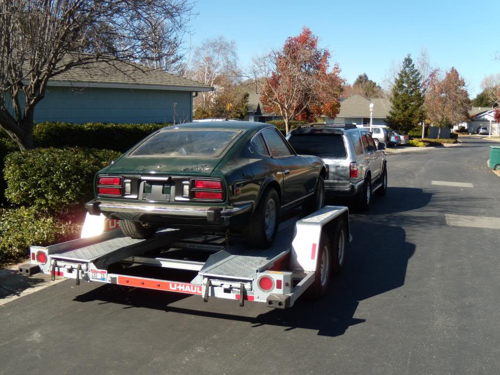

I towed my 240Z about 180 miles home using a car dolly and my 1997 Nissan truck (4 cylinder, automatic):
http://www.classiczcars.com/forums/members/ehlersrs-albums-1971-datsun-240z-picture53969-took-several-attempts-line-car-up-car-dolly.html

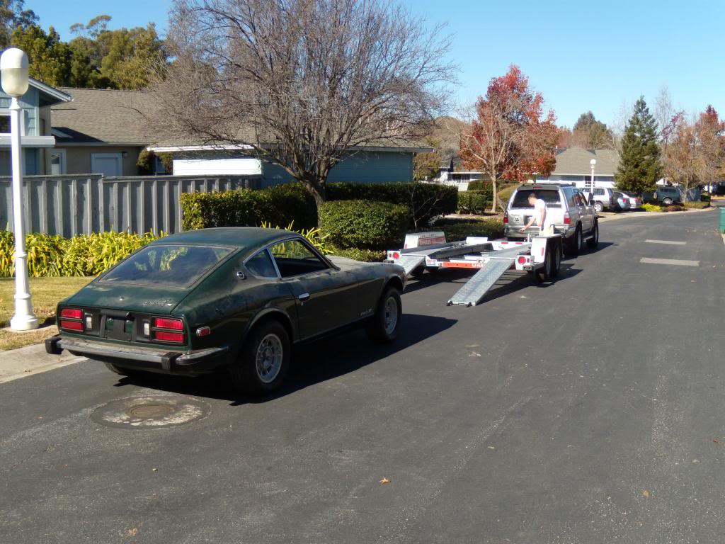

The car was located in the owner's garage at the end of the smooth driveway. Since the car wasn't running, we pushed the car up onto the car dolly. The long driveway allowed us to pick up momentum to get the car up and it did take several attempts to get the car on straight. My truck weighs approximately 2900 lbs (with the topper) and it has a Class II hitch mounted to the frame. I estimate the trailer weighed 500 lbs and the 240Z weighs around 2300 lbs. The bed of the truck was also loaded with car parts that weighed maybe 200 lbs. That comes to a vehicle weighing 3100 lbs. and a towing weight of 2800 lbs. I didn't have any problems getting back home, except my truck had difficulty making it up several hills on the interstate and that was with the gas pedal to the floor! My truck hasn't had any problems towing over a ton of weight before, so I figured it could handle towing the 240Z.
For your situation, 20 miles isn't that far to tow a vehicle. I would be extra cautious about towing the 240Z with a light car, however with the engine and tranny removed, that does remove a lot of weight from the 240Z. It would be better to find someone that has a bigger vehicle, but if you decide to use your car and a dolly, be sure to take a route where you can travel at slower speeds and leave lots of extra space for stopping. Do you plan to borrow the car dolly? I'm sure UHaul won't rent a car dolly to you if they knew what the towing combination was going to be. I rented a car dolly from a local guy who rents it out, because I'm sure UHaul wouldn't have approved of my truck. As for getting the car onto the dolly, if it's located on a smooth surface, you shouldn't have any problems pushing it on otherwise you can use a come along, which will take longer. Even without the bumper, there should be a place to connect the come along. Besides, it's just a parts car!

You're thinking too hard. Two guys can push a Z up onto a dolly/trailer easily, especially one without an engine. It helps to have someone in the car in case steering adjustment is needed. ;)
Thats the way i hauled my non-running Z. It even had seized rear brakes and we still managed to push it all the way up to trailer. For 400 miles i saw this beauty staring at me from rearview mirror. LOL
