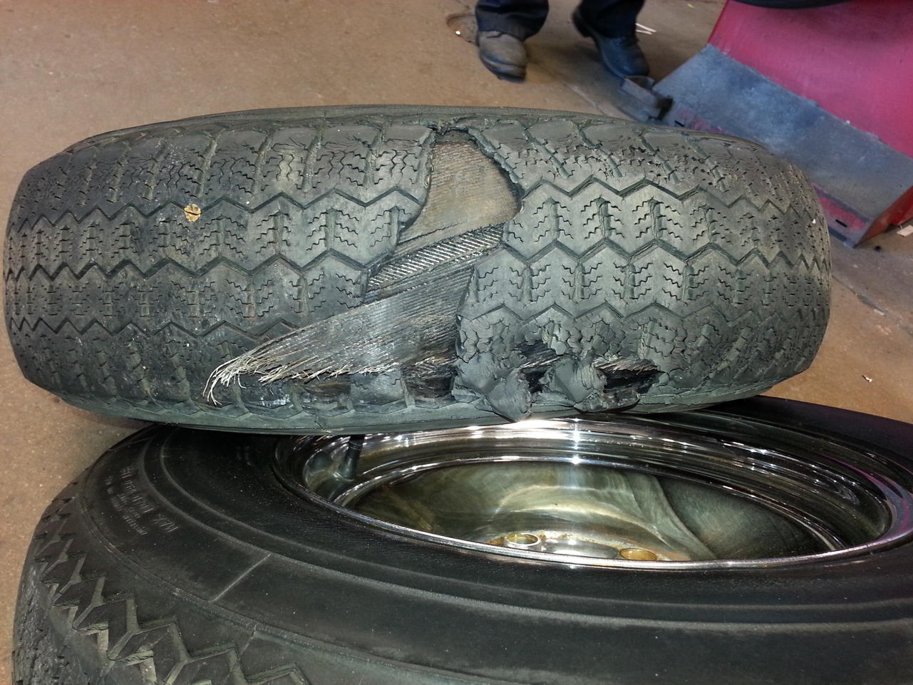

The car and I made the 150 mile drive home from the PO's house, despite tires so old they didn't have a DOT code that I could read. I drove the car all of three times on short trips around town before the left rear tire finally gave up. As I've mentioned in another thread, this happened during my girlfriend's first ride in the car :)
The tire shop dated these to roughly 1985!

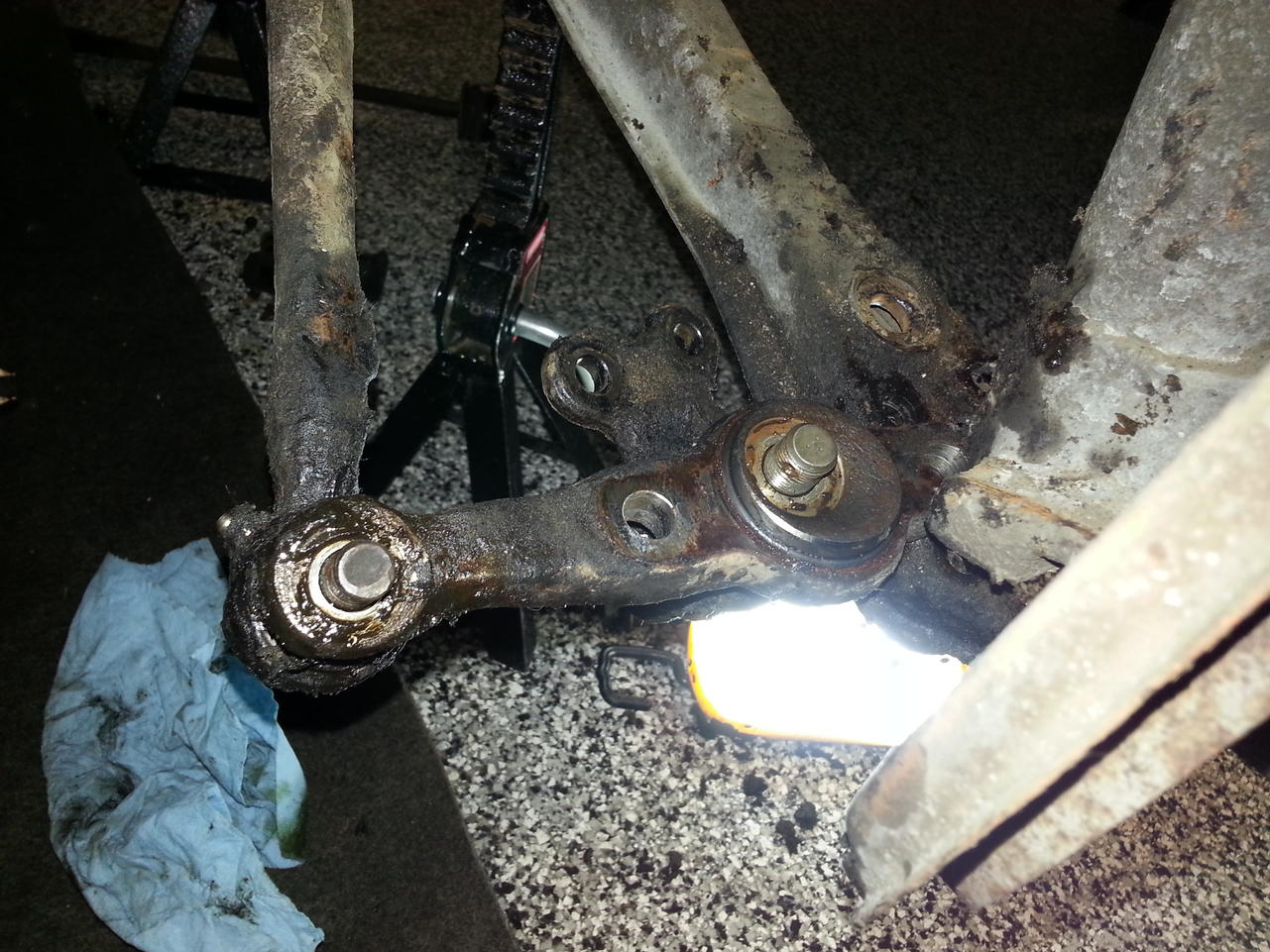

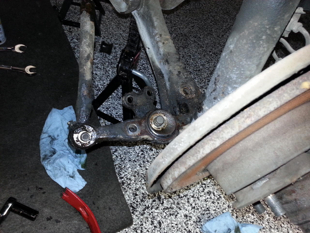

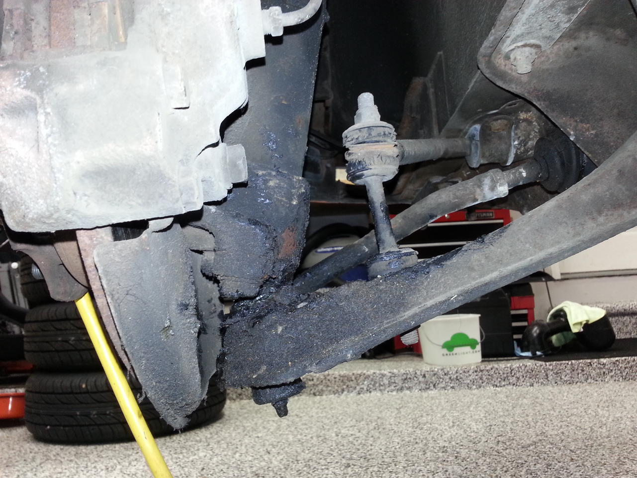

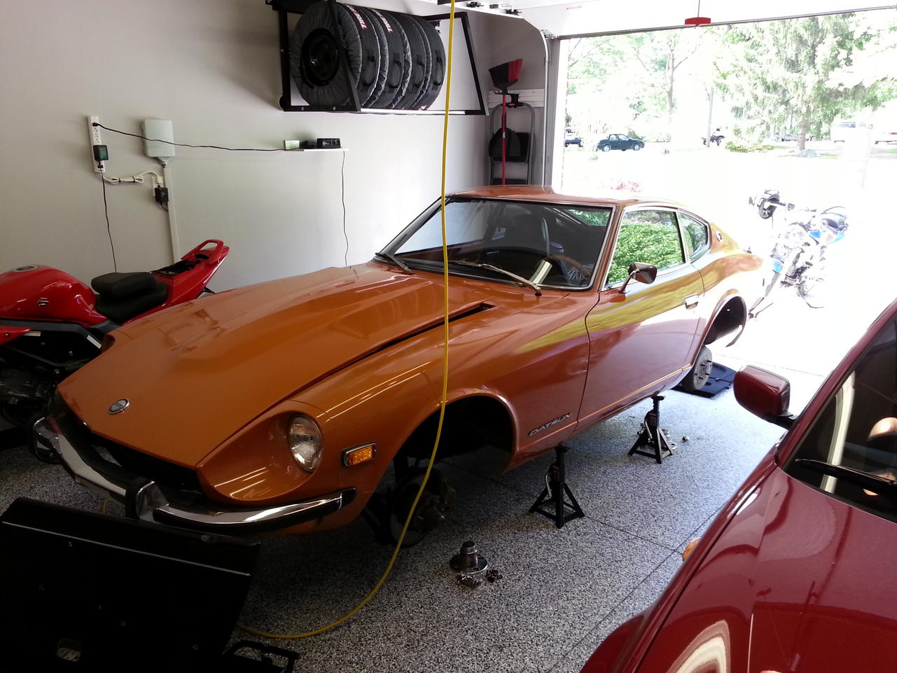

So the car went up on jackstands so I could get new tires and troubleshoot the ignition.

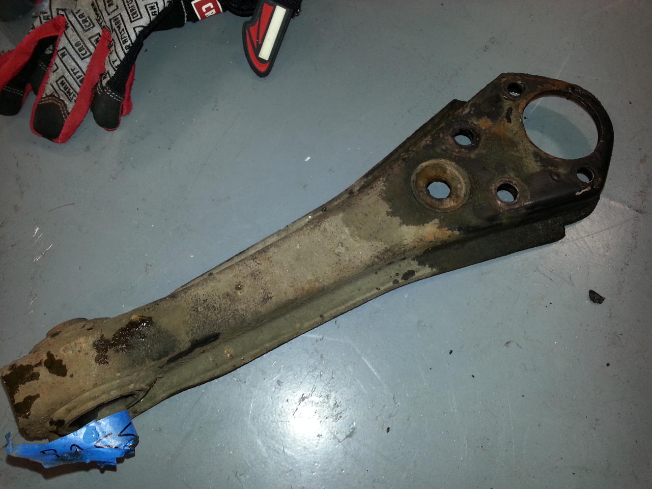

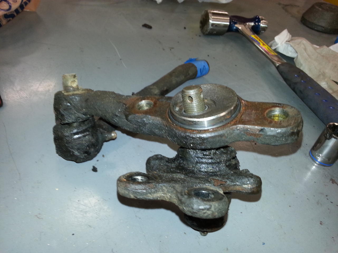

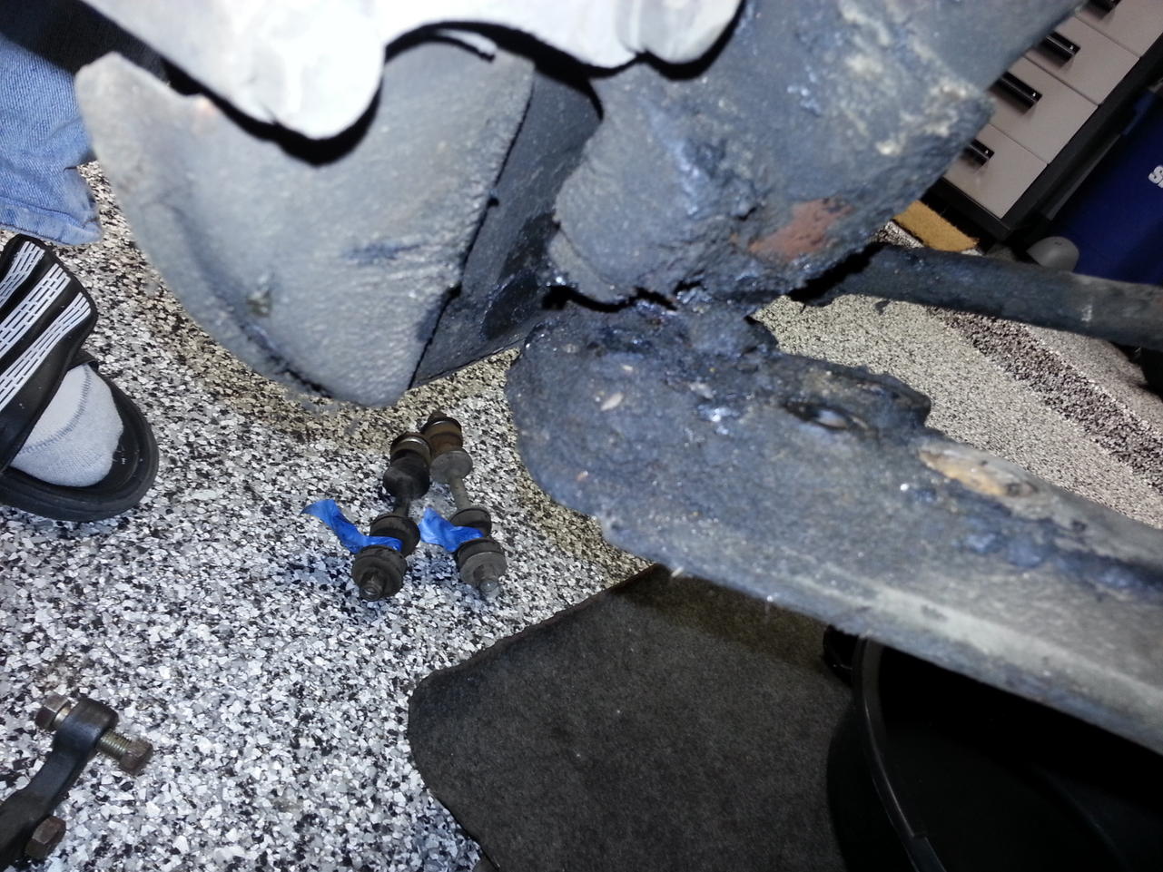

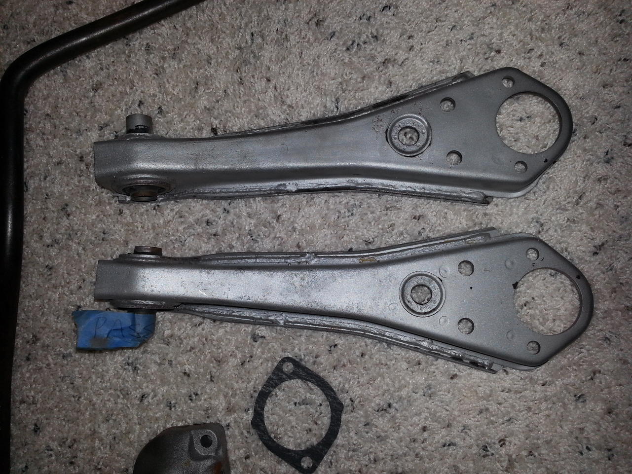

With the car up in the air I got to see just how much work I get to look forward to! The bushings are cooked, the ball joint and tie rod end boots are ruptured and dumping grease everywhere, and the steering gear bushings fell apart when I removed them. I couldn't get the joints separated so I took the whole filthy assembly to a friend's shop for separating and cleaning. These pics were taken after I'd already removed a third of a pound of gluey old ball joint grease from the joints.

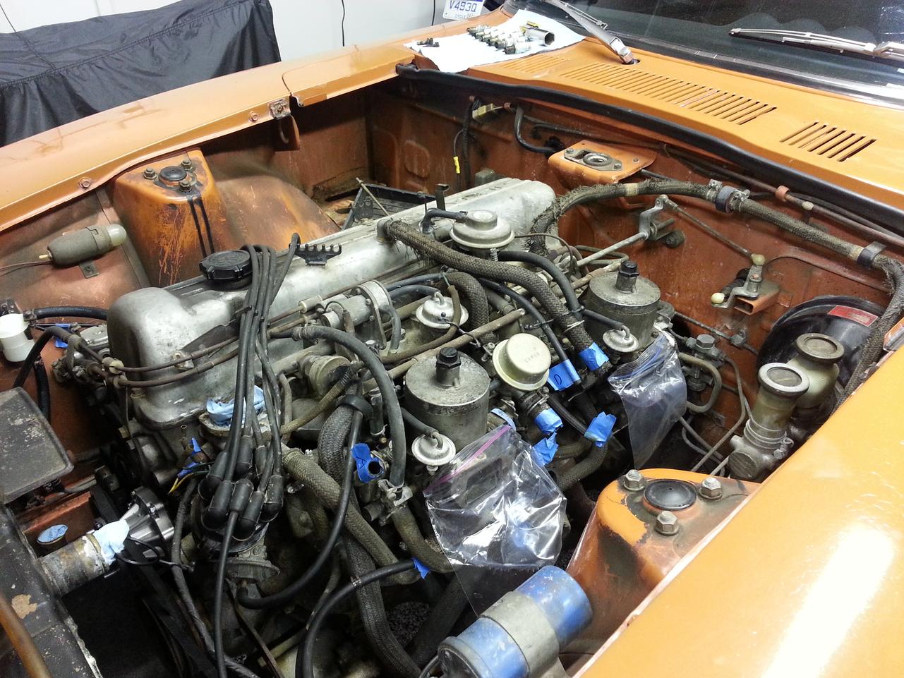

Rich, you're right, the PO didn't mess with it hardly at all. He seems to have taken great care of the car but I don't think he was particularly mechanically inclined so he didn't mess with it or install aftermarket parts. You're also right that my opinion of the flat tops has been colored by what I've read here as well as input from a local Datsun shop and ZTherapy (which must be taken with a grain of salt since they're trying to sell a non-flat top product). But also, the car runs pretty terribly and definitely exhibits the difficultly with warm starts that I've learned is common with the flat tops. The carbs need an overhaul, and I'm not sure whether to refurb the flat tops or change over to SUs. I didn't go into this intending to keep a very original car but given this one's condition it doesn't seem right to mess up too much.

Re: flat tops and smog, just look at this mess. Wouldn't you rather have a shiny set of properly sorted ZT SUs sitting in there without all that other nonsense?

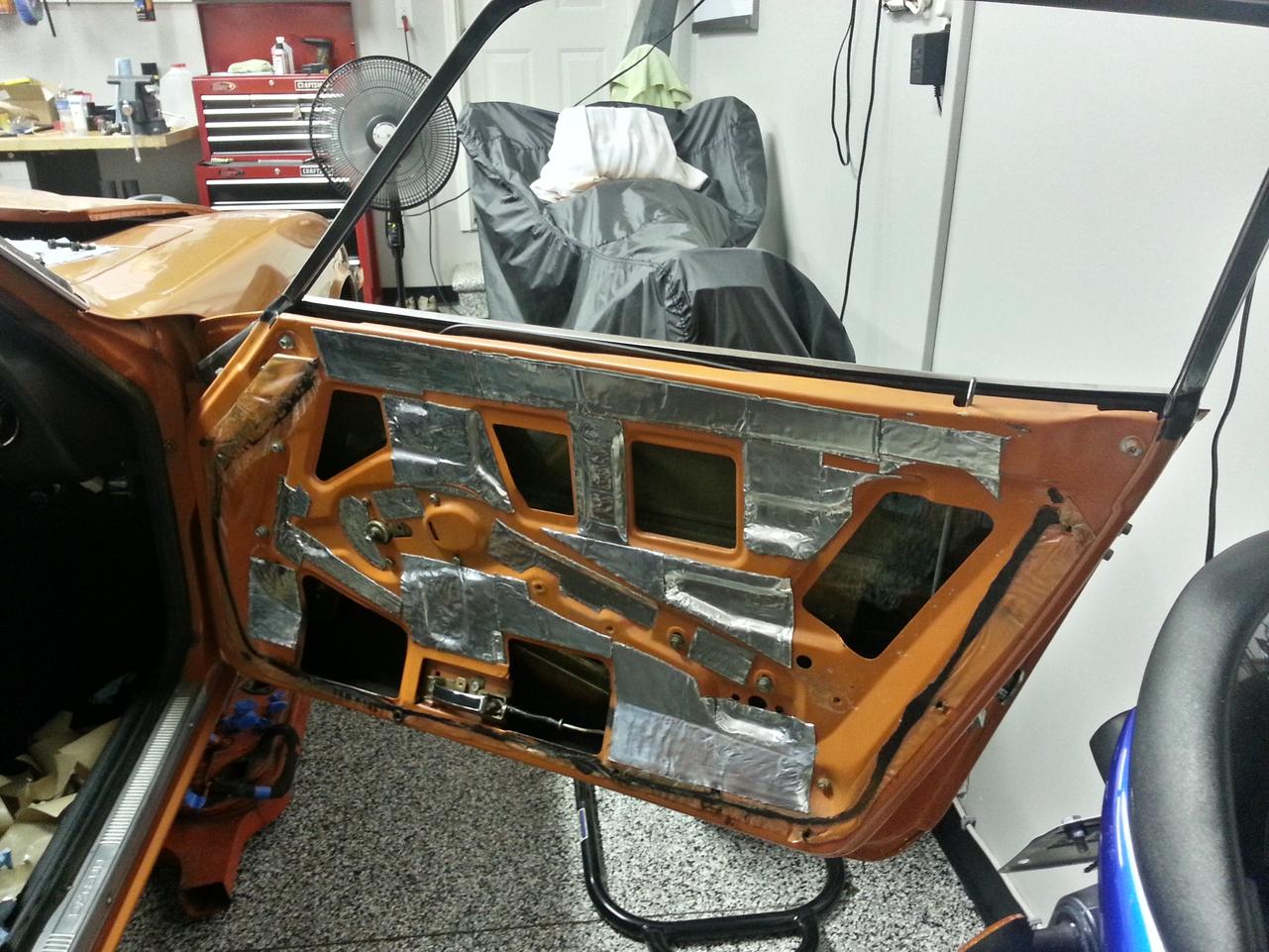

I'm lucky to have a facility nearby that allows all kinds of DIY machining and fab work. I'm trying to get in to use their powder coater for my front suspension but there's a long wait to take the certification course. So the suspension has been apart for weeks. In the meantime I've been working on the interior. The passenger window wasn't working well and the driver side lock wasn't working so I removed the trim panels and poked around inside the doors. I was able to fix both issues and added a bunch of RAAMmat (Dynamat type stuff) to the door panels.

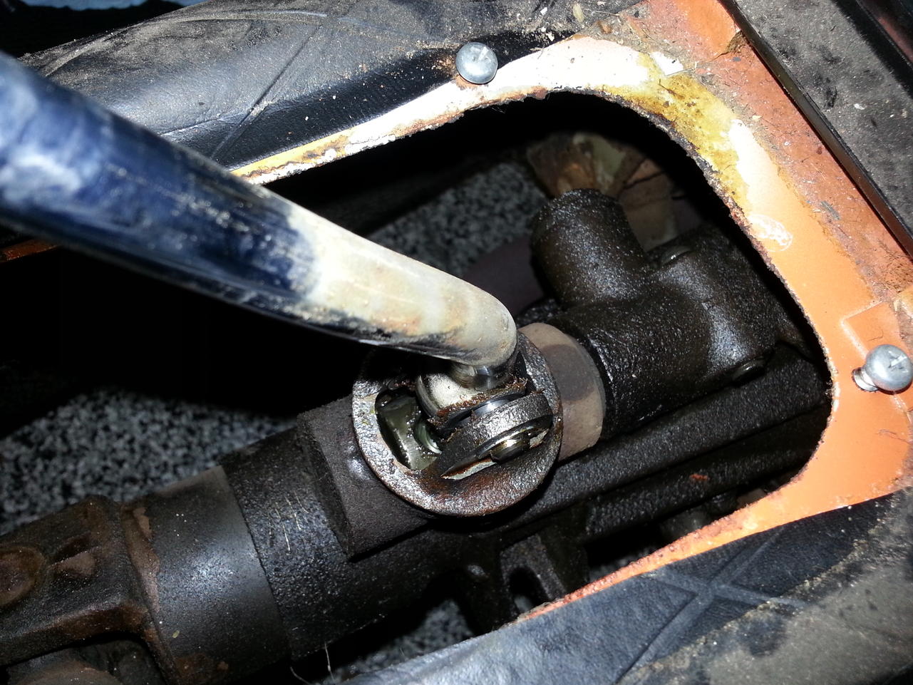

The choke lever was so stiff I could barely pull it back, so I also removed the console and choke cables, cleaned and greased them, and reinstalled the choke lever assembly welded onto a metal plate as suggested by ZTherapy. The lever feels so smooth now! Unfortunately I failed to take any photos of this process, I don't know what I was thinking. "While I was at it" I replaced the completely MIA shifter bushings, so the shifter feels much better.
Once I get the powder coating done I'll really be able to make some progress. My bead blasted control arms and knuckles are just sitting and waiting (and rusting).
Here's the before... gross.

I don't know if this product is suitable for powder coating, you could probably ask Eastwood. I use Eastwood's "After blast" on parts after I strip them. It is an acid product with some other additives it works a lot like "Ospho" but with out the varnish like finish. It turns the parts blueish gray like Phosphoric acid does and they can sit for months in my shop and not develop any surface rust. You might want to look into it... FWIW no relation with either company...

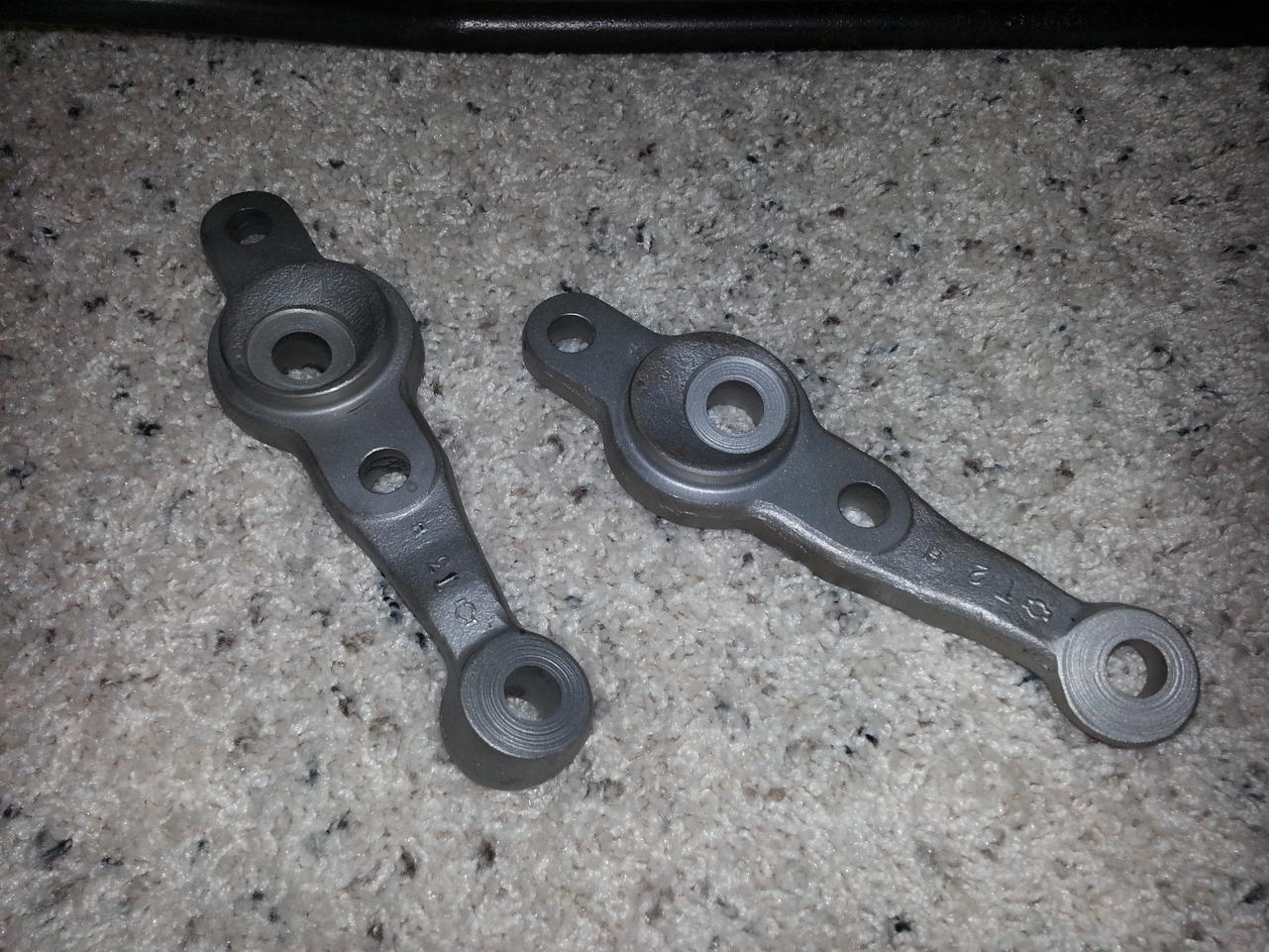

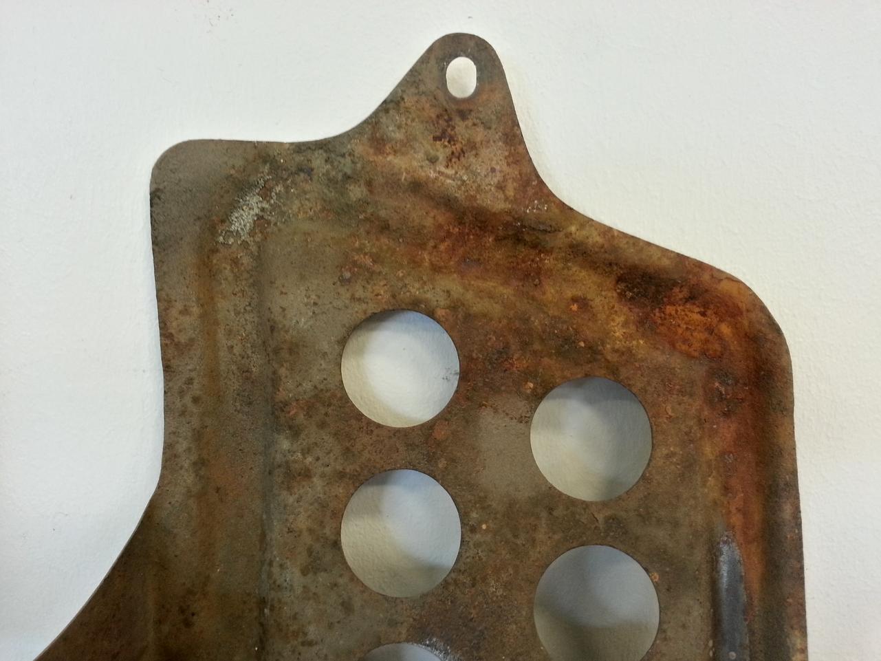

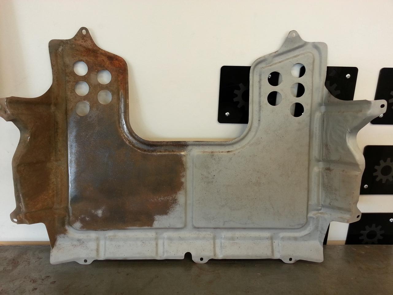

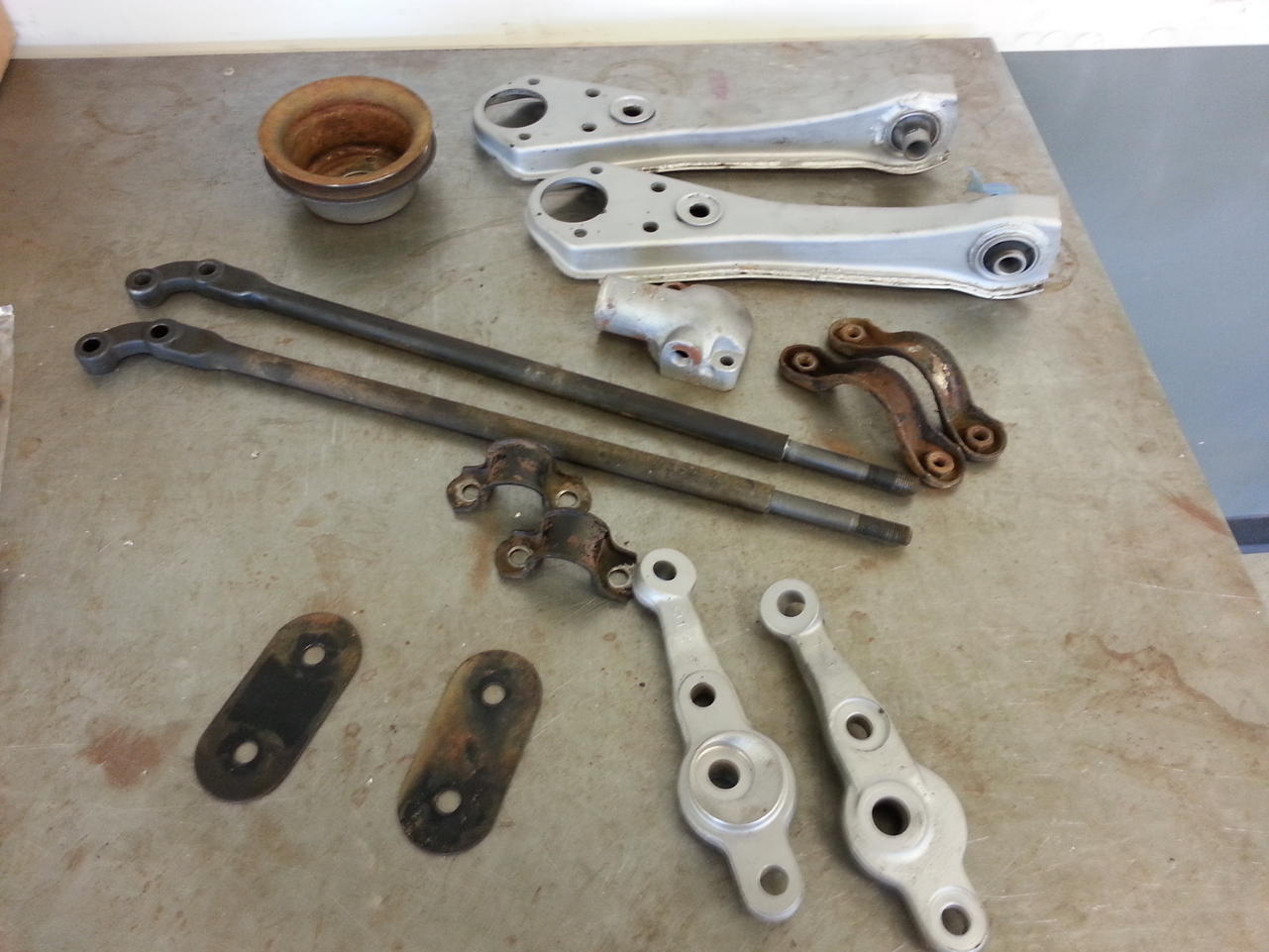

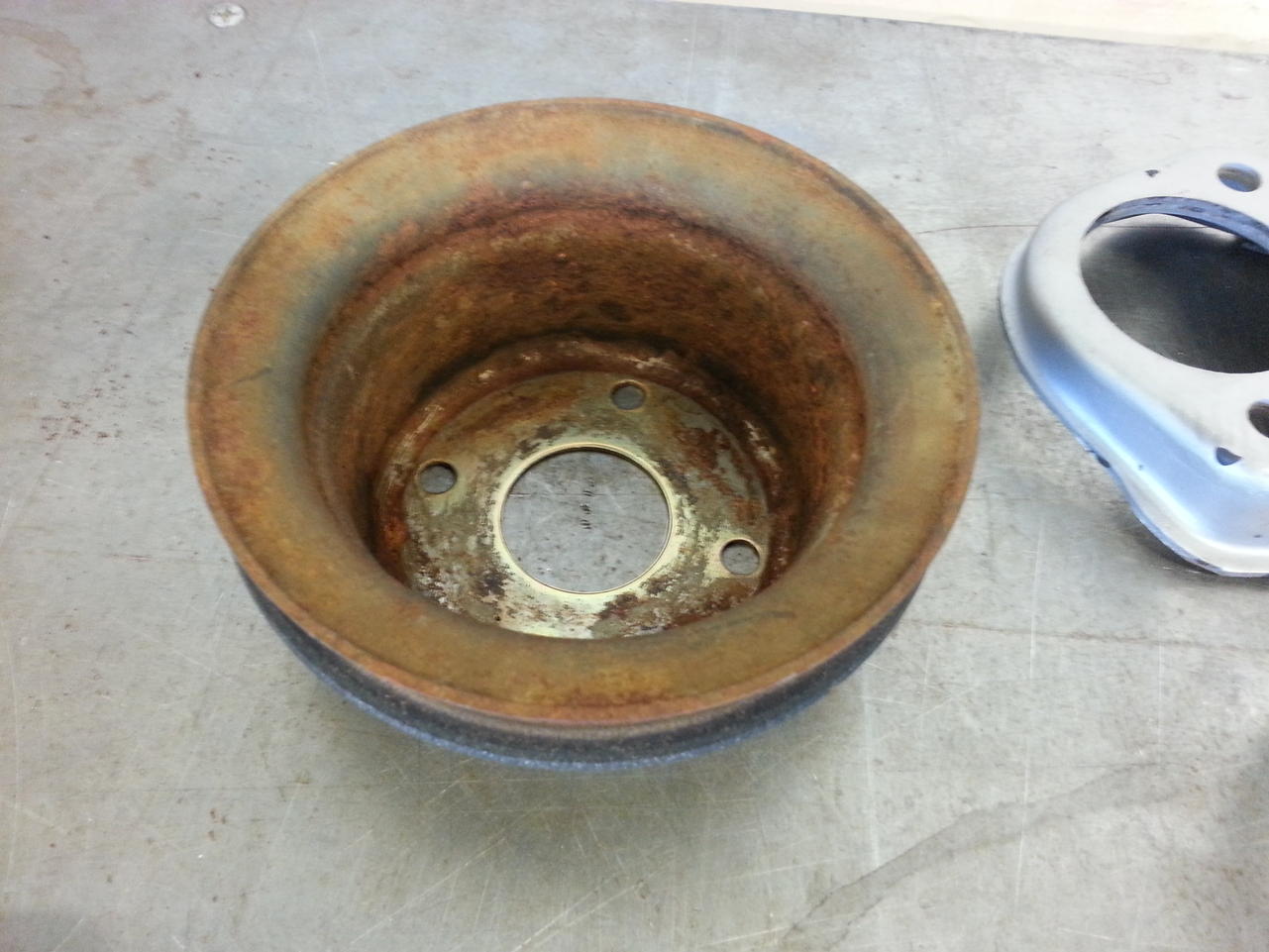

Time for an update. I finished my first batch of powder coating! Everything turned out well I think, for my first time. Here are some before & during shots while sandblasting the parts:
Sandblasting is great but awfully time consuming.

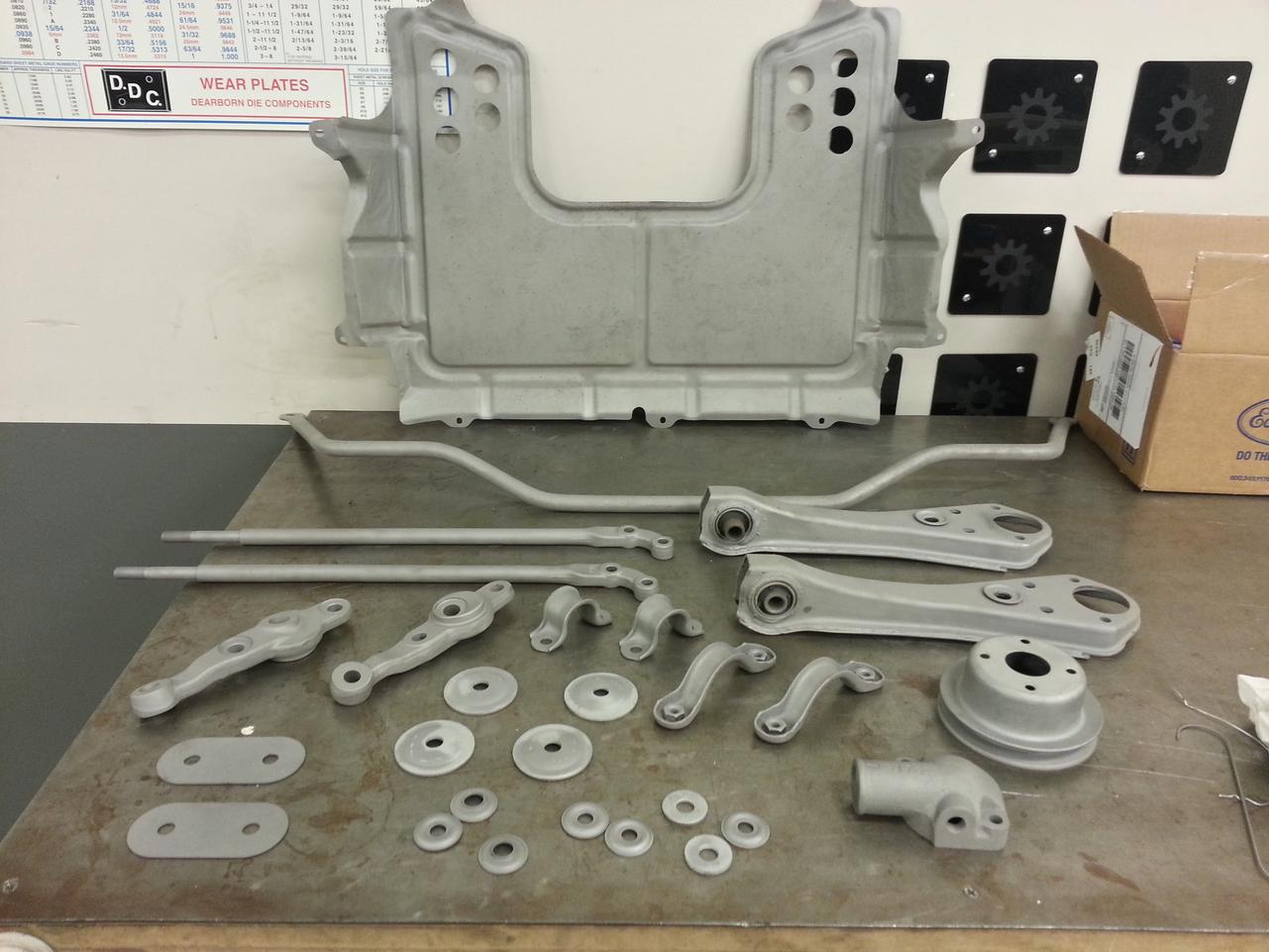

Everything sandblasted!
