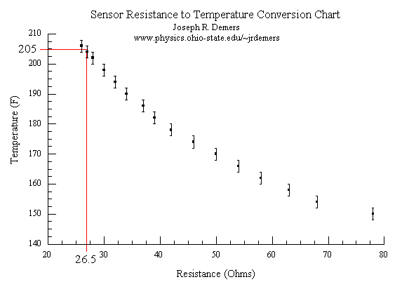

A contributor to this sight, Dr. Joseph Demers, had presented a way to calibrate the temp gage by measuring the correct resistance in the temp sending
unit. I used this to calibrate my temp gage and the reading now perfectly matches temps I am getting using my infrared thermometer. If I can find his
article, I will add it to this discussion.

I think this is the article that AZ-240z was refering to, the Z Car Home Page the overheating article in the tech library.

Burl, I should have given better directions to the article that AX-240z mentioned, go to the Z Car Home Page
then to Index of Tech Articles, then Engine, then Cooling Systems, 280ZX cooling system problems.
J.R.Demers has done most of the grunt work in producing this chart at the top of this post.
It is an excellent article and well worth the read but the quick way is just remove the wire going to the temp sensor and measure the ohms from the temp sensor to grnd when the engine is hot and turned off.
I did it today after a good run and came up with 27.6 ohms which confirms my IR readings putting me at 195-198* F
