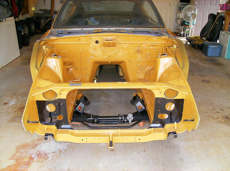

I've attached a pic of the blackout for the radiator support. From the factory, this was a satin finish but I went with glossy for easier maintenance. I also went with a black underside and started it right where the firewall transitions into the tunnel at the tranny mounts. My wheel wells are body color, not black- it seems to highlight the wheels and tires better..

That picture was exactly what I was looking for. The black is only on one side of the radiator support, correct? I had thought about keeping the wheel wells black because I thought they might look better than "dirty yellow". I don't know?
C
On the radiator support, yes - only the front side gets a blackout.

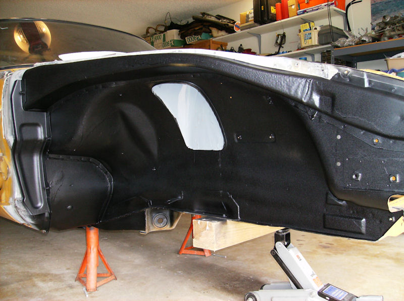

Here are a couple of in-process shots of my front fender wells. I took the shock tower down to bare metal and POR-15'ed it, then masked that area and sprayed truck bed liner as an insulating layer. That will give you an idea of an all black fender well. Don't forget - mud and dirt also shows on black. I painted the shock tower and front side of the footwell with a special paint I had made up, then dusted the fender well with body color.
I hope this helps a bit with your decision process.
