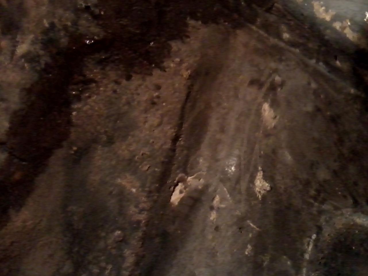

72 240, doing floor repair. I bought the car with the area under the seat completely shot, fiberglassed over, every wrong thing you can imagine. The front floorboard looked good.
After removing the rubberized coating, I noticed what I would call pinholes in the floor, up where the passenger's left foot might rest. I have a new full length floorboard ready to go.
So...do I cut the whole thing out, or just weld/POR15 the little holes, and put new metal in the back? thoughts?

If there are pin holes then that area of the floor is already thin. Replace the whole thing and then you won't have to worry about fixing that area later. It's a much cleaner job that way too. You can weld it in at the factory seams on 3 of the 4 sides.

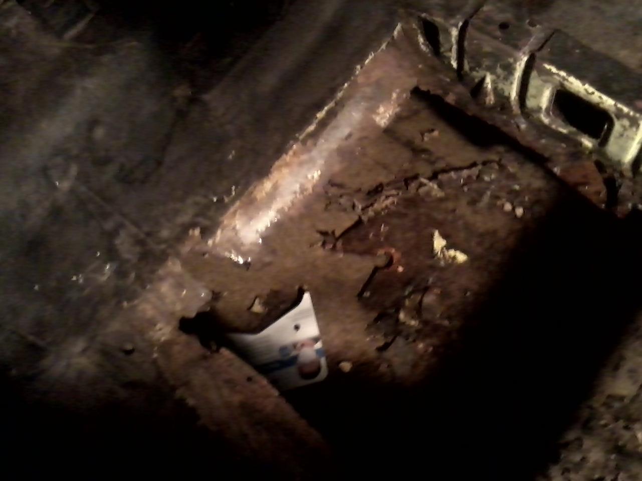

post-2858-14150824409153_thumb.jpgI drilled/grinded the welds, and I am getting ready to cut out the rest of the floor tomorrow night. Does the front rail/brace need to come out, or can it just go in under the rail? I am attaching pics.
If by "front rail/brace" you mean the front seat support which sits about midway on the floor pan, then yes you can leave it in as long as you grind off the welds on the bottom of it. You can run a couple of self tapping screws through the bottom flange of that seat support and into your new floor pan so you can get a good weld then remove the screws and fill with weld.
Rather than using screws to draw the seat mount and floor together put a factory jack and a block of wood under the floor to push the floor into the seat mount. If there's still a gap you can tap the seat mount down toward the floor since the jack/wood will be bracing the floor. That way there are less holes to weld and grind. :-)

Your right of course, I was picturing my Z body on it's side on the rotisserie. CEgg11 is probably doing this with wheels on the ground.
