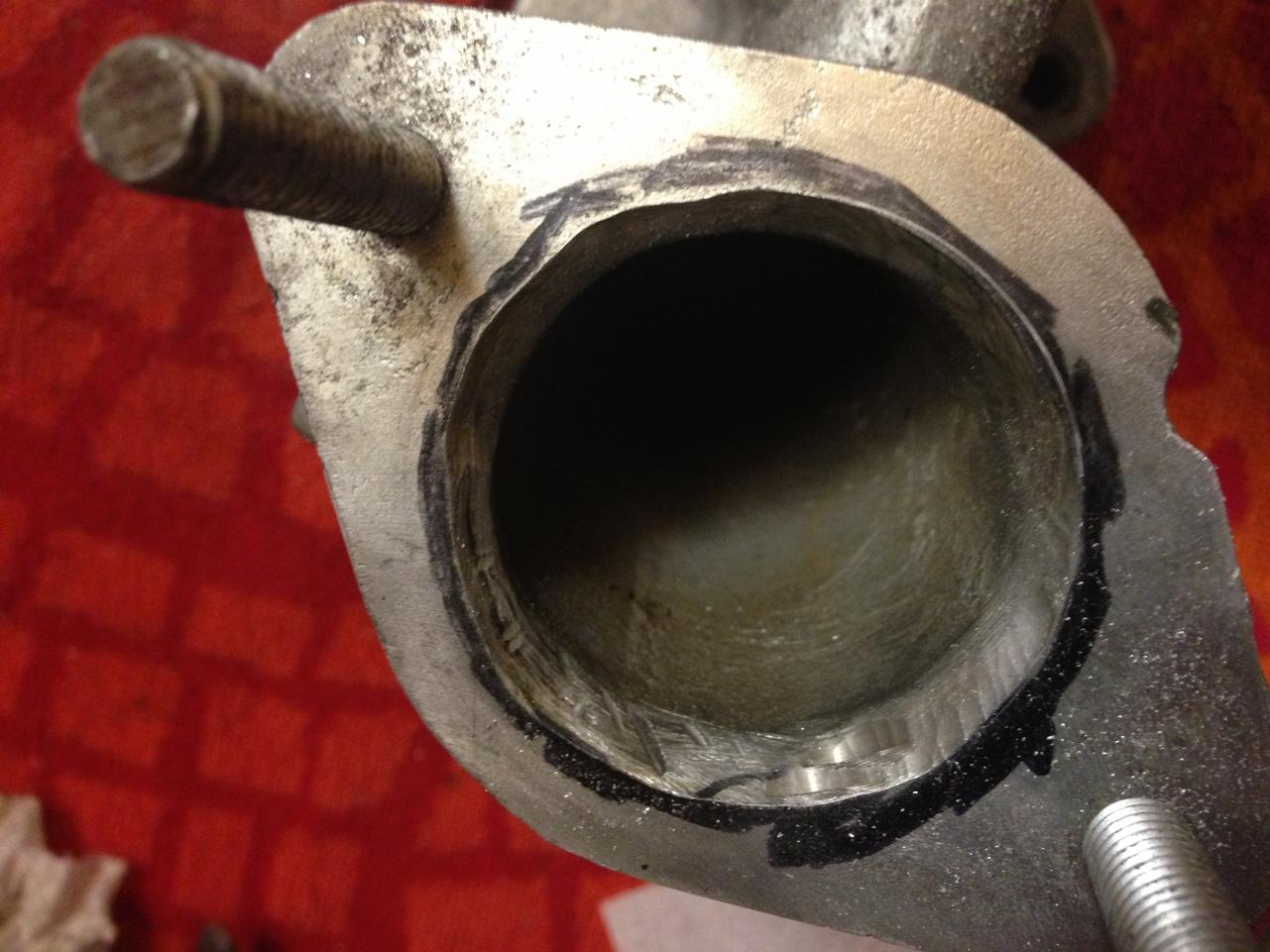

This is a photo from before porting the carb side of the intake...

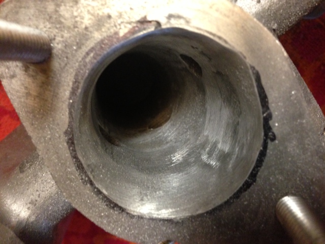

90% done...
I didn't take a photo of the finished product but it made for a nice smooth transition from the carb to the plastic spacer to the manifold if you look down the throat of the carb.
