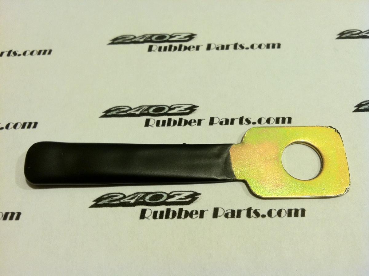

February 20, 201510 yr Author comment_463939 Oil sending unit wire tab that mounts on the right front motor mount. Entire bracket has been plated then rubberized. Â Â Â Link to comment https://www.classiczcars.com/forums/topic/46317-240z-fuel-and-brake-line-insulator-sets-and-steering-rack-expansion-reservoir/?&page=15#findComment-463939 Share on other sites More sharing options...

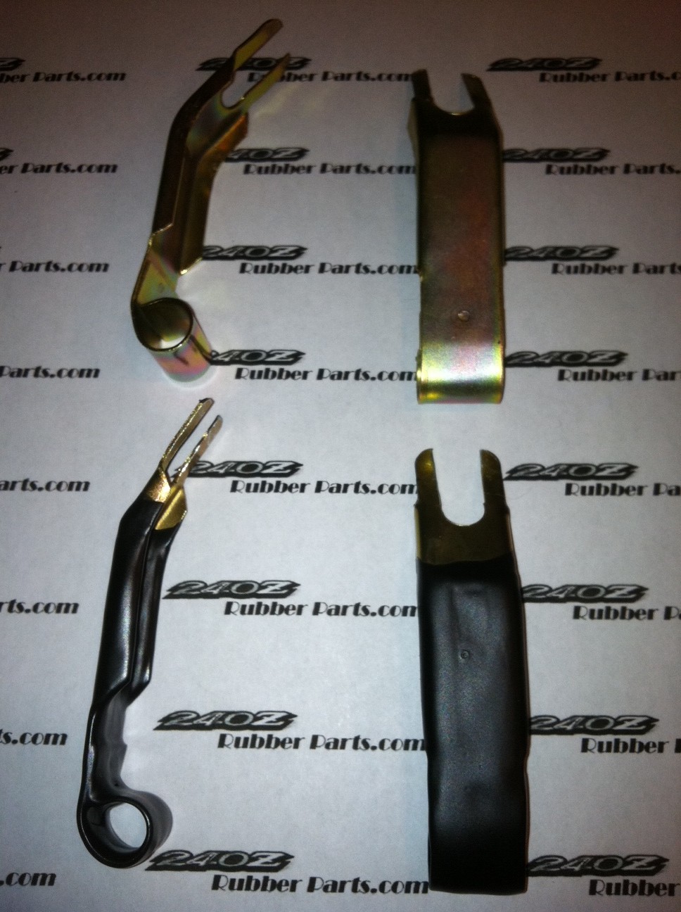

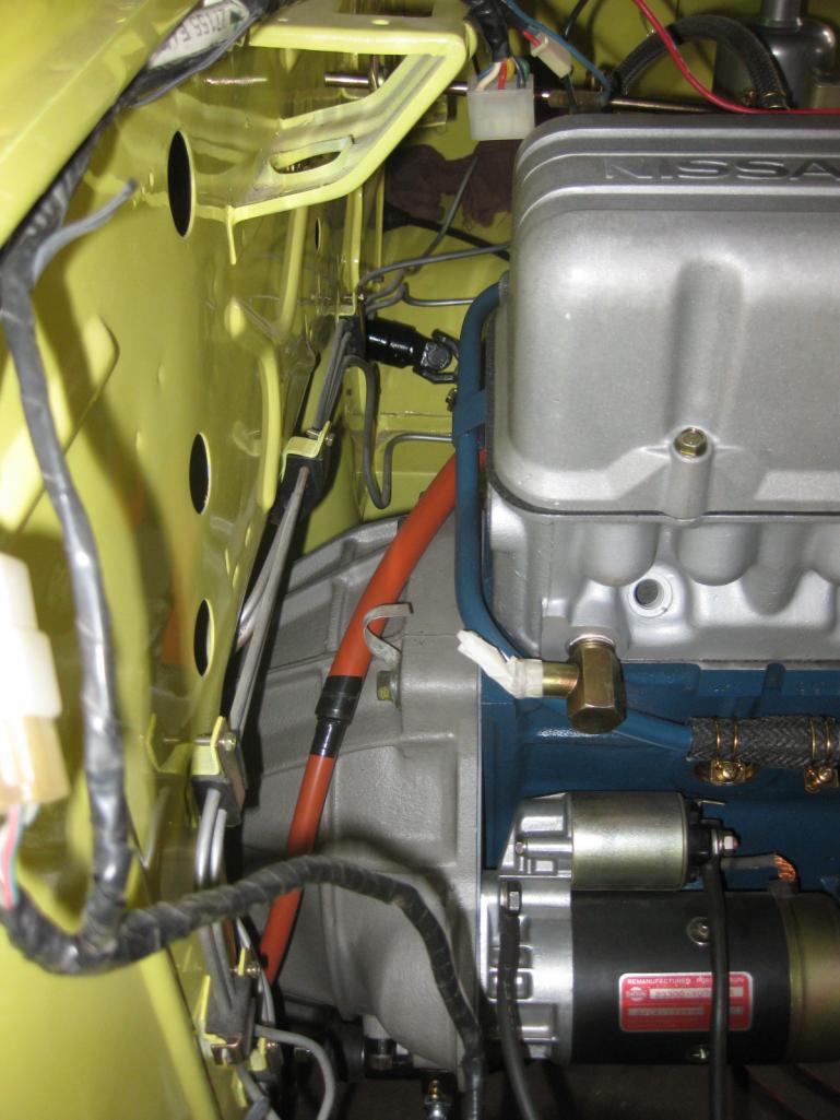

February 20, 201510 yr Author comment_463942 speedometer cable holder tab.  This is a tab located between the transmission and the block. There are two tabs on the right and left side that hold the speedometer cable in place.  Link to comment https://www.classiczcars.com/forums/topic/46317-240z-fuel-and-brake-line-insulator-sets-and-steering-rack-expansion-reservoir/?&page=15#findComment-463942 Share on other sites More sharing options...

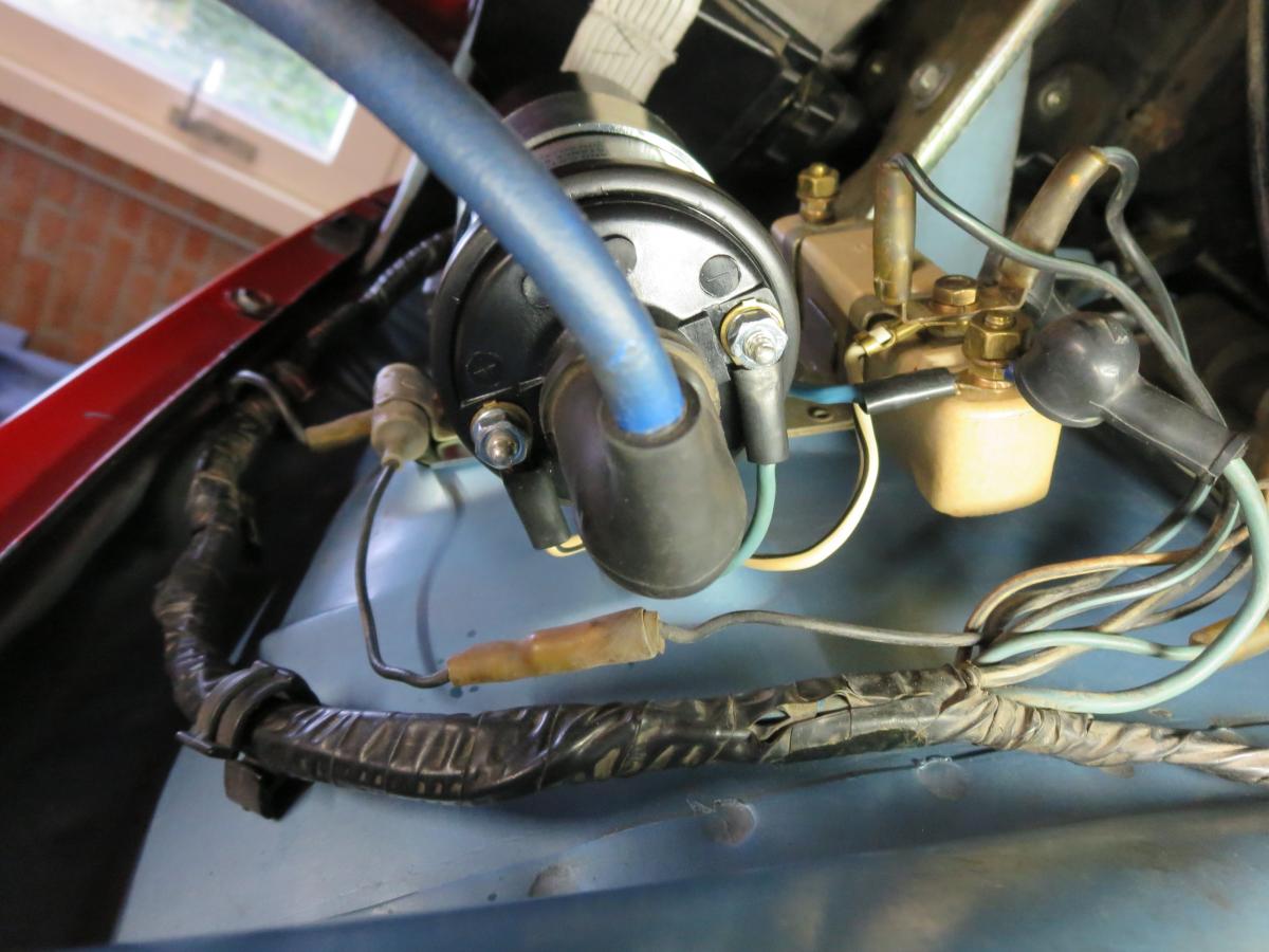

February 20, 201510 yr comment_463952 fuel sending unit/pump wire harness boots boot1.jpg Steve,Are these caps the same size as the ones used on the ballast resistor? Can they be sent as normal post? I have sent small items like this overseas through the post a lot with no hassles. If I can keep the thickness under 32mm it costs €3.25 plus a bubble envelope. Thanks Chas Link to comment https://www.classiczcars.com/forums/topic/46317-240z-fuel-and-brake-line-insulator-sets-and-steering-rack-expansion-reservoir/?&page=15#findComment-463952 Share on other sites More sharing options...
February 20, 201510 yr Author comment_463956 Chas, the 240z uses a spade type connector at the ballast resistor, so I am not sure what other models use as connector. steve Steve,Are these caps the same size as the ones used on the ballast resistor?Can they be sent as normal post? I have sent small items like this overseas through the post a lot with no hassles. If I can keep the thickness under 32mm it costs €3.25 plus a bubble envelope.ThanksChas Link to comment https://www.classiczcars.com/forums/topic/46317-240z-fuel-and-brake-line-insulator-sets-and-steering-rack-expansion-reservoir/?&page=15#findComment-463956 Share on other sites More sharing options...
February 20, 201510 yr comment_463962 Chas, the 240z uses a spade type connector at the ballast resistor, so I am not sure what other models use as connector. Â steve The 280Z has a mix of both. I think its the same size as the fuel pump? Link to comment https://www.classiczcars.com/forums/topic/46317-240z-fuel-and-brake-line-insulator-sets-and-steering-rack-expansion-reservoir/?&page=15#findComment-463962 Share on other sites More sharing options...

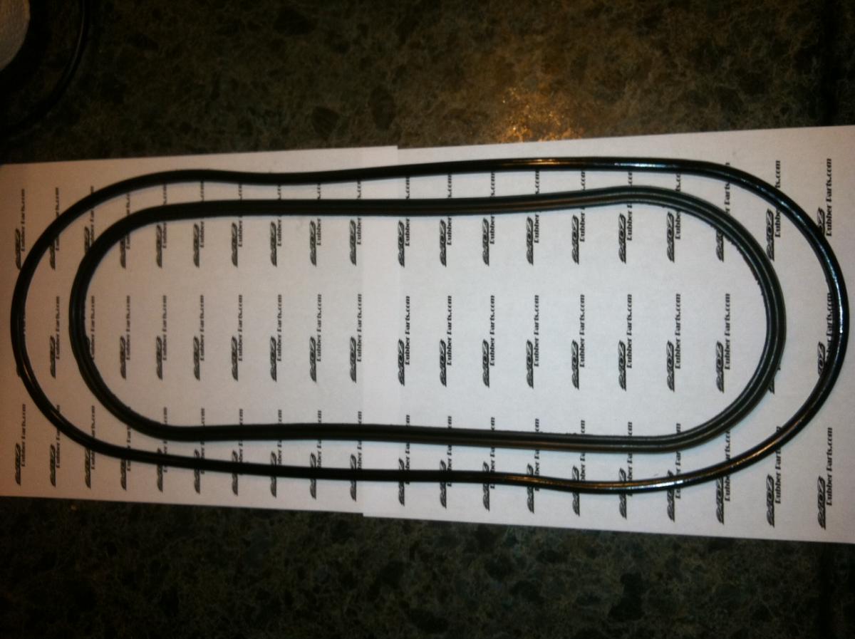

February 24, 201510 yr Author comment_464288 A preview of a project I have been working on. Â reproductions of the 70-73 air cleaner gaskets. Â These will need to be glued in place like the originals. Â Â Edited February 24, 201510 yr by nix240z Link to comment https://www.classiczcars.com/forums/topic/46317-240z-fuel-and-brake-line-insulator-sets-and-steering-rack-expansion-reservoir/?&page=15#findComment-464288 Share on other sites More sharing options...
February 24, 201510 yr comment_464309 Oh boy! I'll be first in line when these become available! Hip Hip Hurrah for you Steve!  Some of the time things in life can happen when you wait! And----I've waited and wanted and wished for quite some time.  I can see a few air cleaner housing refurbishments in the near future to keep me busy!  Jim D. "Zup" Link to comment https://www.classiczcars.com/forums/topic/46317-240z-fuel-and-brake-line-insulator-sets-and-steering-rack-expansion-reservoir/?&page=15#findComment-464309 Share on other sites More sharing options...

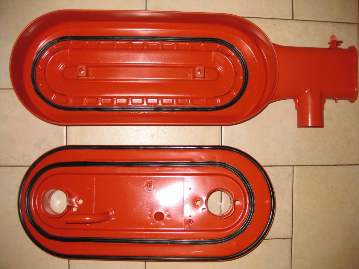

May 25, 201510 yr comment_470469 It took a while for me to get to it but-- here is a photo of the air cleaner I refinished for my 73 240Z (yes, I converted to 3 screw round top carbs) using Steve Nixon's reproduction gaskets mentioned above. I am very satisfied with the gaskets---they are identical to the originals in profile. I found I needed to cut them with a razorblade to shorten the overall length by about 3/8", as in a test fit they were a little large. I used Dap Weldwood contact cement. (in the small 3 ounce glass bottle with an attached brush applicator in the cap---it was a perfect sized brush for applying the cement to the housing and to the gasket) Your experience may vary, but I cut away all of the old gaskets and had the housings blasted to remove all of the old paint, then hand sanded with 400 grit silicon carbide paper. Wipe down with wax and grease remover several times, let dry and rattle can spray with Dupli-Color DE1607 Chev. Orange Engine Enamel (It appears identical to the original color--a deep red/orange)  Let the paint dry for several days to harden or the contact cement will soften the paint and cause wrinkling.  Decals are to come from Banzai Motorworks---- www.zzxdatsun.com    I hope this helps anyone restoring their air cleaner. Steve's gaskets are not cheap, but they are perfect, and again he has reproduced a discontinued part that can not be found anywhere else.  Thank you Steve!  Jim D. "Zup" Link to comment https://www.classiczcars.com/forums/topic/46317-240z-fuel-and-brake-line-insulator-sets-and-steering-rack-expansion-reservoir/?&page=15#findComment-470469 Share on other sites More sharing options...
May 26, 201510 yr comment_470532 Very nice work! Link to comment https://www.classiczcars.com/forums/topic/46317-240z-fuel-and-brake-line-insulator-sets-and-steering-rack-expansion-reservoir/?&page=15#findComment-470532 Share on other sites More sharing options...
