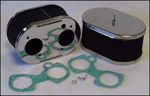

Okay we run air filters, and fuel filters all day long. WE clean them and we obsess over them. But the part that I baffles me is why do we kill ourselves when the front of the Weber has a 12mm hole in it that lets air in for the idle circuit to work. THat is unfiltered air. WE do not even try to filter that air.
When I recently removed my webers and cleaned them there was DIRT in the very bottom of the bowls. DIRT.
I removed it and all is well, but why do we never make an effort to filter the air coming in that huge gaping hole.

I'm with Phil, my filtration setup is similar. There are plenty of housings on the market that cover the front of the carb and can also support air horns, if that's what you're worried about.
hummmmm.
I had not considered those kinds of filters. I run those sweet but marginally functional velocity stack filters...
I may have to invest in a set of those as long as I can use my velocity stacks.

Well here is my baby with the new K&N filter set up. Really fills up the engine bay. I have no doubt they will work better than my velocity stack filters, But they are a bit tight around the coil and the master cylinder. Took digging deep into my specialty tools to get a screwdriver that short!
sorry for the crappy cell phone pic. My DSLR batter was kaput.
Sweet! Could you post the part number and vendor? I'd imagine having wingnuts in the center instead of screws would help the space situation.
I need to get some for my 45s, I've got those mesh filters on the air horns currently. I plan to do some testing on air filters when I hit the dyno again.
Leon, I just used the ones from MSA...listed here below..
Motorsport! K&N Tall Air Cleaner, Weber DCOE/Mikuni PHH, 40-48 - The Z Store! Nissan-Datsun 240Z-260Z-280Z-280ZX-300ZX(Z31/Z32)-350Z-370Z Parts
I thought about getting some ITG's, but I had some of those go south on me before. The foam turned to mush.
