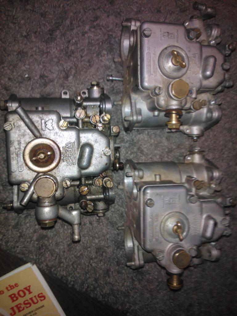

I did a trade with a dude from CA... He sent me set of triple webbers and manifold. Only downside is that THIS IS NOT MATCHING TRIPLET :mad::mad:
Is it anyway possible to run with this setup or should i just resell these as matching pair + one..?? :cry:
All of them are 40mm.
Edit: dont mind about that booklet LOL it came with the package!

Looks like a mash-up of the old and new style DCOE. This won't work (well) because of a few design changes, notably the different pitch and taper of the idle screws. I'm sure there are other minute differences that will make setting the carbs up properly a major headache.
Get a matching set.

I might be able to help you. I have several vintage 40DCOE-18s 'spare'.
One of them might be a close enough match to the two you have. Tell me what the individual numbers on the covers are ( the 'No' on the pad underneath the 'Tipo' line ) and I'll see if I've got one that's near.
