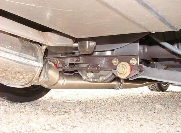

I have seen a modification involving just the brace behind the diff. The brace was cut and the center section removed. An adjustable bolt was then welded into place. This made toe in adjustment possible. Chamber adjustment was done using chamber plates in the tower. I have some photos that I can post tomorrow.

I found the photo. Its not very detailed, but it gives you enough info to be able to make your own.

Wow--thanks for the picture, Chas, that gives me a lot to think about! I'll take a close look at the pic while I'm looking at the 240 so I understand what I need to do.
