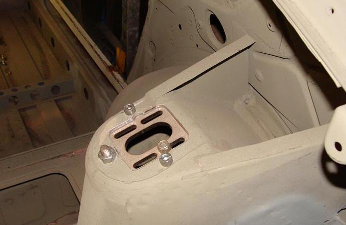

Also, GnoseZ, do you have information about slotting the towers? This sounds tricky to me...and I'd hate to screw it up and...well....I imagine you only get once shot at it before you have to install camber plates. Do you have any pictures, for example?

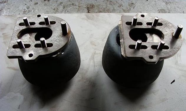

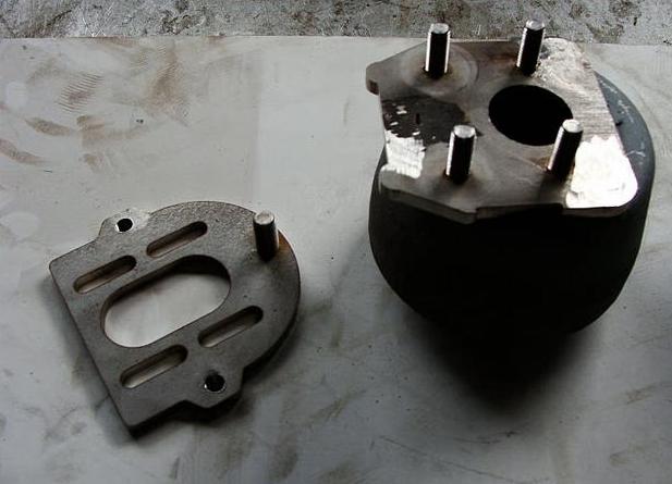

I have some photos from someones elses project. I was interested in the way he did it.
This guy did a really impressive job rebuilding:cool: the car and documented it on his photo blog. The site is gone, or I cant find it anymore. Maybe he will come across this thread oneday, so I hope he doesnt mind me posting a couple of his photos.
The rubber insulators are not original, so Im not sure where they come from, but it shows how the body in the strut tower is cut away to make room for the chamber plates. Its not for the faint harted because once you start there is no way back:ermm:

GnoseZ: I'll do some checking on the MSA site and see what I can learn. Good luck digging out of the snow today, by the way. We're getting some too, but only about 6"-8". I like the idea of slots, and I don't mind modifying the insulator some. Really, I'm just trying to get the tires to stand upright again as I use the car as a daily driver and need to keep tread on the tires.
Chas, thanks for the photos, they make sense to me now. So, it looks like the key is the insulators...the standard 3-hole version won't work--I wonder if I could make a different version or something. Could be slotting is enough...my guess is they're only off by 1-2 degrees negative at this point, so I need to bring them +1-2.
