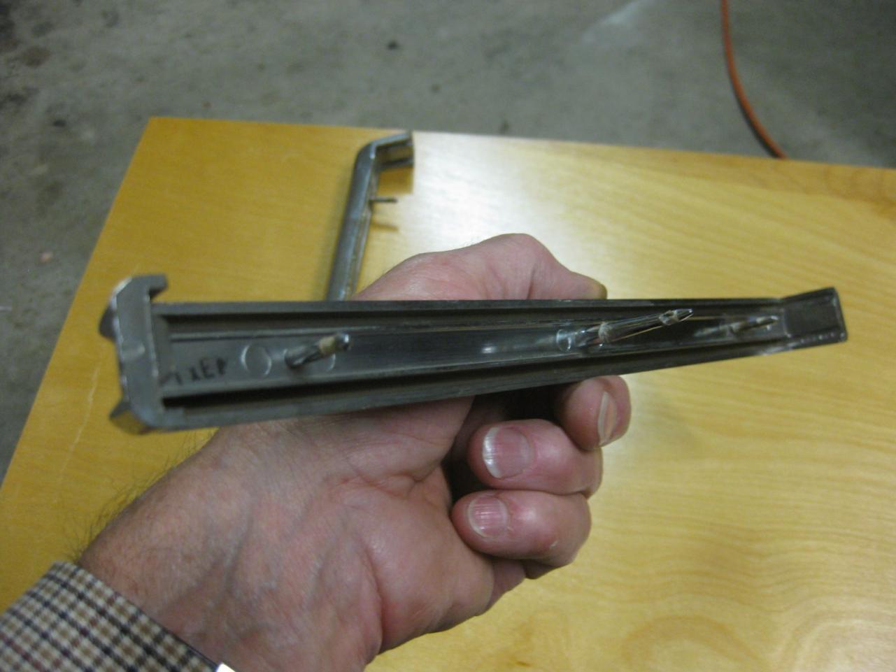

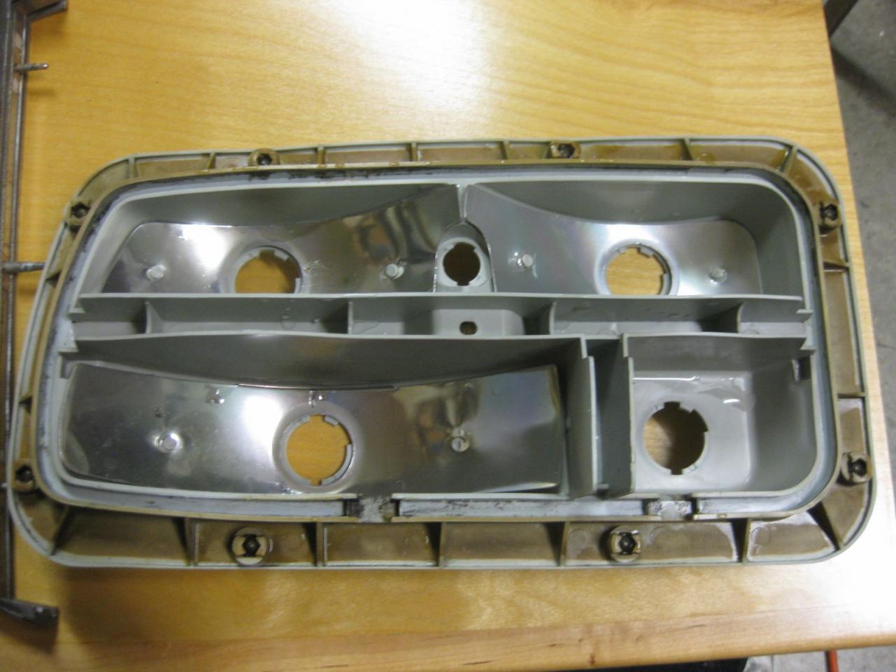

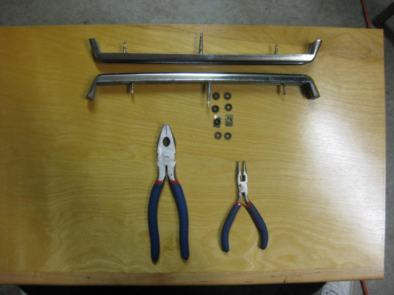

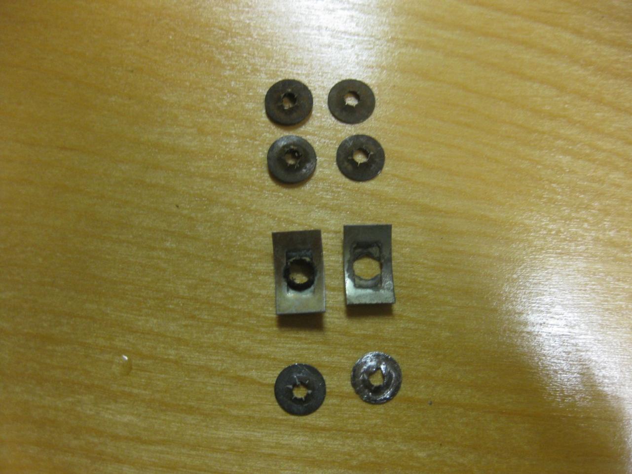

Start as JLP mentions above. Grip the pushnut with some sharp needlenose pliers. I found that by twisting and turning back and forth eventually you can work the pushnut up off the stem intact.

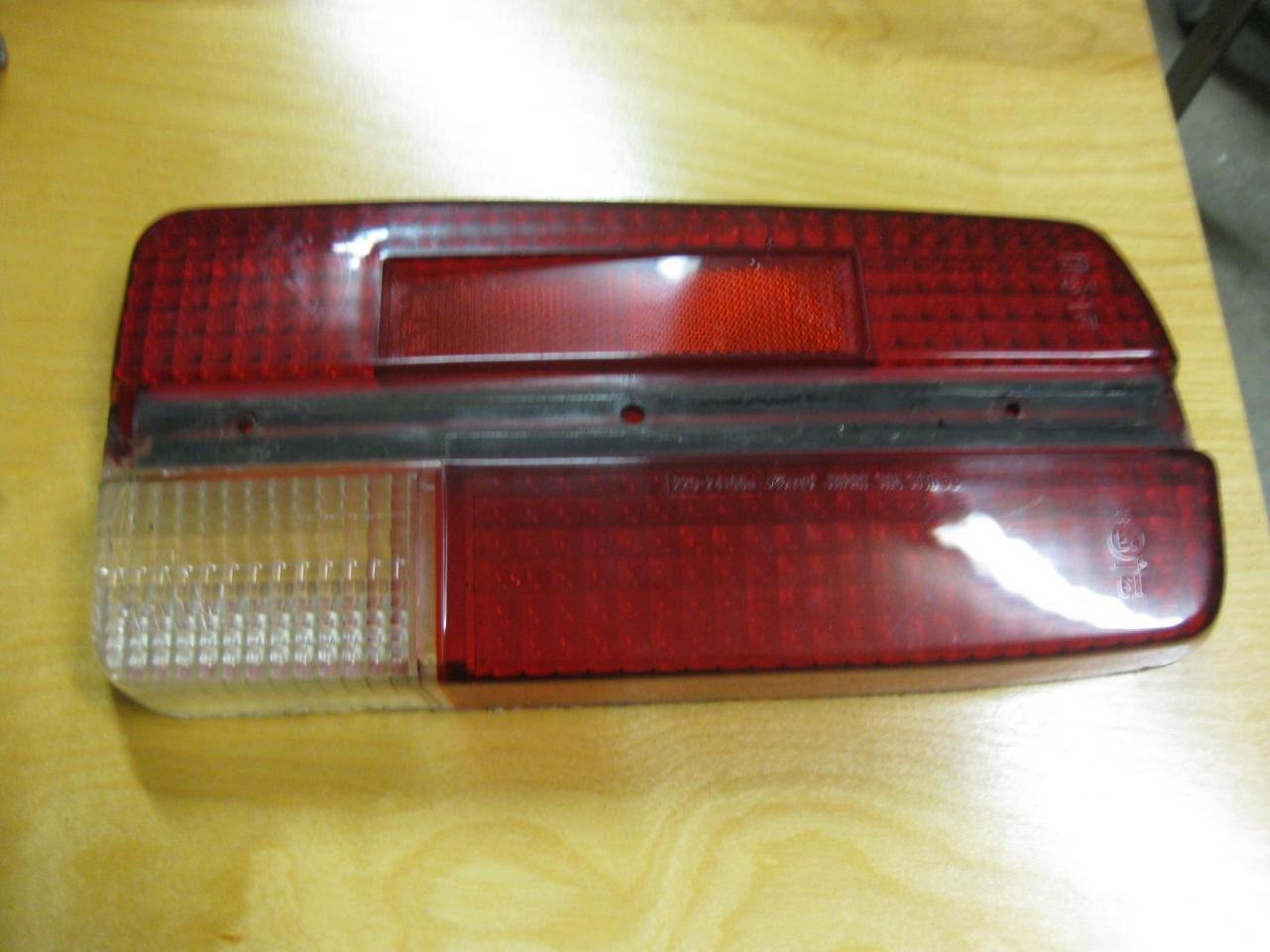

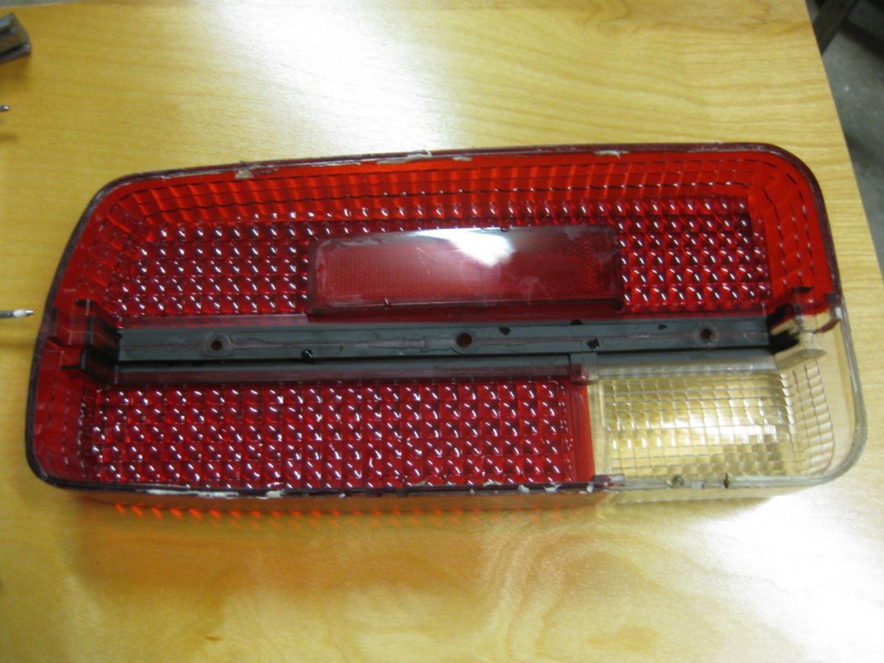

Use very hot water---as hot as your hands can stand---it'll soften the adhesive faster--and completely submurge the lens.
Be careful and patient----it will come apart by pulling the halves apart. Once it starts enough to get a small flat blade in there just carefully pry and it will separate further.
As above, once you have the assembly apart there are 3 more pushnuts to remove--2 round and 1 rectangular. Remove them in the same manner as before---these are much easier to get to and remove.
Lastly, here's a link to a replacement pushnut source I may order from for reassembly when the time comes.
It appears that 6-1/8" and 2-3/16" pushnuts are needed for each pair of tailights.

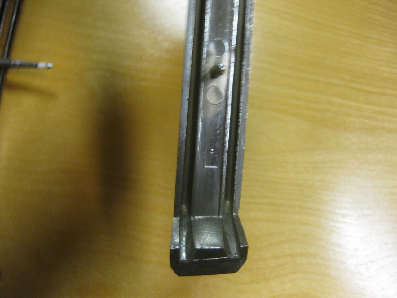

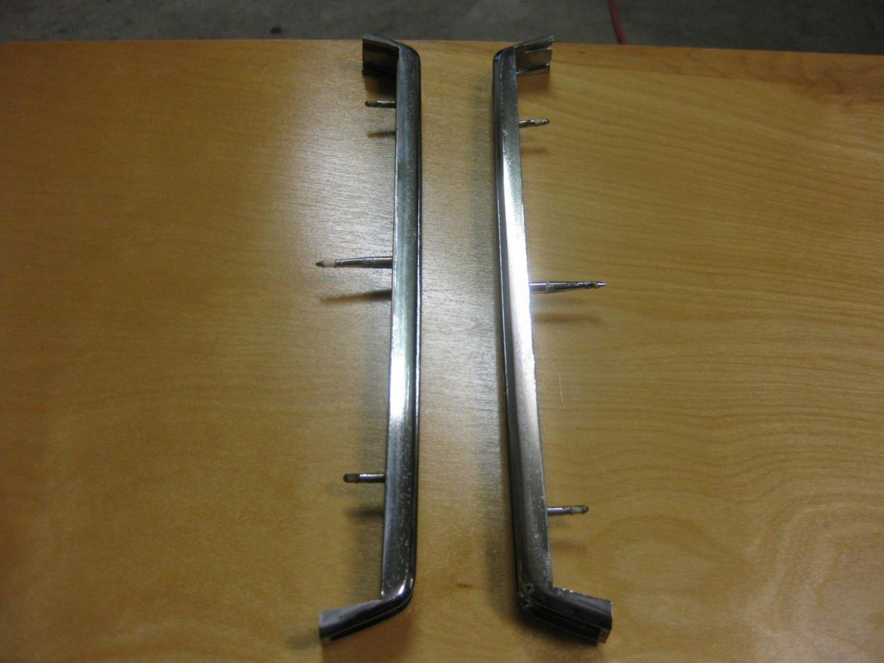

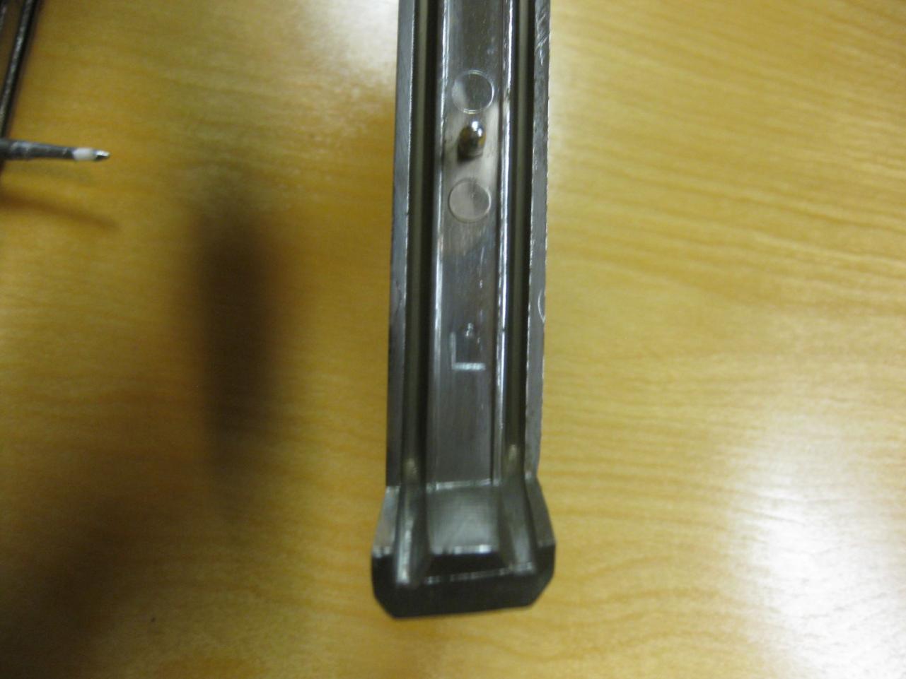

Be mindful of the fact that your chrome strips are handed--left and right--and will only go on 1 way correctly.
