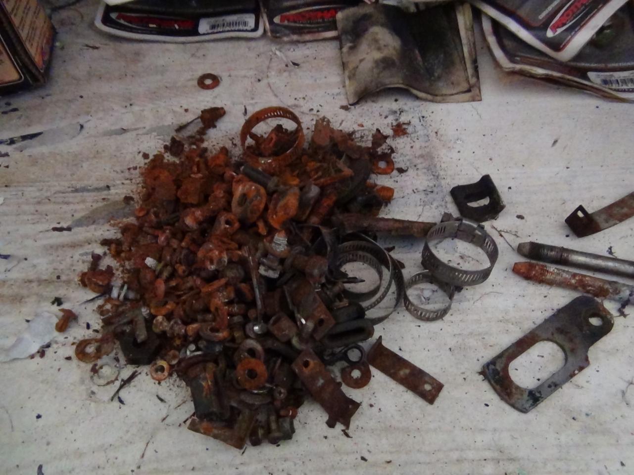

I have a 73 project I took on and I can't seem to figure out what I am going to do about the hardware. When I got the car it came with a bucket of rusty bolts that I have sorted through and cleaned up. I am not sure I want to try to figure out where they go or if I should order all new hardware. Is it possible to order them all togeteher? Mostly for all the front and rear suspenson right now. post-25282-14150821952564_thumb.jpg
