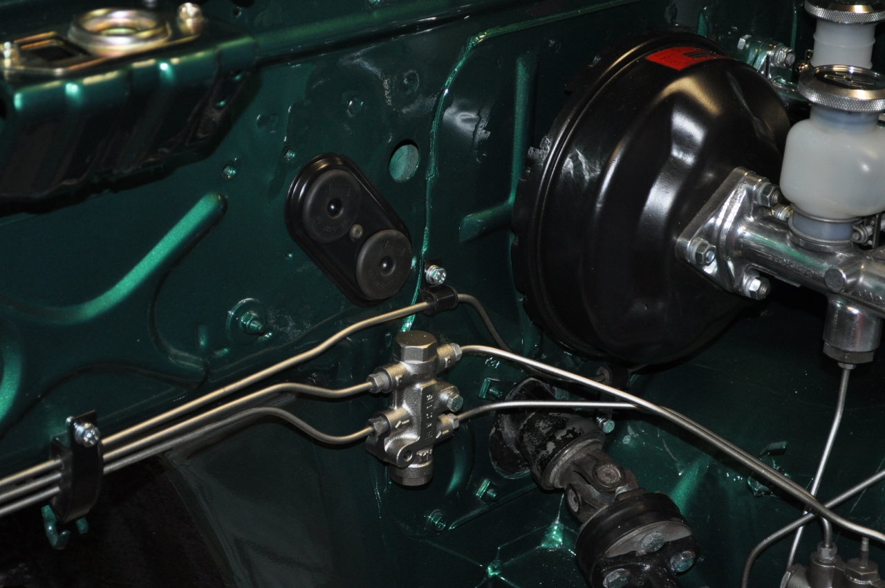

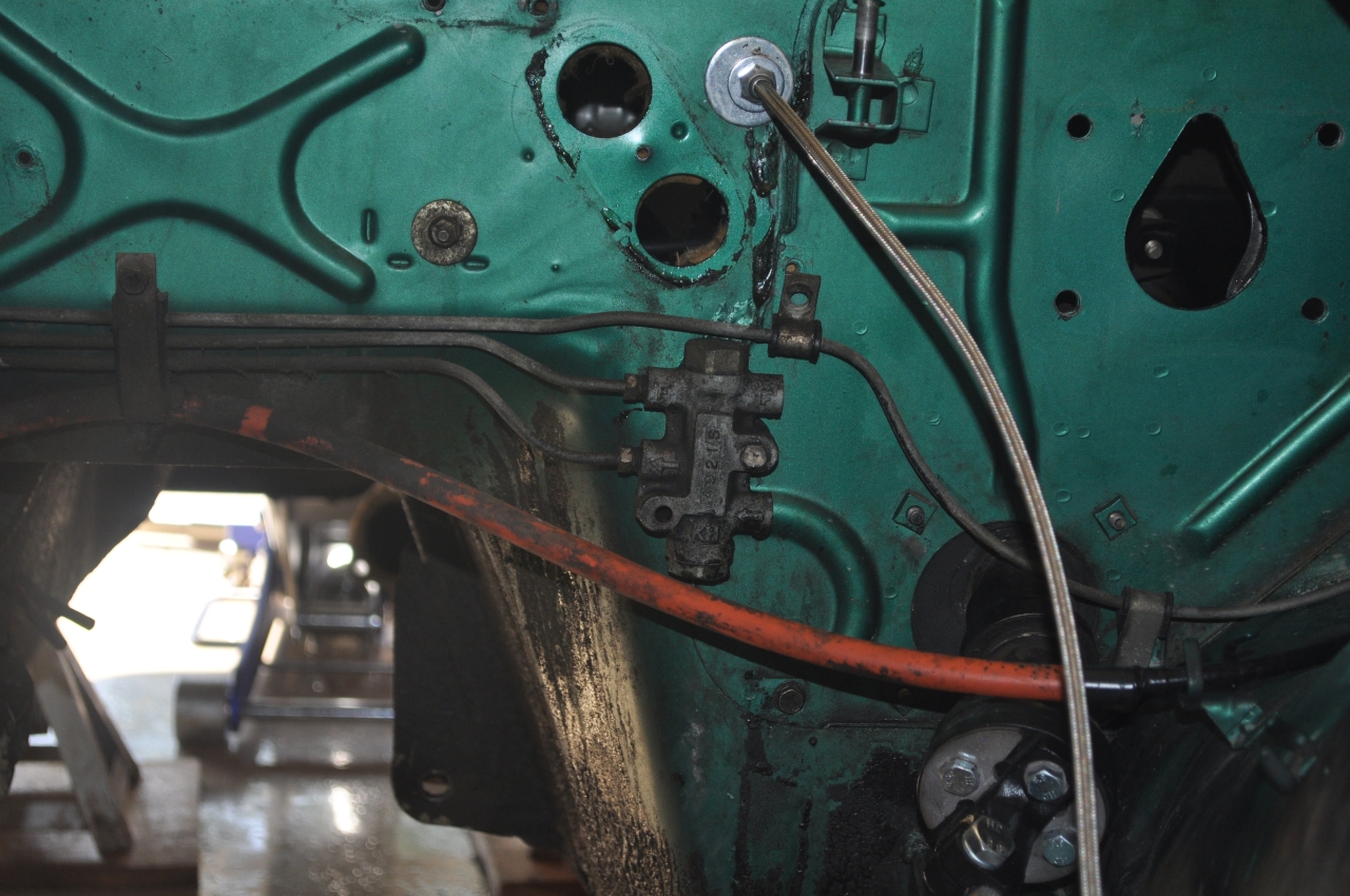

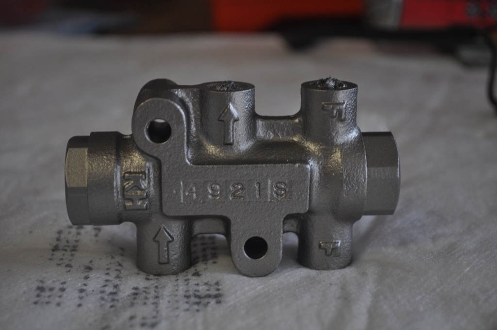

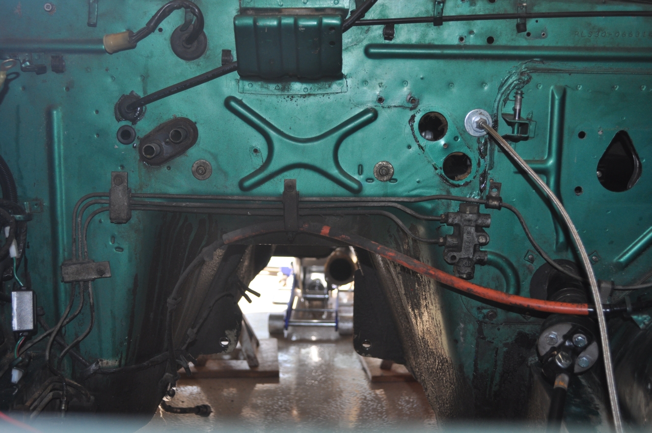

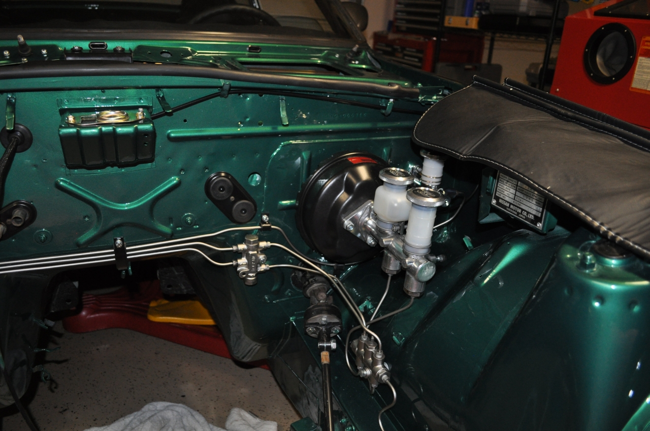

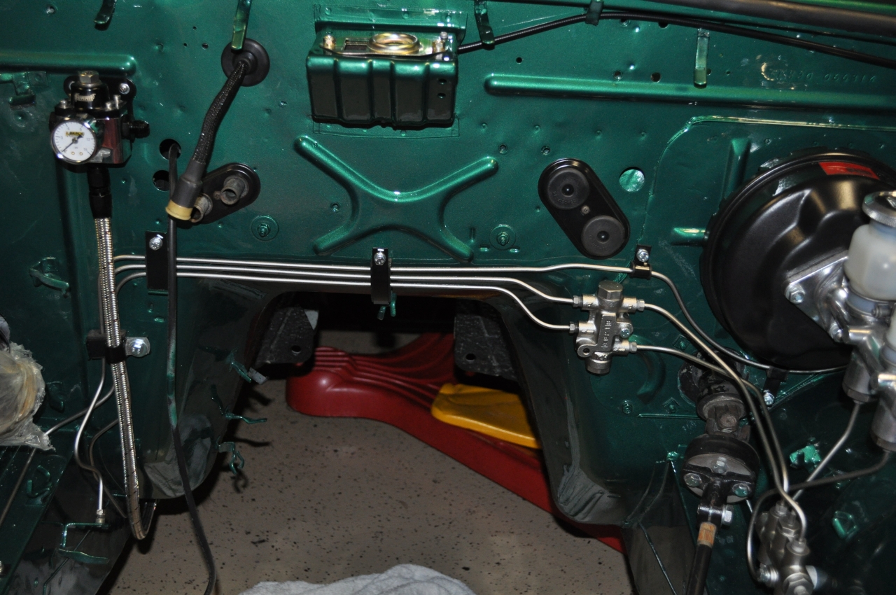

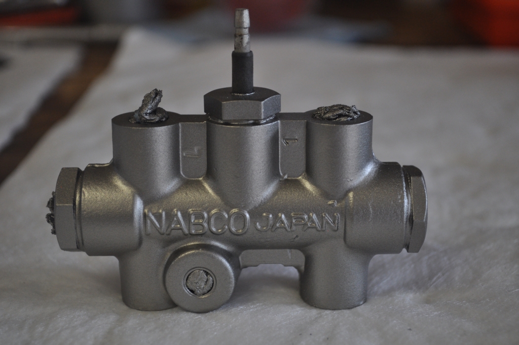

So I just went through this for my entire car. I strongly contemplated buying new lines and bending them myself, but decided to go the refresh route instead. I'm very happy with the results and would definitely go this way again, although some of the clean up process was tedious.
I removed all lines and separated them from the junction blocks as well as from the proportional valve. If the pieces were small enough to fit into my media blaster, I plugged the ends and used the media blaster to clean off the lines as well as the fittings. Before painting, I completely flushed the lines to ensure there was no media left behind. Also blew them out with compressed air as a final insurance policy. Took the same approach with the junction blocks as well as the proportional valve.
For the longer pieces that would not fit in the blaster I used a combination of scotch brite pads as well as 000 steel wool. This worked as well as the media blaster except was a little more tedious and it was more difficult to clean the fittings.
After that, I primed each of the lines with Eastwood Rust Encapsulator. Applied 2 coats to each line and other pieces. After the undercoating was completely dry I used another product from Eastwood called Brake Gray (Brake Fluid Resistant Paint). As you will see from the before / after pictures below, I think that they came out very well. I will also say that as much as I like the look of the paint from Eastwood and it does provide some resistance to brake fluid, it is not completely immune to it. I had one very small leak when I reassembled my lines and I did lose a little of the paint where the fluid leaked, but after drying and cleaning up, I was able to touch up the area with some spare paint that I had leftover.
Hope this helps. See pictures below.
