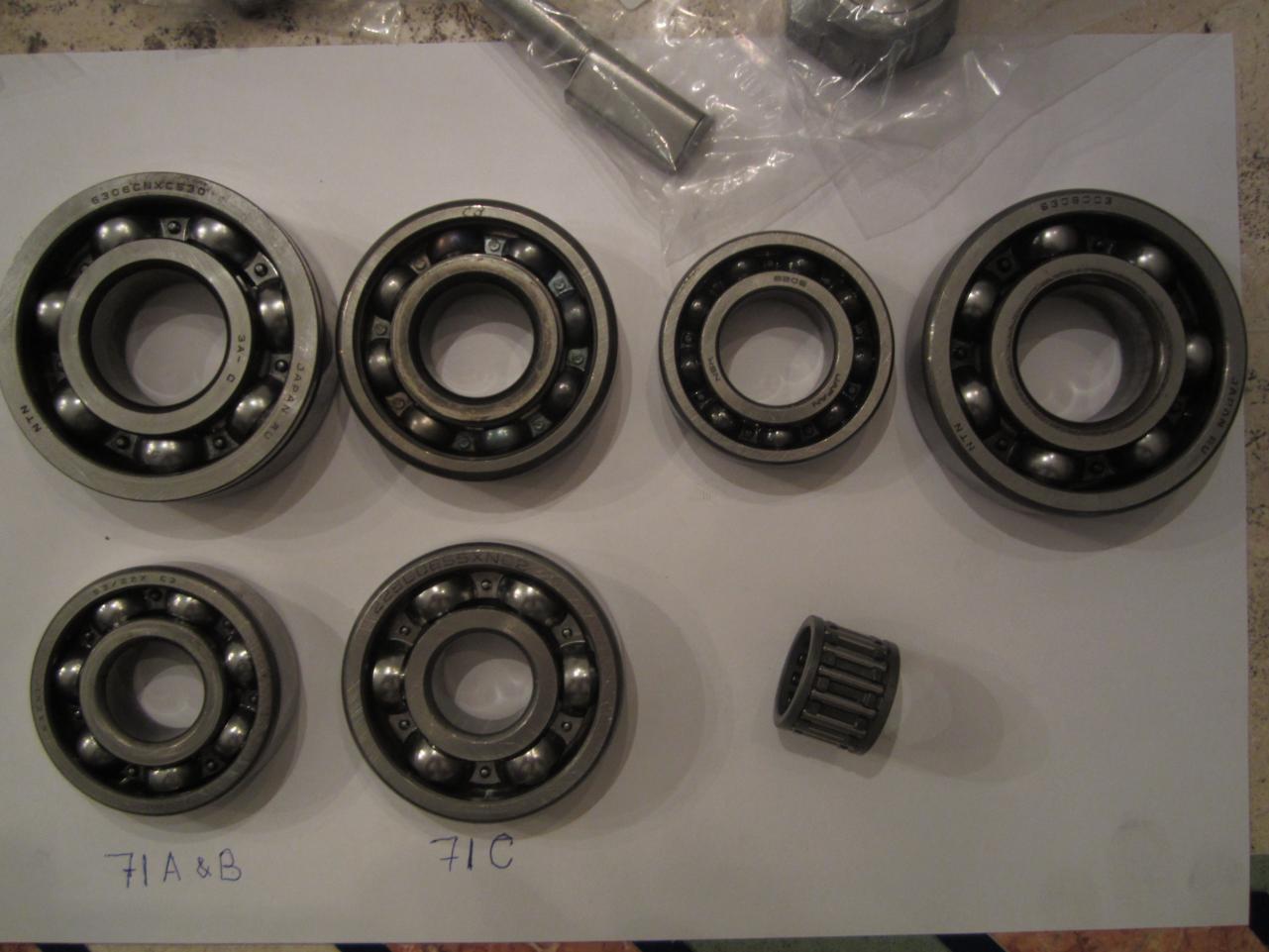

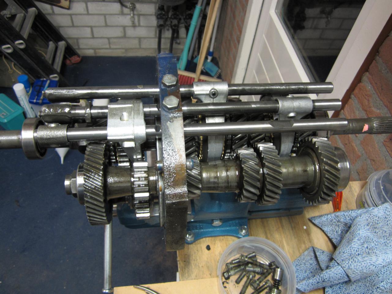

I included a couple of photos of my tranny and the bearings. They are the old one out of the 71B. My next project will be the 71C transmission I have on standby.
