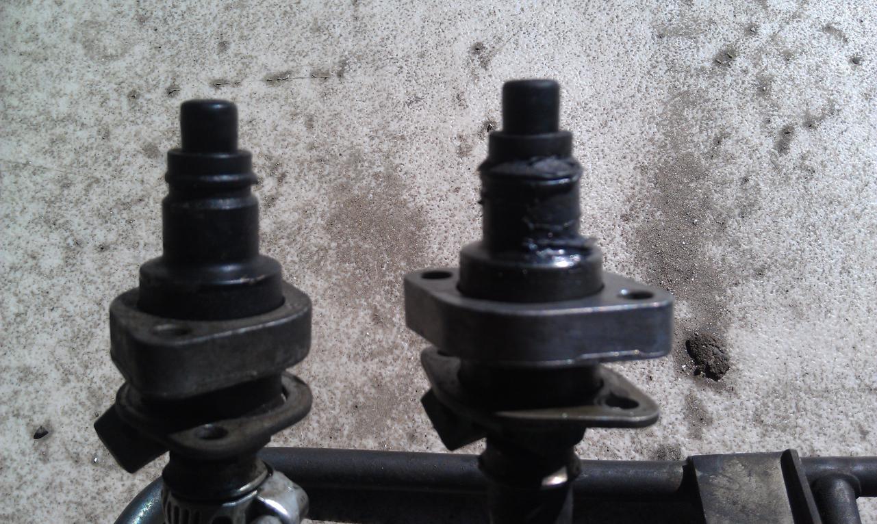

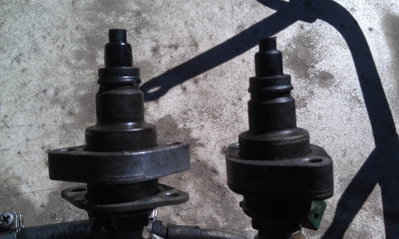

Looking at my injectors I noticed #5 and #6 looked different shape than the others from the tip, and #6 has either a melted o ring or someone tried to seal a leak.

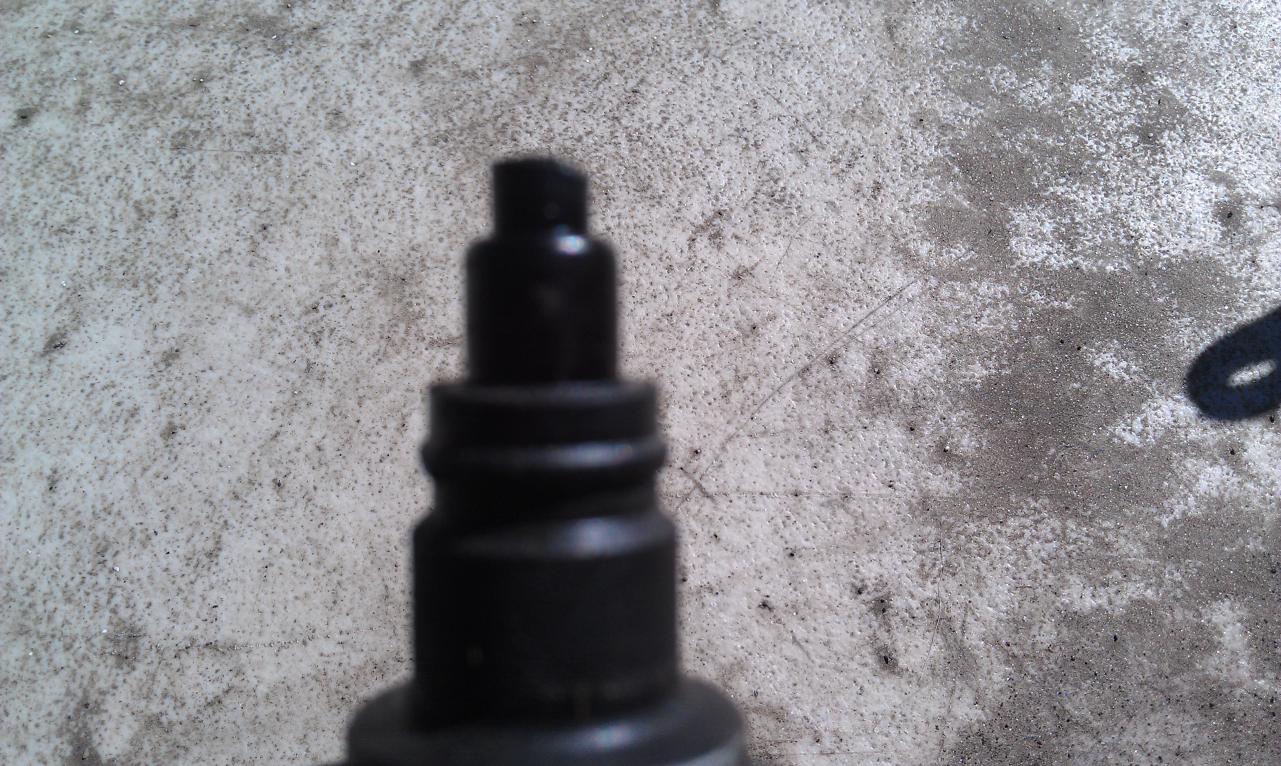

Also noticed the tips of #1, #2, #4 has a slant at the tip as if something is knicking at it.
Any thoughts?

I would get them serviced by a serious injector service center. They can replace the tips, seals and small inlet filter and then flow trst them.
Typical mis-matched injectors on an older Z. If they flow at the same rates the mis-match in pintle caps (the plastic cover on the ends) won't matter. How long has the car sat in the past? It doesn't take long to build up gas tank crud and get a little moisture in the injectors. The set that were on my car when I got it had a mis-match in flow rates of about 15-20%. A few of the cylinders were running pretty lean.
Only the small seal on the end seals to the intake system. The big one is an insulating mounting gasket. The rubber pieces are cheap and available at most auto parts stores.
