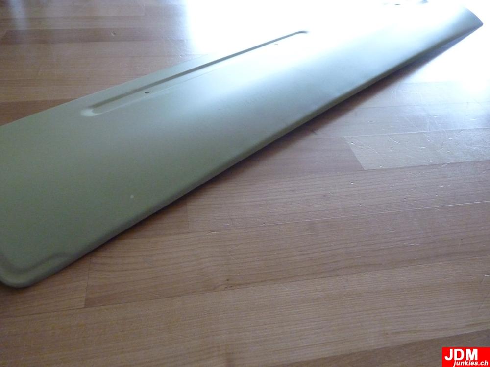

Well my bodyshop is an excellent guy, but he surely takes his time to get all the details right. I love that, but i want my car back before i retire. That's why i always search for the best possible solution to make life as easy as possible for  him. Lately i often saw those yellow panels from UK popping up on various sites. One of the "problematic" areas is stil the Rear lower valance. I got one from MSA so far and it's ok for most of the "american" restaurations i guess, but not for me... The main problem beeing that the Curvature from the original lower valance is missing. I thought i'd give it a try and got it today:
I'm surprised about how different it is and how great it looks. Also got confirmed that it's the original sheet metal thickness as the cars came with. You can clearly see the "curvature" in this picture.

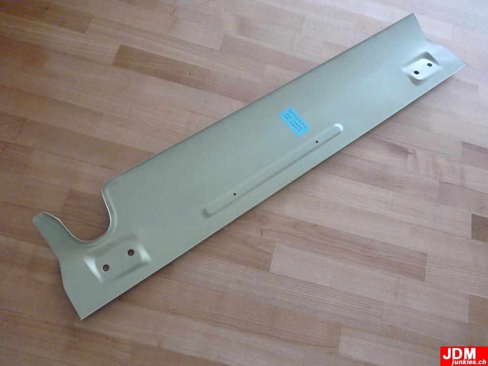

The main difference aside from that is the "lip" at the bottom end (see first picture) and the more accurate shape at the exhaust area.
Here's panel from MSA, see the differences? All a bout the details..

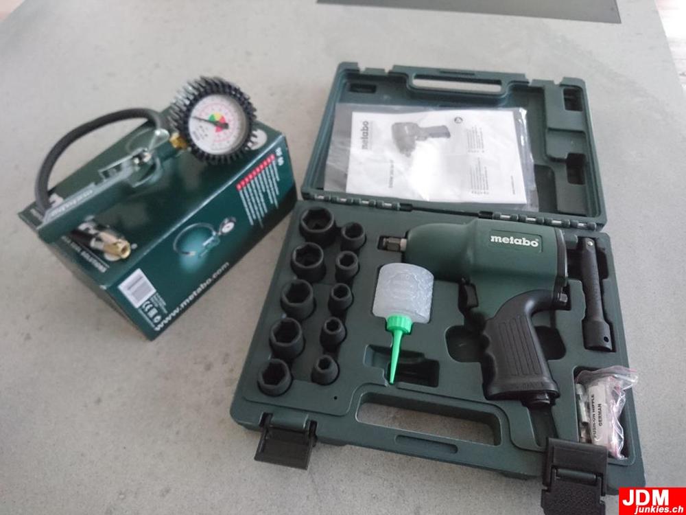

What better way to re-start a project than buying new tools? exactly ? Got myself some air tools like a rattle gun and tire filler tool with Manometer.
And a little extension  hose drum too ?

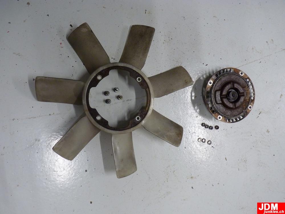

And while at it anyway i decided to remove the old fan clutch and fan blades too:
Here we go...

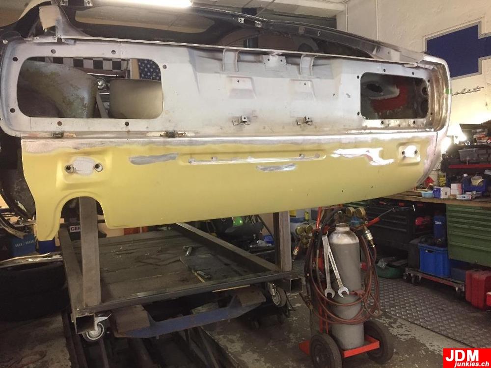

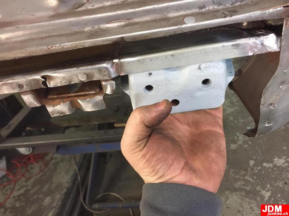

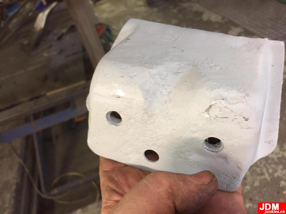

Finally, a lifsign from the bodyshop. Nothing big. but the little update came along a promise that he will contune work on the car again soon. which makes me quite a bit happy. Today he got the brackets for the rear bumper sandblasted, so i assume the plan is to get the rear valance welded back on the car soon:

Good news. My bodyshop guy is back at work with my car. First he welded back the sandblasted rea bumper mounting brackets:

Before the rear lower valance got fitted and welded back in blacke. Finally i got a rear end again. Wow ❤️ Next week the spare tire wheel well should go back in, before work on the left rear quarter starts ? This should go faster compared to the left side, since i have a complete NOS quarter panel and it doesn't have a fuel filler neck ?
