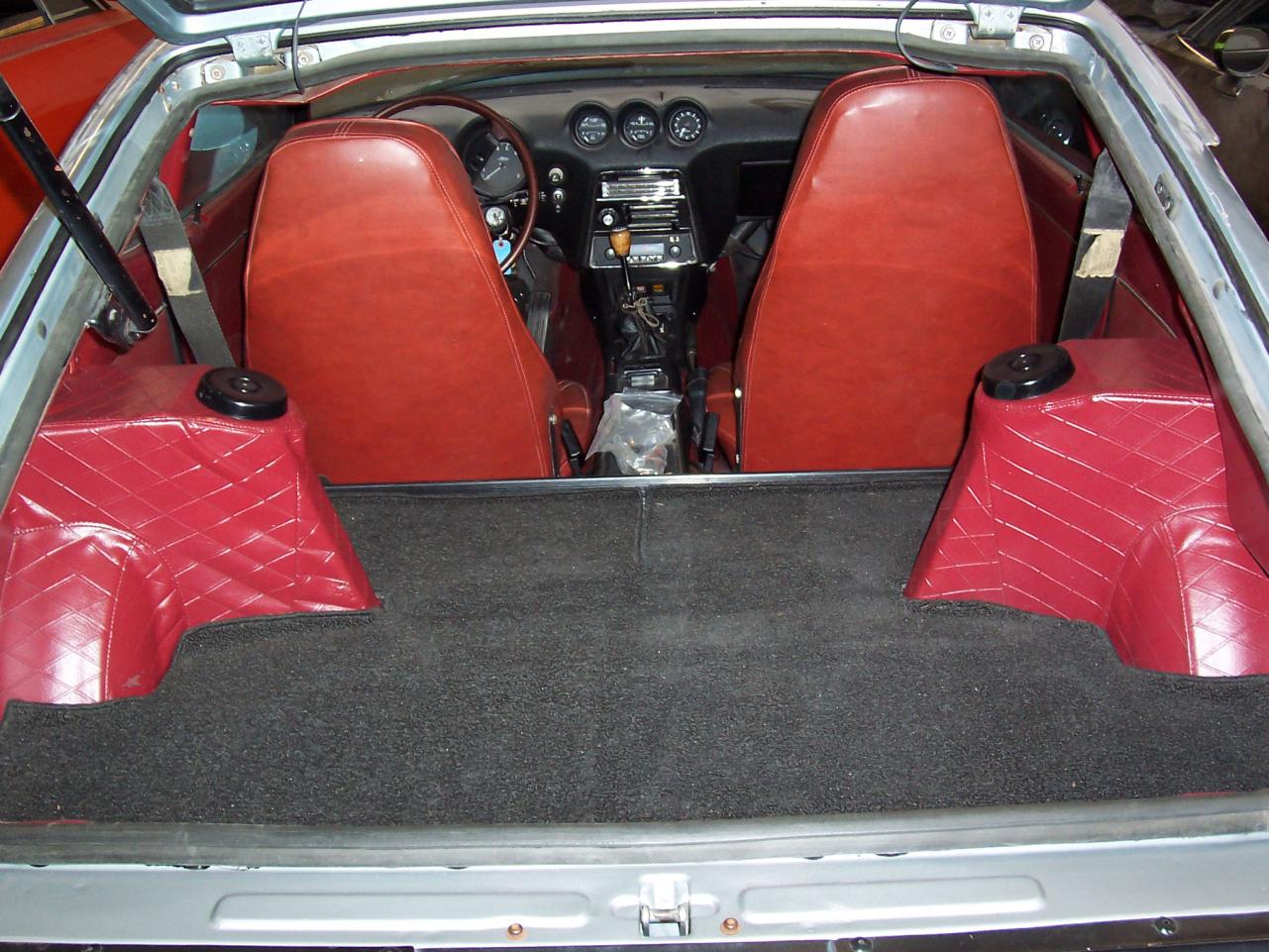

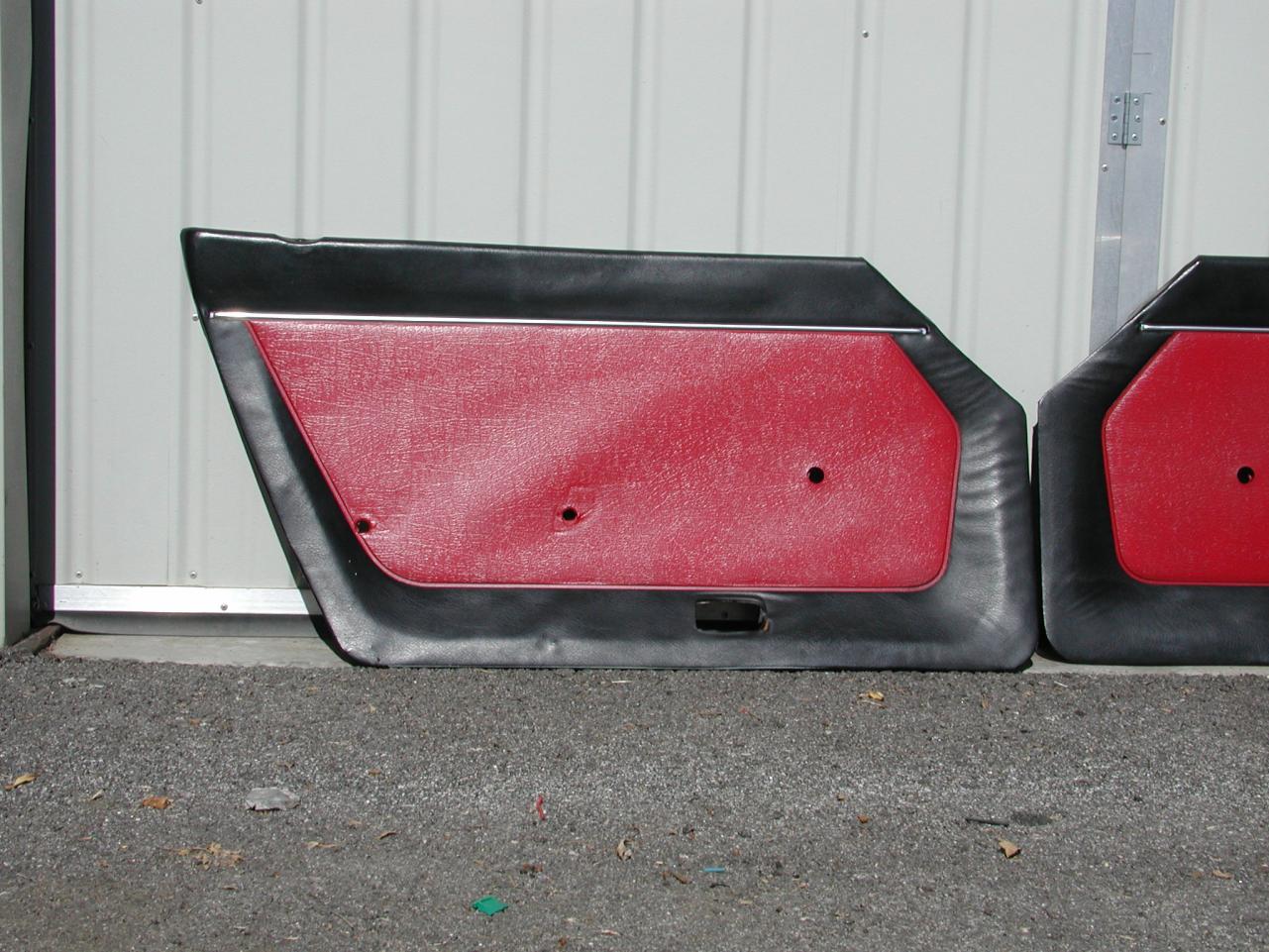

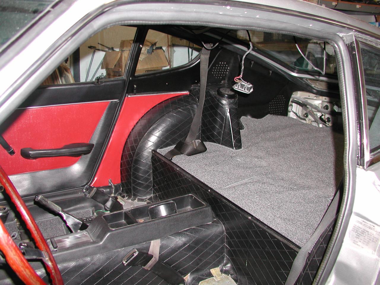

As with all painting, the work is in the prep. I used SEM on part of my door panels and was happy with the result. They sell a prep solution, but I used Acetone.
It is very important that you clean off any oil/silicone/treatment that has been rubbed onto the vinyl, or the spray paint will not stick.
I used SEM on the back seat of my 1929 Ford Roadster - be sure to use the Prep/Cleaner - use it with good ventilation. Once you apply the color you can not scrape it off - it is really a dye, not an interior paint. Highly recommend it to anybody just so you do the prep/cleaner correctly.
