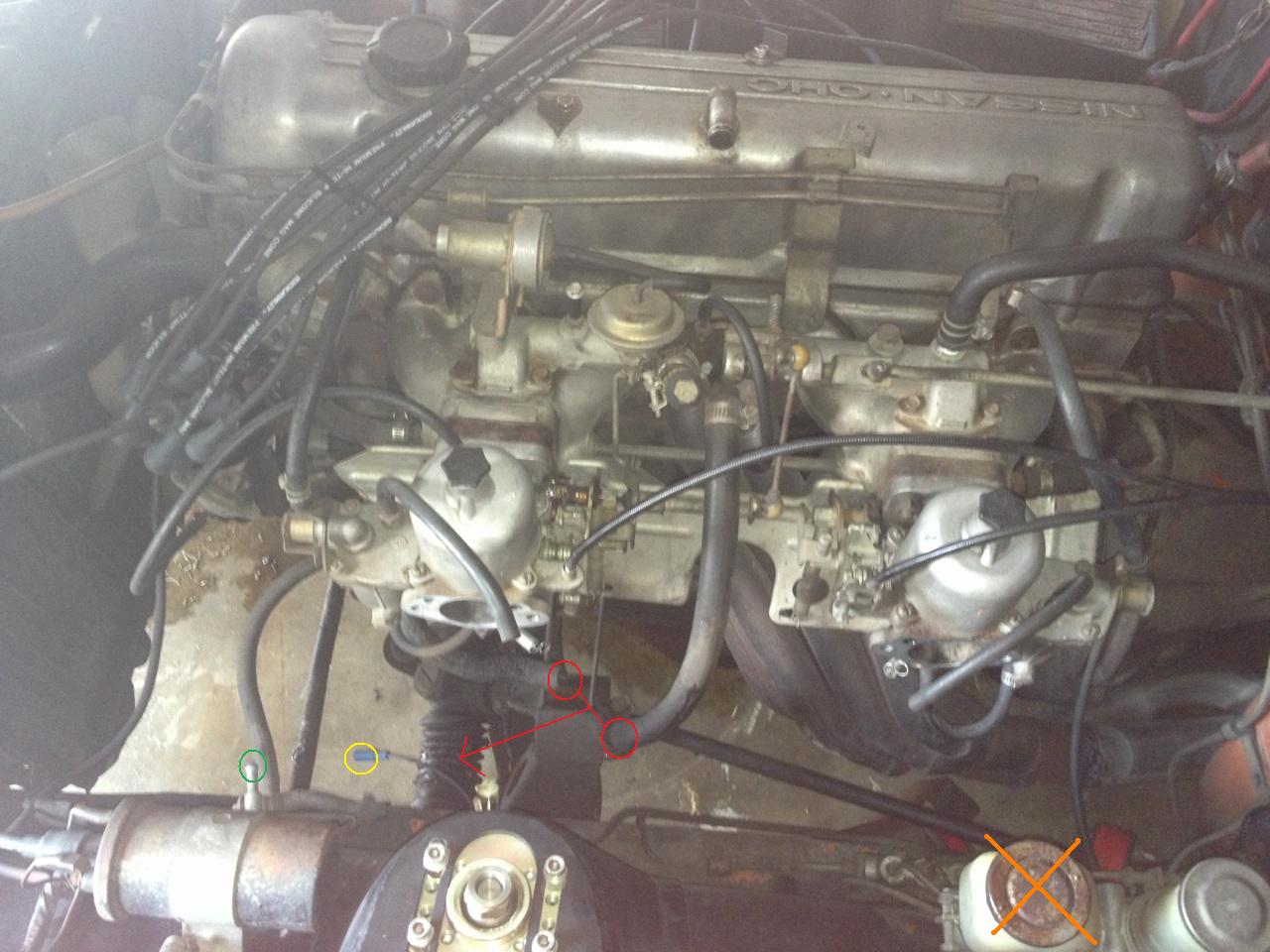

I got in the garage to start looking into possible problems and it wasn't hard to find a few quick. The battery was dead so that's at autozone being charged now. The rest are marked in the picture below.
The red circles mark a hose that broke in half. I'm guessing it's a brake line. The brakes have never been great in the car but I hope it hasn't been like this since I bought it. I guess I'll have to replace that and learn how to put brake fluid in the car. Any suggestions on type of fluid and links on how? The guy at autozone suggested going to a local hydraulic shop to get a line made to replace the current one.
The green circle is where there was a vacuum line coming from the back of the air cleaner was cracked and no longer on that metal part circled. Would this be the cause of my starting problems?
The yellow circle is just some random wire hanging and just wondering if it should be there.
The orange X marks a cap that just pulls right off. It doesn't screw on easily just pulls off. Do I need a new cap?
Also, where is the fuel line I should attach the clear fuel filter to?
Do I spray carb cleaner directly while they're still bolted on or do I have to remove them first?

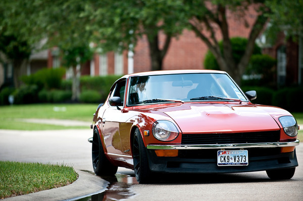

Here's a picture when I bought it. Since this picture I've raised it up a bit to make it more drivable
