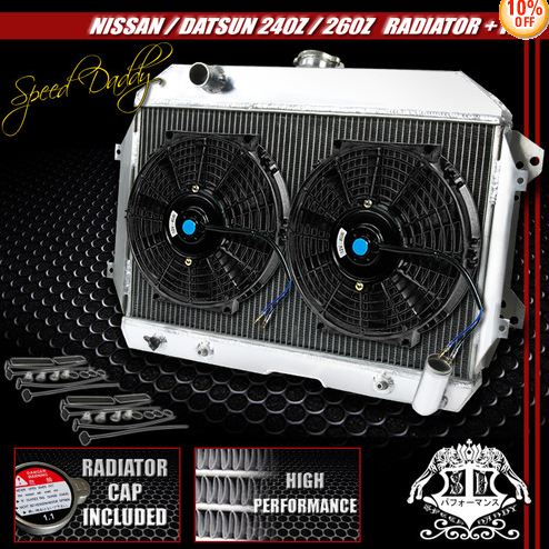

How about some installed pics? I was looking at the same model but found this one with fans that looks tempting:
http://www.ebay.com/itm/ALUMINUM-RACING-2-ROW-RADIATOR-2-X-10-BLACK-FANS-70-75-NISSAN-DATSUN-240Z-260Z-Z-/190659580127?pt=Motors_Car_Truck_Parts_Accessories&hash=item2c643250df&vxp=mtr#ht_5115wt_1397
For archival purposes:
[ATTACH=CONFIG]56292[/ATTACH]
Well I did the am visual inspection all good.......................Kurbycar32 that rad looks nice ,as for the fans keep an eye on them ,as the life span on them is short,on my Z a GM source fan assembly fits nice with minor mods. Top picture as requested........;)
