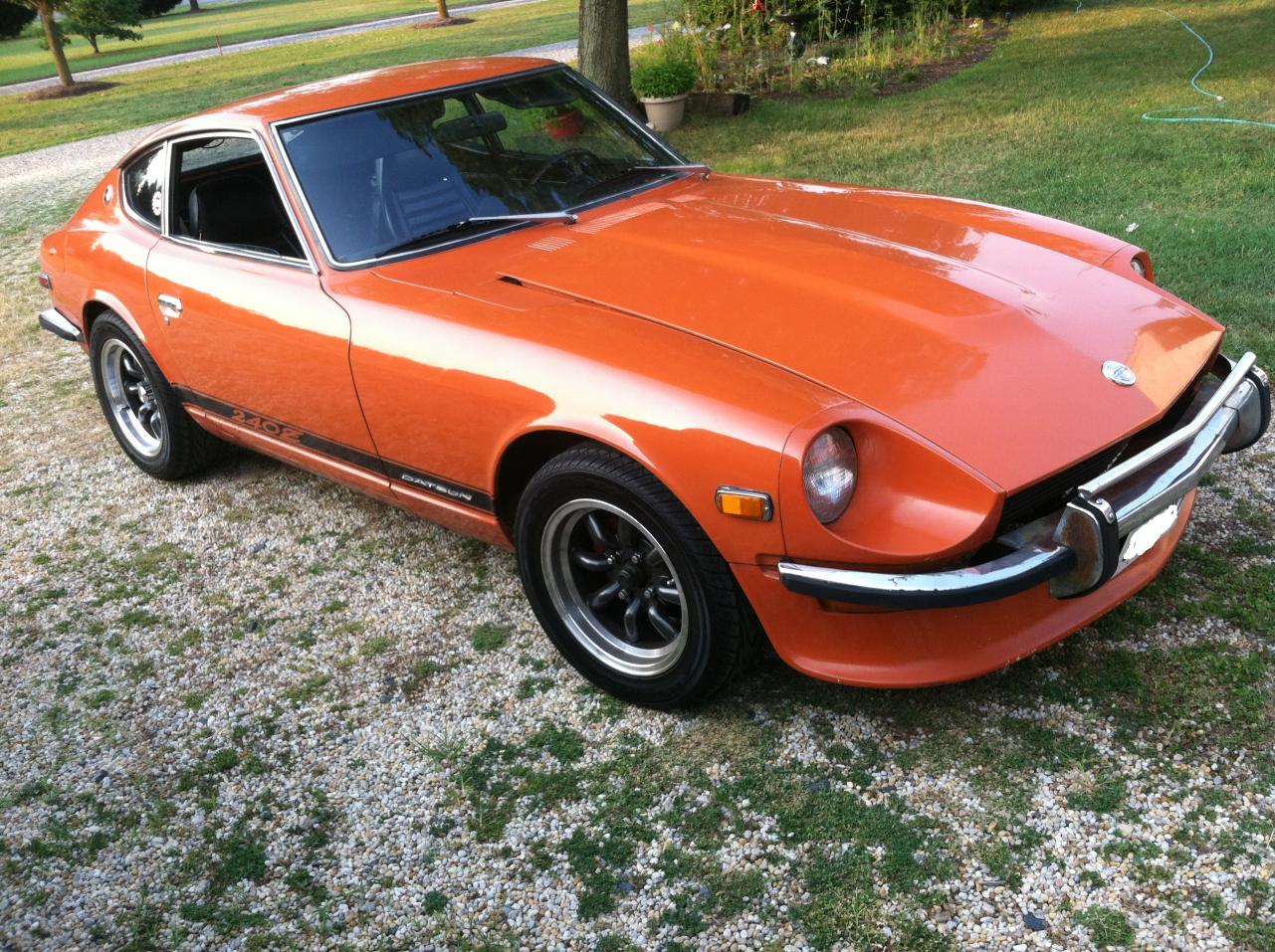

So my car is partially apart, engine bay is clean, working on disassembly and clean, powdercoat of suspension components. My engine is getting there little by little. Should be a nice car when its done. I bought it, drove it a bit with the L28 that was installed with round top SU's. I just don't like it as much so i'm going with an L28ET and i'll keep the good L28 as a spare for when my other Z's L24 finally retires. I've got eibach springs, new struts, poly bushings all around, MSA sway bars ready. Should ride pretty good, this one has a 5 speed tranny too.

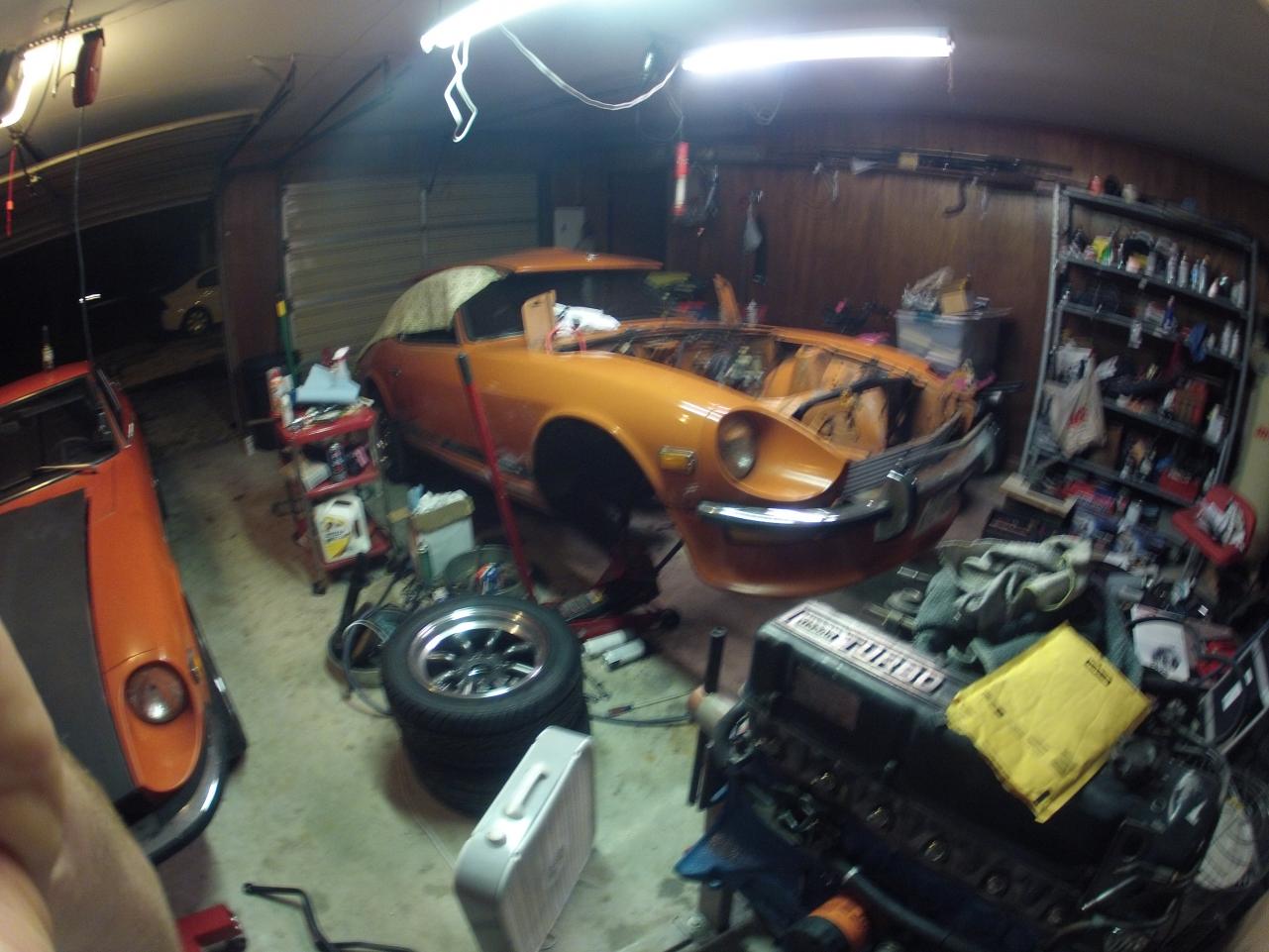

LOL its a mess man. I have tools and parts everywhere and its crowded. But hey its out of the rain i got my compressor hooked up so its on. I have all the parts sourced it should be an exciting ride when its done. The pictures look fish eye but its my new Hero2 GoPro i love it. I'll keep you guys posted, this L28ET was purchased from a guy on the forums, and many odd ball parts i've sourced through the ads too. I love these cars. This past weekend a buddy came down, he's got an LS1 powered Z and its given me even more motivation to go. Thanks for looking. Suspension is underway, i'll post pics of the progress.

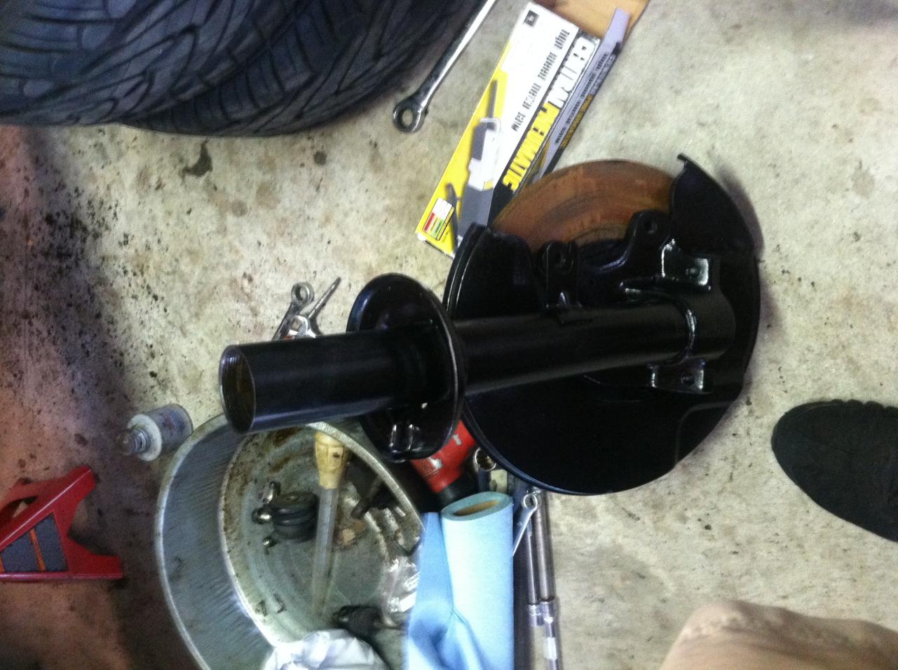

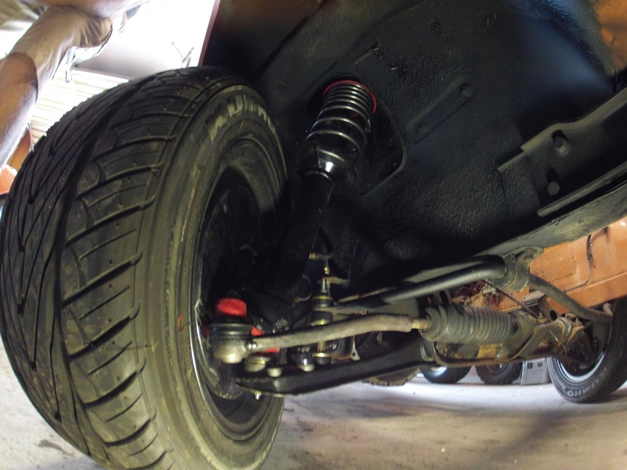

Front passenger side suspension is done, all NEW, should ride good when its all done. Eibachs and just KYB's with stock mounting hats. I have new tie rod ends but i'll put them on when i'm ready to realign the car. I've got a long way to go before that.

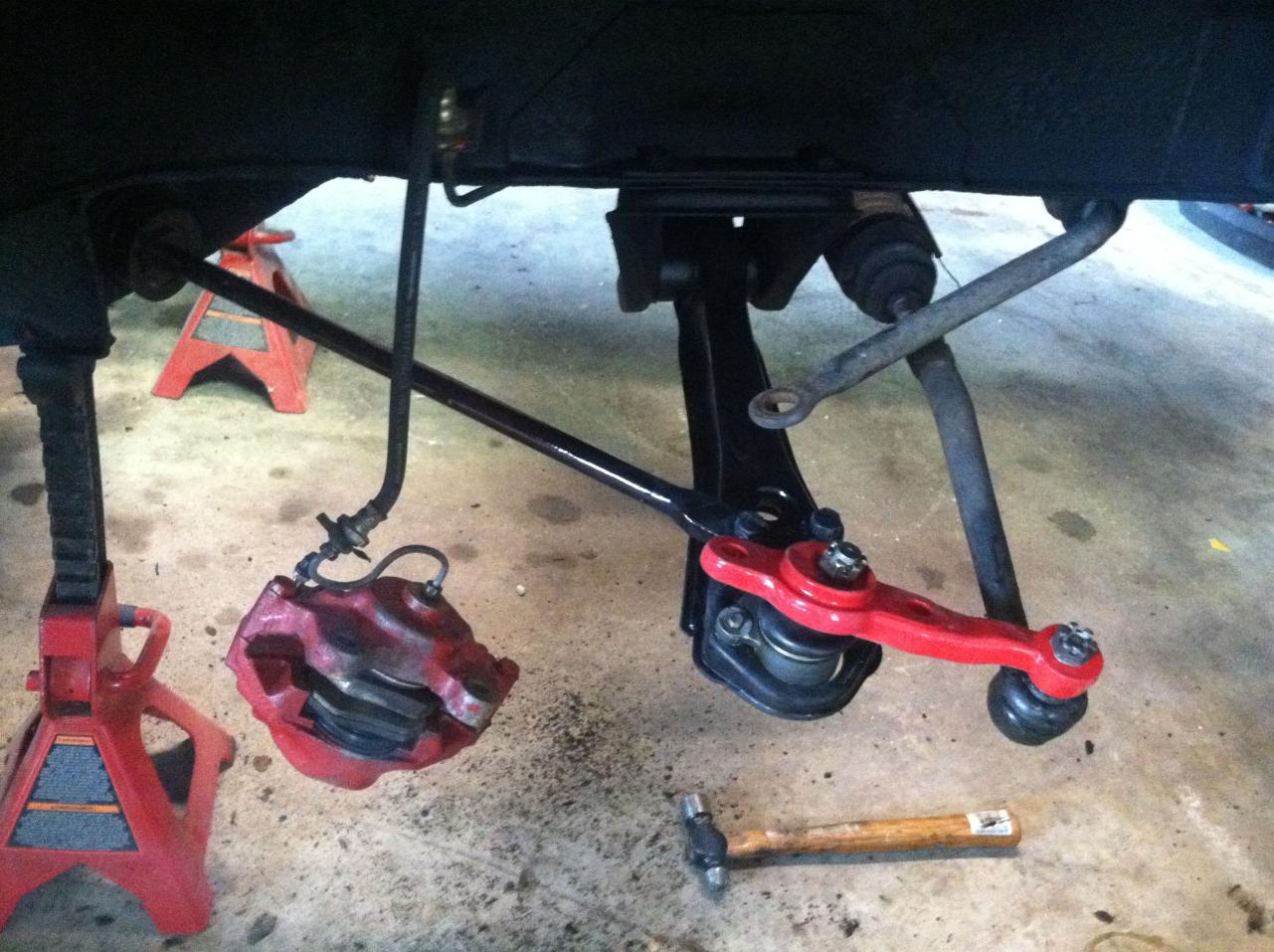

I did them in red, not sure if it matters no one will see it but me...well and i guess you guys now. ;) I've got new brakes i'm just not there yet. Those calipers are newer but i want the toyota pick up truck brakes.

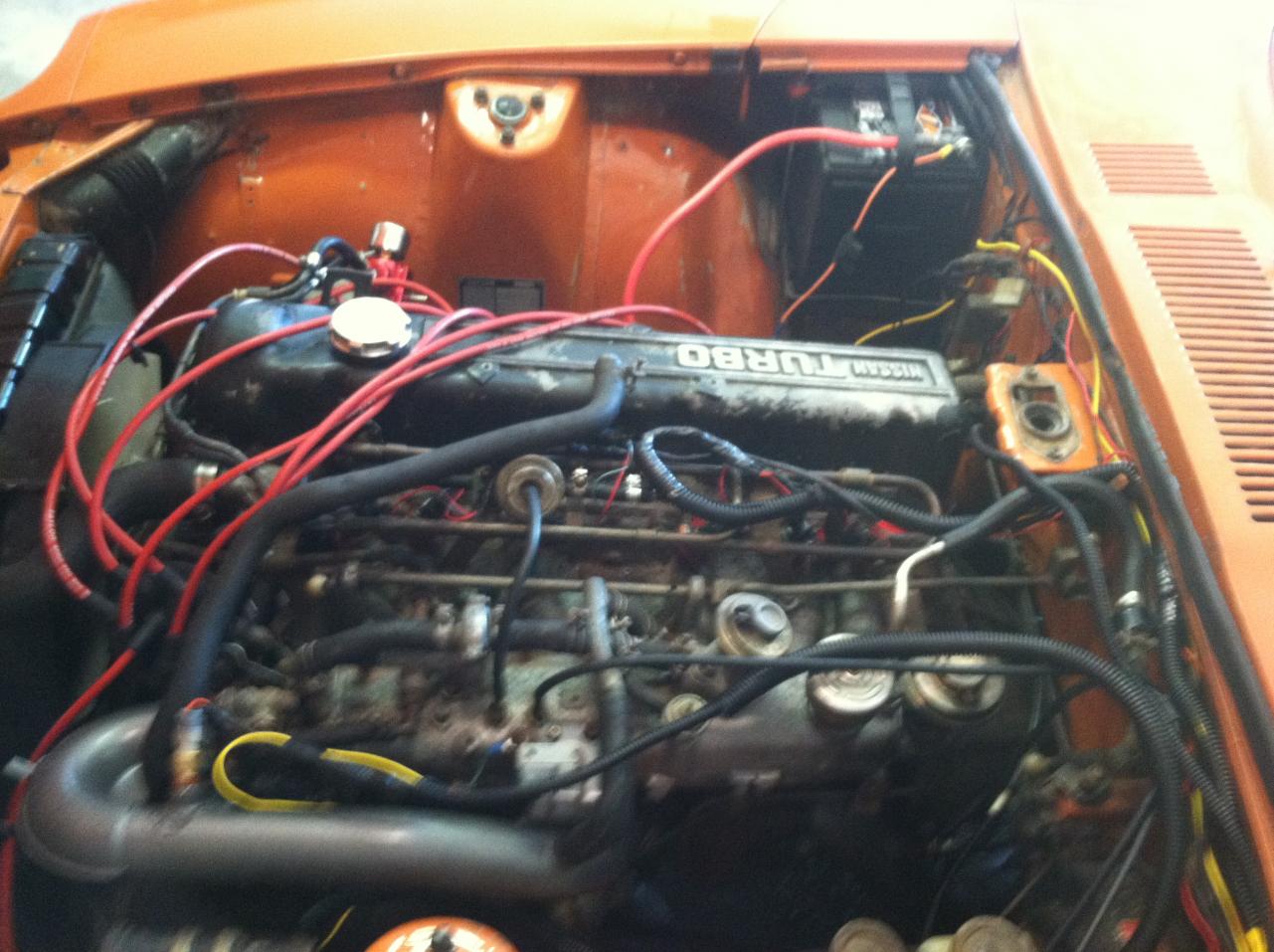

Suspension up front is complete. Eibach springs and KYB's for now. If I don't like them i'll put them on the other car.
280z fuel tank installed
New fuel lines ran
New pump installed GLS392 Walbro
L28 turbo clutch, pressure plate, and flywheel installed
L28ET is in
Megasquirt relay board is wired.
240sx TPS installed

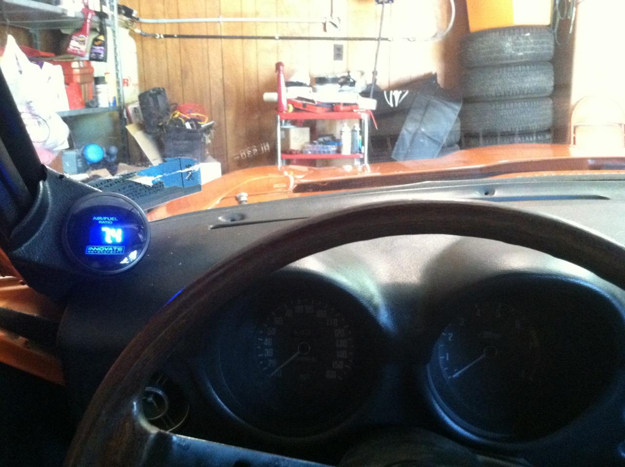

Innovate LC-1 installed and hodge podge A-pillar mount installed
MSA downpipe installed.
I'm waiting on my Megasquirt II to get back to me. I had an issue with it initially and the injector bank 1 was constantly grounded. I got an email today that said it will be on its way to me tomorrow so maybe i'll see it by Saturday if i'm really lucky but looks more like Monday. Either way Matt has been very good about everything and appears it was covered by warranty so i'm very thankful for that because this build has gone WAAAY over budget as usual.

Getting even closer to driving. Its running again :) Exhaust is getting welded up today. Now just to tune and button up a few things. The pictures above show where I had buttoned up the wiring and tucked it nice. Bad mistake, I had to end up unwrapping everything to change a few things around but its back together now. Wiring is all over the place in the video.

Are the springs slightly shorter?
Forget the truck brakes, get some Wildwoods for the front and don't look back. Just leave the stock drums on the rear.
