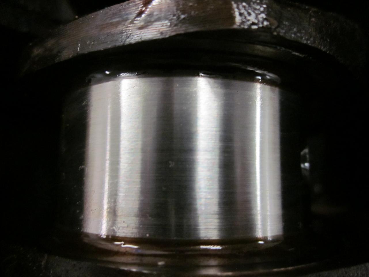

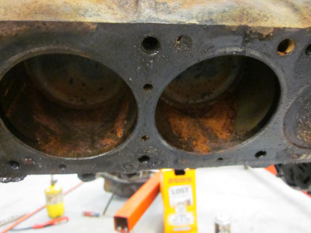

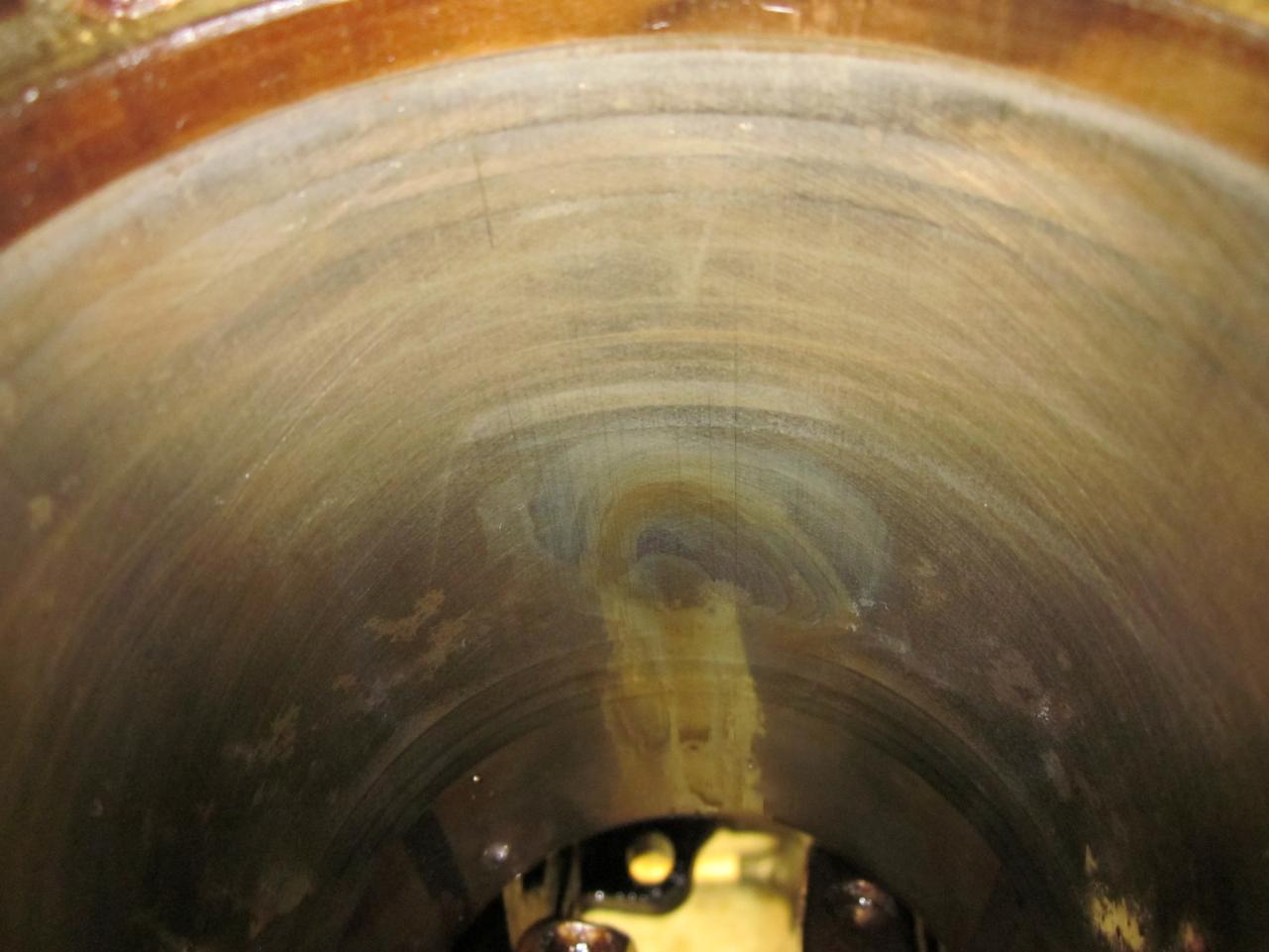

Still have some cross hatching in the cylinder bores,post-21670-141508198746_thumb.jpg Not sure I will get away with just a hone.

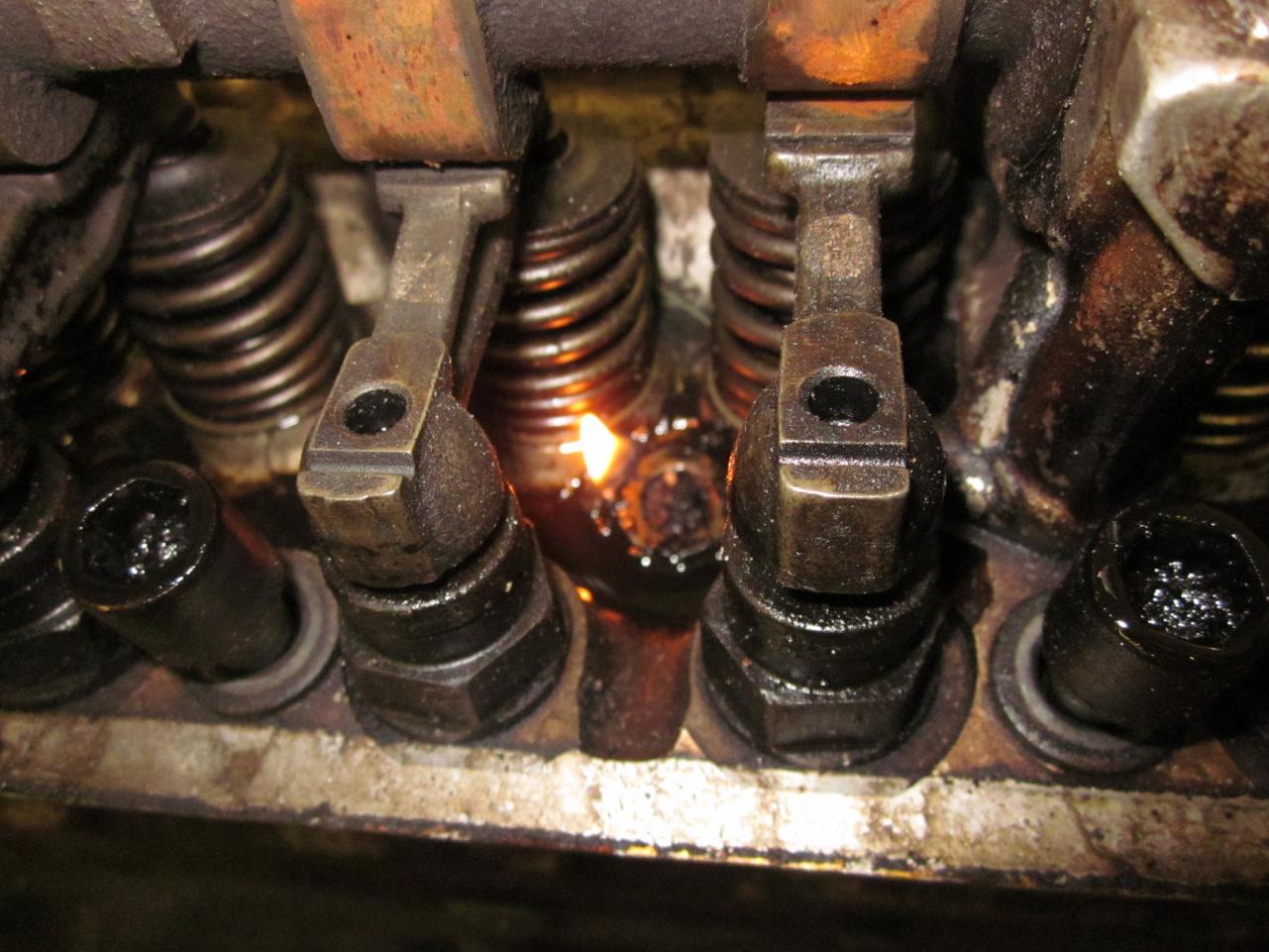

I am doing a swap from the hard to find hydraulic lifter set up to the traditional lash adjuster style. I am going to have the machine shop handle the head work. I hope to minimize milling on the head as not to distort tolerances between the good used stock cam I am using and the lash pads etc. Here are some random pictures. post-21670-14150819876969_thumb.jpg
