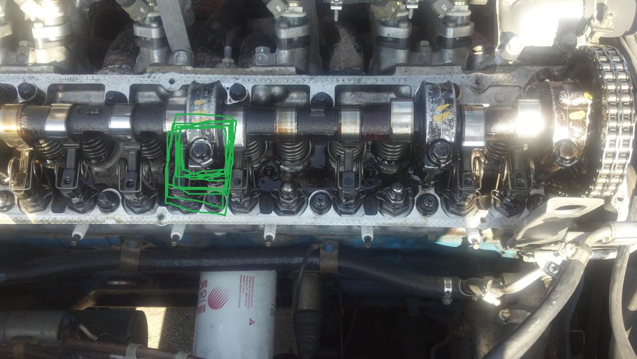

ok this cam tower bolt is broken and i have ran it with no problem just not on the road or over 2500. i know these are more for alignment the anythig so is it ok to run it as is or should i have this nasty thing removed. im getting out of the army and running short on time and tools. i might have a long trip to ohio in the near coming winter.post-23901-14150819742667_thumb.jpg
If the cam tower is cracked under the bolt, it looks like the one to the right is also cracked too. I can't discern so please explain problem in more detail so that we can advise.
Ok the cam tower bolt is broken at the base of the tower there but no crack
Its just bad lighting in the picture but the bolt is broken off just at the base of the tower if what you read is messed up I'm doing this at work on my phone
So if the bolt is broken at the base wouldn't that allow it to turn or twist slightly? And wouldn't that bind the cam? Or wear out the bearing? I'm just guessing as usual.
I would fix it but you need to make sure no burrs would go into your engine during the operation.
The load to push the valves down are counteracted by the towers so there're definitely loads going thru those parts.
