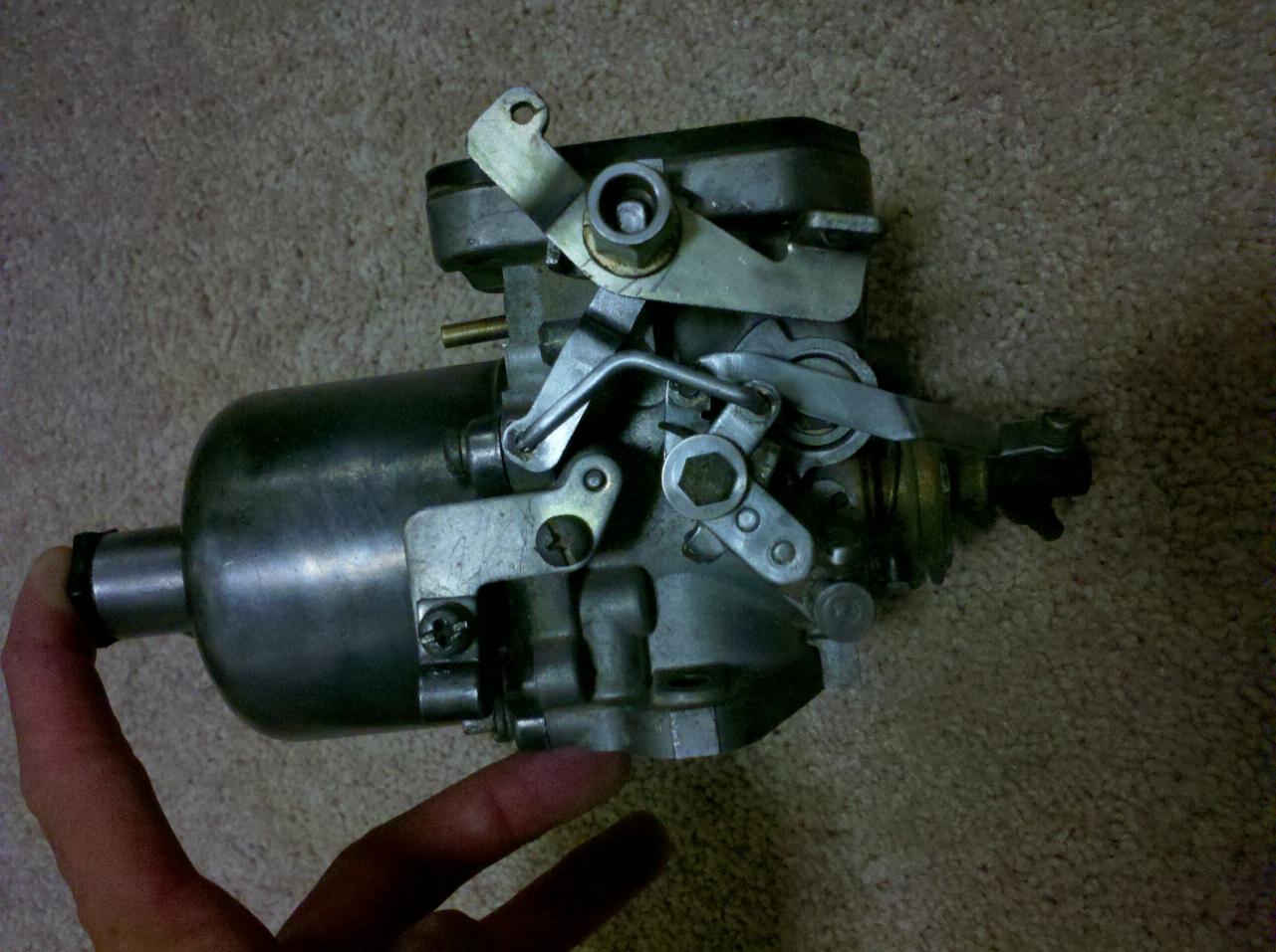

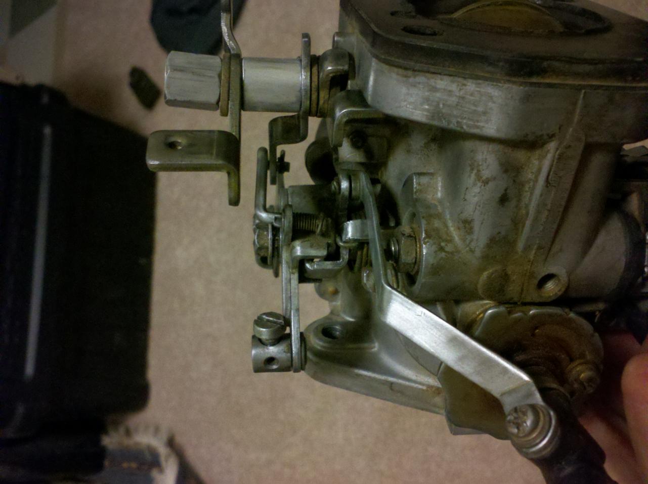

Hey Carl, do you have any good pictures of how the linkages on the carbs should look? When I cleaned them up, I left one assembled so I would be able to compare them as I reassembled. I'll post up a picture of how mine looks. It just seems like something is off. When I move the throttle linkage it does not appear that anything is moving on the carb.
Ok here are the pictures. I disassembled one at a time cleaned it up as best as i could and reassembled using the other as a mirror image to make sure it is all together properly. Does this look right?
Thanks Tamo. While I'm not sure mine was exactly the same since I noticed a few small differences, It still confrimed what i suspected and I was able to get it working pretty smoothly. Now that I feel comfortable that they are working properly, I can finally get them on the car. They are the only thing keeping it from being started at this point
