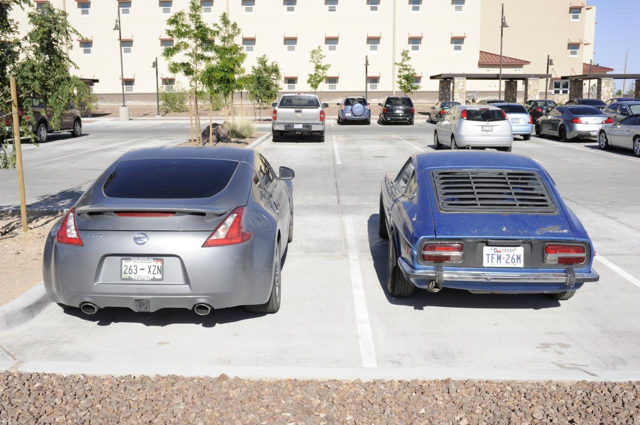

Found a little project for today. I knew there was a rear window louvre in the back of the car. and the one that was installed was in fairly poor shape. So I pull out the box in the car and it was a brand new interpart louvre with everything still in the original packaging. The box looks old as dirt and is about to fall apart so i figured I'll get the new piece installed. I'll take some crappy before and after pics with my phone.

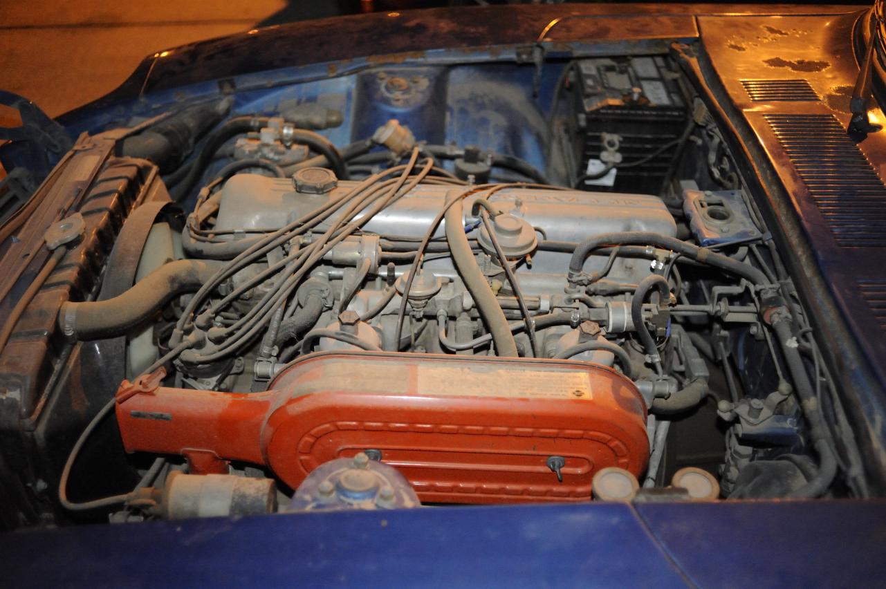

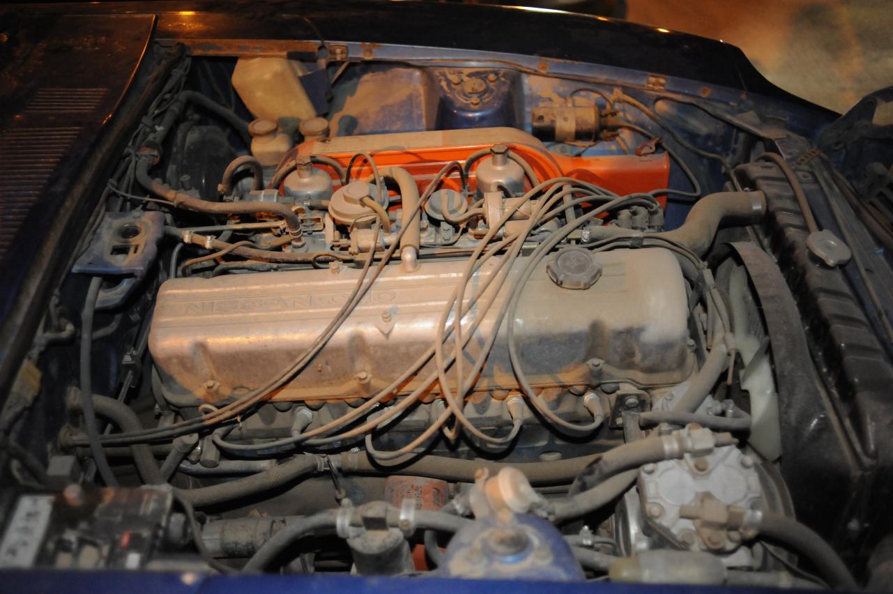

Pictures as promised, I'll try to get some better ones during the day tomorrow, I didn't get home from shooting until it was dark. I have planned on using some mechanical gauges. One of the things i did plan on using modern tech for is the ignition system. I've talked with MSD and think I have a setup figured out, but I'm wondering is there a way to convert to a modern distributor and get rid of the points or is it reliable enough when properly cared for?

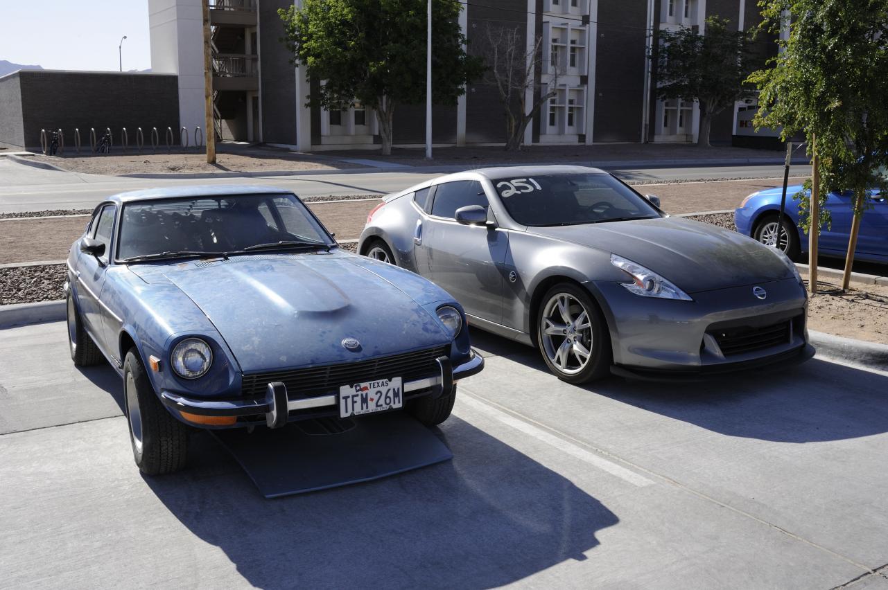

And some pics from the other day sitting next to my 370:
