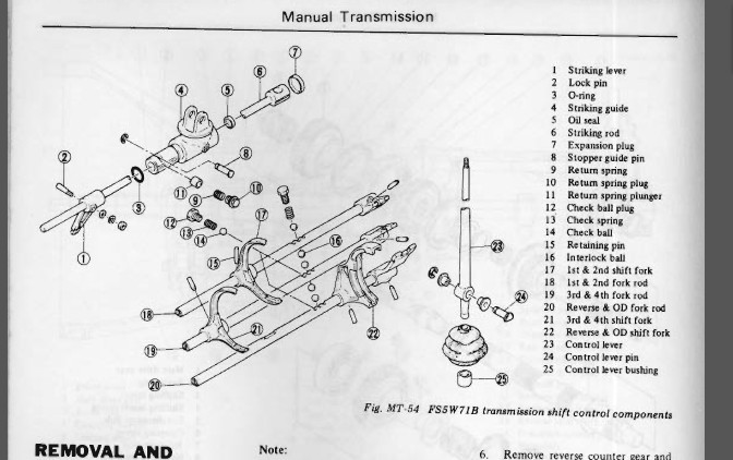

I've read the 5th gear shift fork is weak on the 5 speeds since it was designed in as an add-on to the 4 speed. You might have a broken fork keeping 5th from engaging completely. It's shared with reverse so reverse might be affected also.
That would actually be a pretty easy fix, since 5th gear is in the tail shaft housing. If you have the time to keep the car down, maybe pull the transmission and take the housing off to see.
I attached a picture from the 1978 FSM. The ball bearings shown are in the adapter plate which is between the main gear case and the tail shaft housing. You can see that the 5th (OD) and reverse shift fork is essentially half of a full fork.

Thanx Zed, I plan on pulling the tranny this week and since this is not my daily driver and has been down for about a year a little longer won't matter. Another question; I've read a couple of posts regarding the shift lever, the one I'm using is from a 75 4 speed and doesn't look like the one in the diagram, does that matter?
It shouldn't matter. I am using my 76 4 speed lever on my 1980 5 speed. The 71B transmission cases, which yours and my (mine?) 4 speeds came with, and which was used in both 4 and 5 speeds up to 1983, all have the shifter attachment in the same location.
